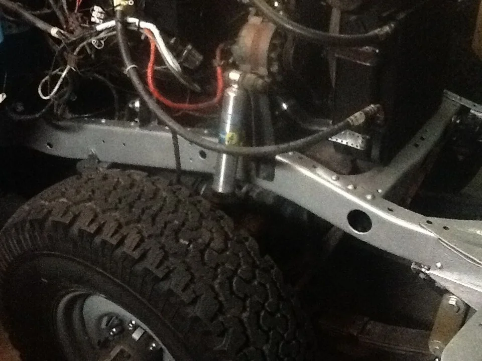

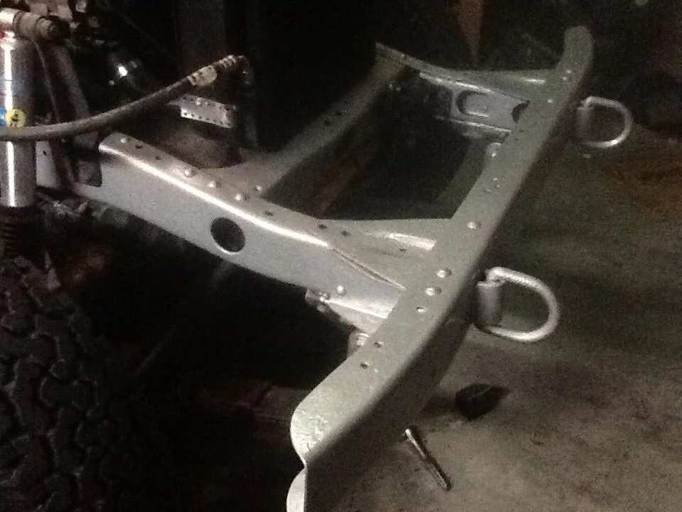

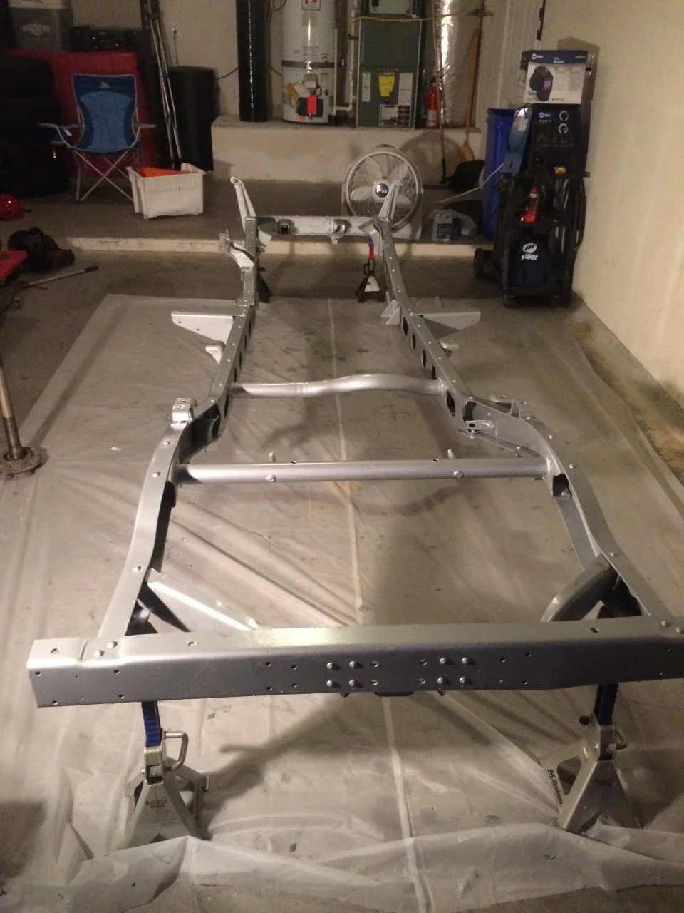

Hadn't seen any pics so here's a few shots of my frame coated with rust bullet. I was going to paint over the rust bullet with chassis coat black but I really got to liken the silver look of the chassis. Another side benefit is if I do have rust in the future and it starts bleeding ill be able to see it and catch it quickly. It's been hard for me to see how bad rust is when the frame is black. Goes on ok, did the poor mans frame resto on the truck with a harbor freight paint brush.
Chose rust bullet based on cost, prep time and relative durability I found. I think POR is a little more durable, but not worth the prep and money for me. Enjoy!

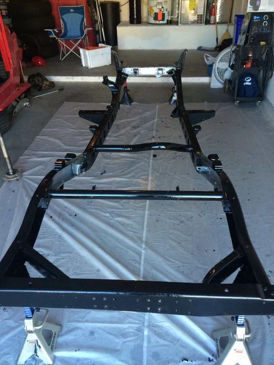

I used Rust Bullet. Really good in my opinion and I have used POR before. I liked RB better and their customer service is top notch. I screwed up and they sent me another qt for free because they wanted me to have good results with their product. Here are a couple of pics of the frame with RB and black top coat.
