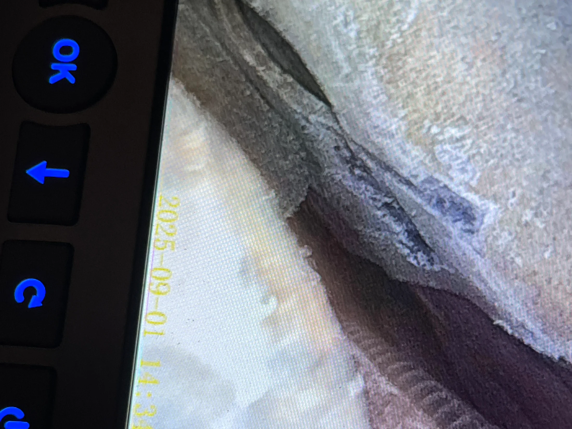

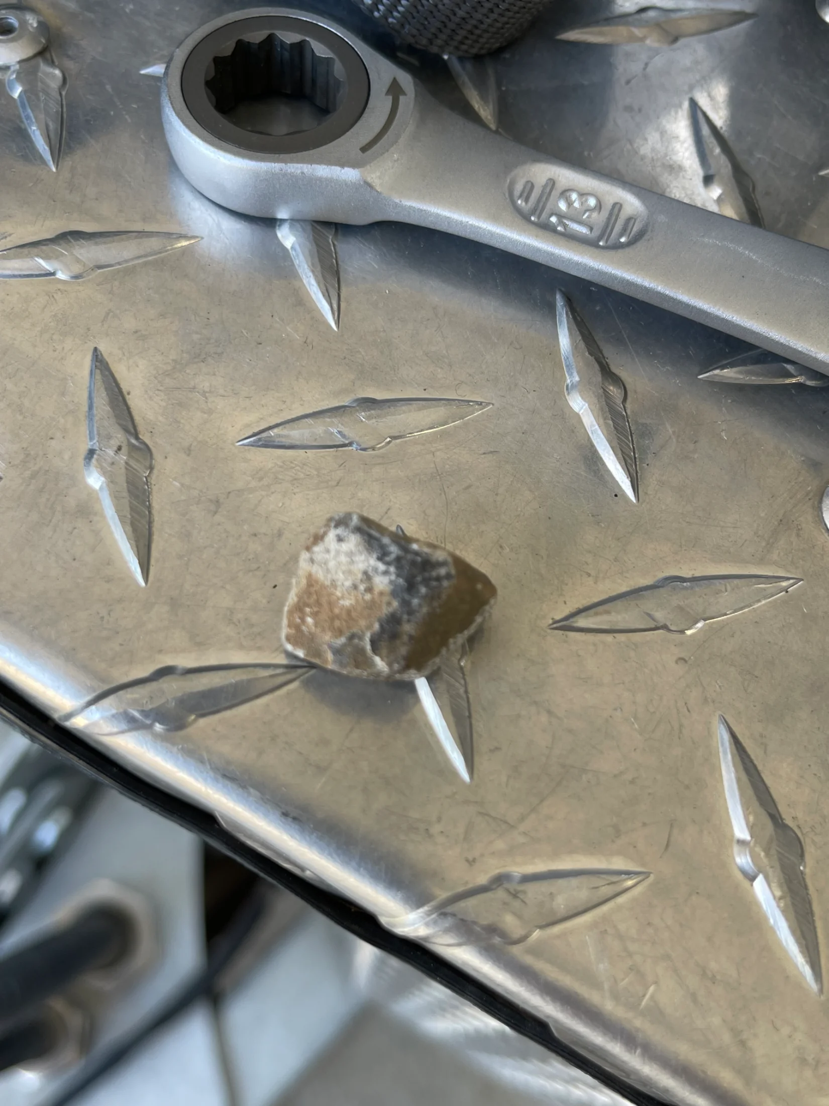

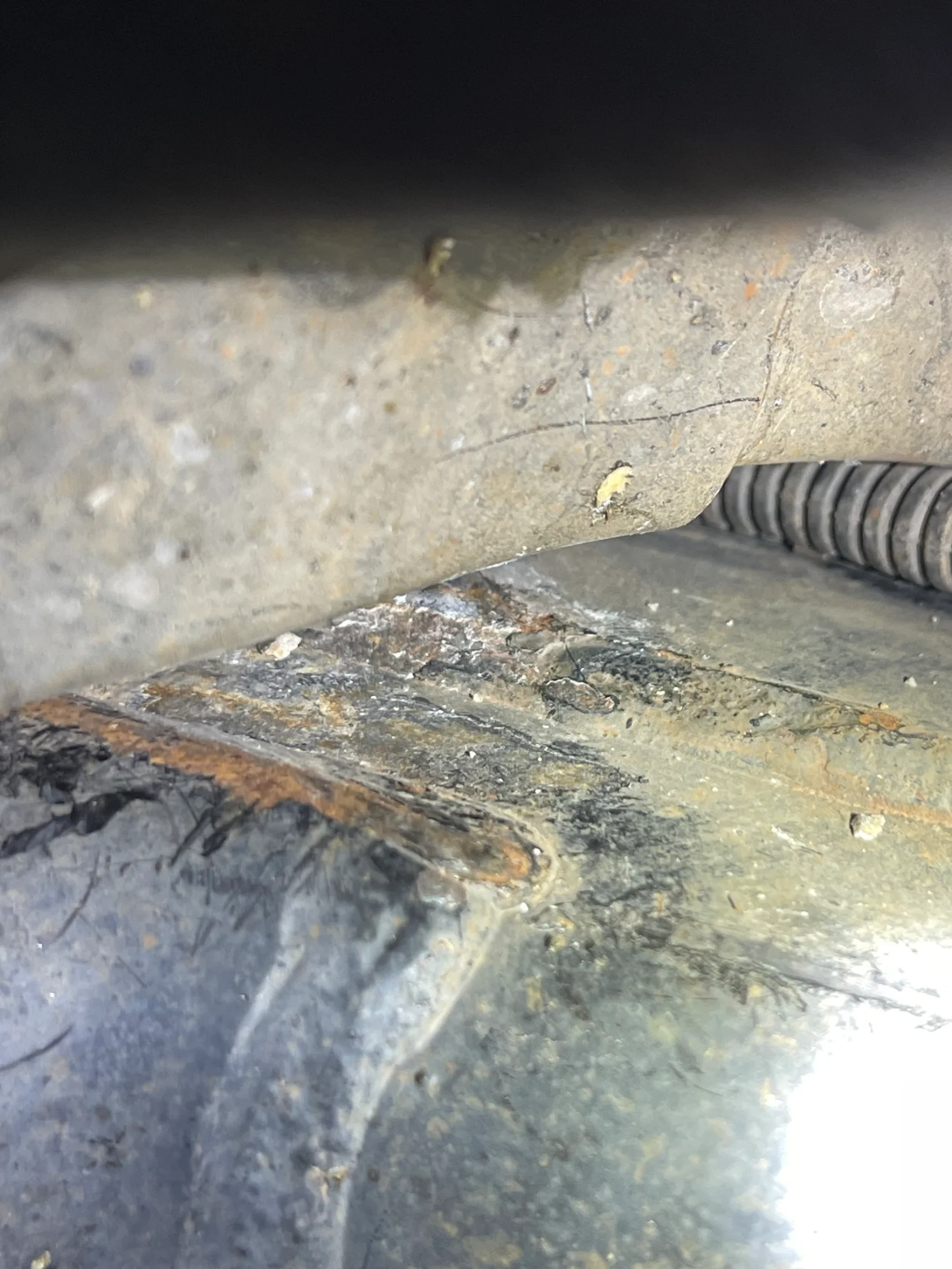

I had the chassis ears on the components mentioned above and I swerved hard left and right and could not replicate the noise. However, it did make it again when I turned into my neighborhood and then again when I ran over some root damaged asphalt. Hopefully, this section of road will cause it to make the noise reliably and I can do more testing. It sounds like it’s coming from the passenger footwell or door pocket. Nothing in either place. I went so far as to take any pieces of gravel I could find in my sliders and looked in nooks and crannies with a bore scope. Nothing obvious.
