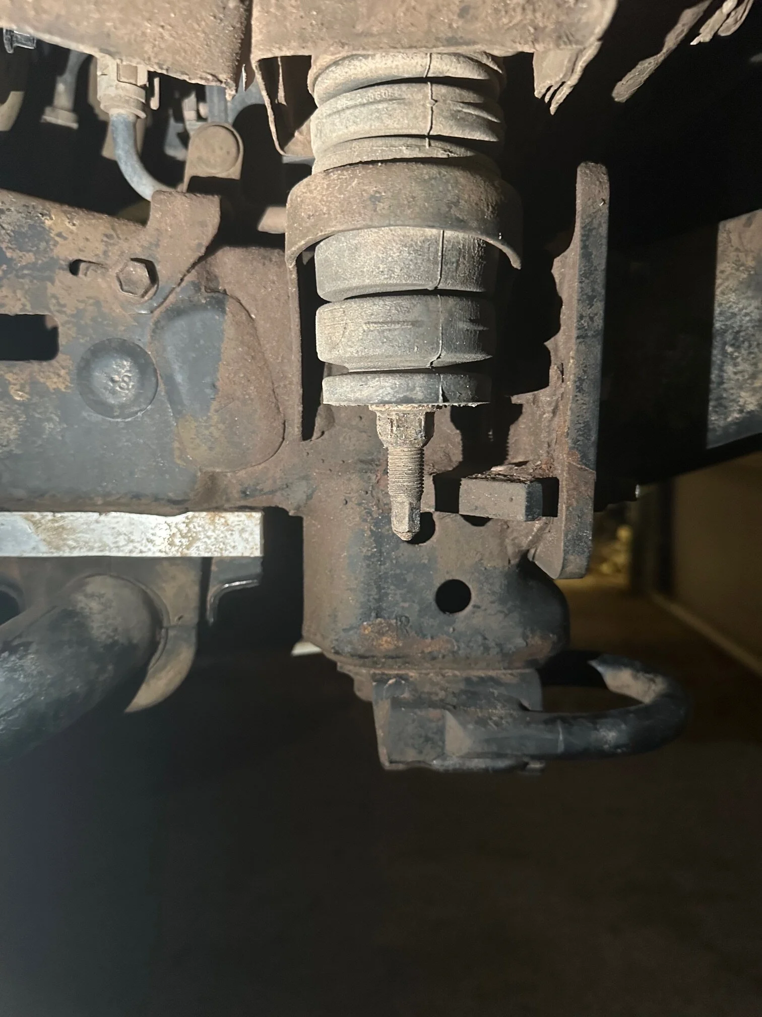

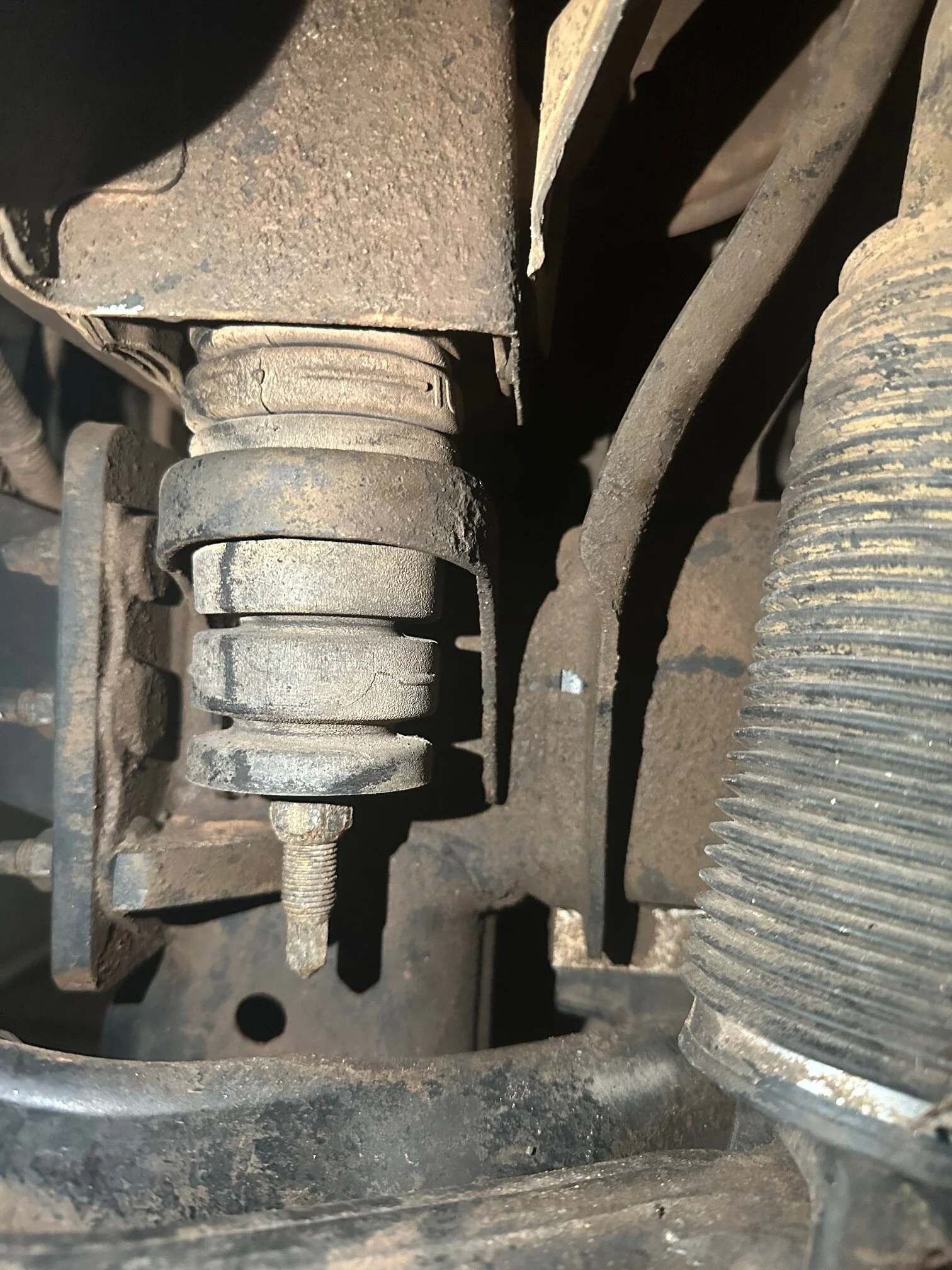

With developing what seems like noises from other areas, the body mounts are smelling more and more suspicious to me. I’m hoping it’s easy enough to swap the front two once I get the parts and get into it. I assume the rearmost ones are going to be under my drawer and fridge platform though

Take pics of your front body mounts. I’d be curious if your are collapsed too. If I jack up the front of the vehicle on the frame just behind the second body mount the front one will extend, which is how I am positive it’s collapsed.

Maybe. It's actually possible to replace the rearmost body mounts without accessing the interior at all. With a minor caveat that the body interior access cap will be popped off.
What I mean is that you can undo the body mount bolt from below. Push the bolt up (popping off the cap), and remove / replace the upper body mount. Then the bolt will fall down down through the mounts. So everything done from below. But again, you'll need to get access behind the interior panels to pop that access cap back in which probably is not hugely important.
A concern would be that if one is collapsed that would increase the strain on other mounts as the body tilted that direction. Possibly making the new mount fail more quickly.

Yeah I’ve had that thought. I’m actually wondering if that why other mounts have started making noise… once the body starts moving a bit they all end up stressed? At this point I’ve only ordered the front two upper mounts because a couple weeks ago I wasn’t sure this was the issue and I wasn’t going to drop the $ on replacing everything, but I’ve become more obsessed with the idea this is my problem. There’s also a chance I’m insane, but given the dealer, an Indy mechanic, and a pro alignment and suspension shop have looked over and tightened everything *and* I’m now regularly getting the same noises from the rear I can’t come up with any other explanation.
Partsouq cost is about $60 per mount set with new bolts and sleeves IIRC, so around $500. I assume the dealer will be quite a bit more. Hoping for another Toyota sale. If I can do this in a few hours I’ll do it myself, but if it’s going to be a PITFA to do in my garage by myself then I’ll find a shop to do this as it’s annoying AF

I've been noodling on why your front mounts are collapsed too. Doing a body lift recently, I was considering replacing all the mounts. My set at 168k looked pretty good, even after tons of washboards off-road and lots of towing. I didn't bother changing them though now I wished perhaps I had...while I was in there?

I've been noodling on why your front mounts are collapsed too. Doing a body lift recently, I was considering replacing all the mounts. My set at 168k looked pretty good so I didn't bother changing them though now I wished perhaps I had...while I was in there?
