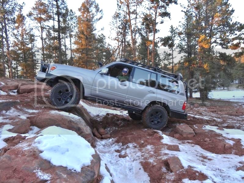

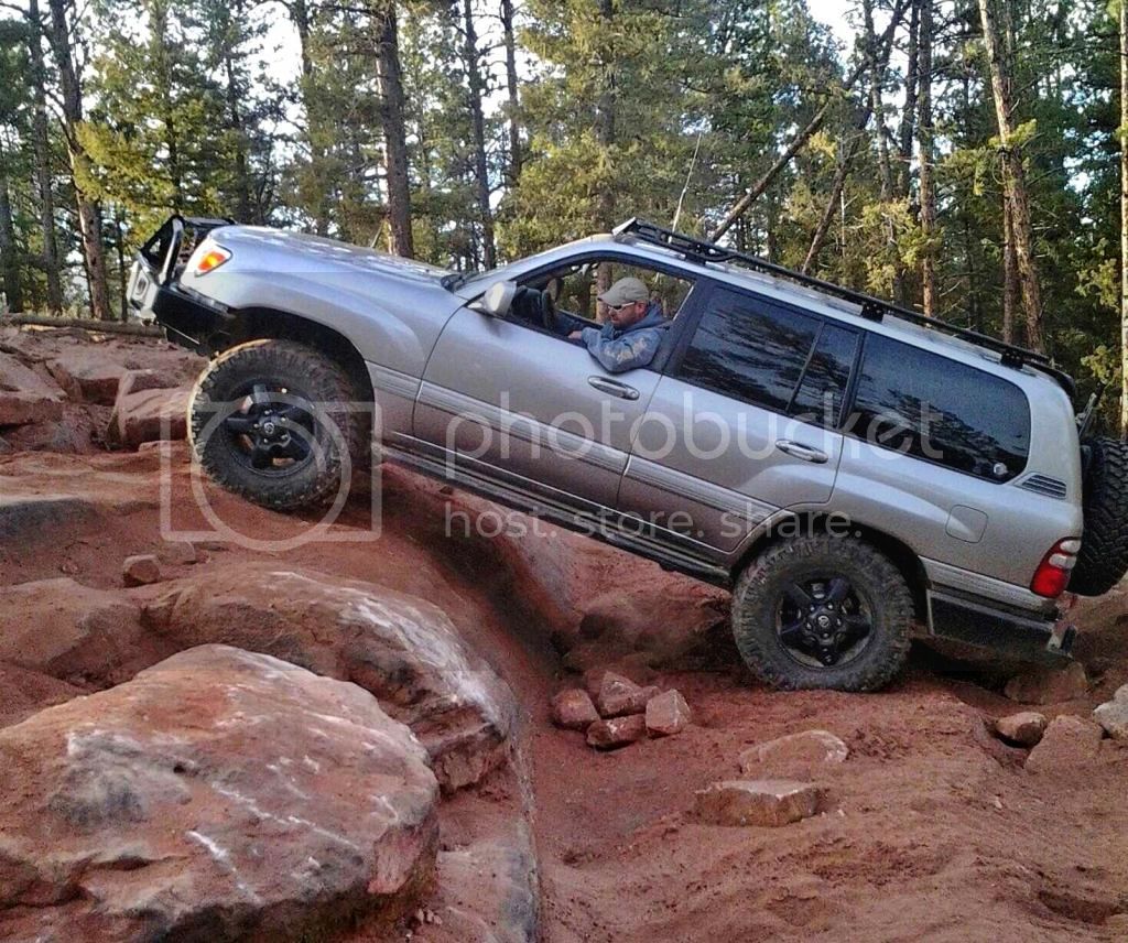

A pic comparison 35's (first pic) and 33's (second pic) Same trail, same spot. MtnAddict has 33's with the 18" Tundra rims. I have *almost* 35's on LC wheels. Can hardly tell the difference looks-wise. The 33's on Tundras almost look bigger.
paflytyer
MtnAddict
