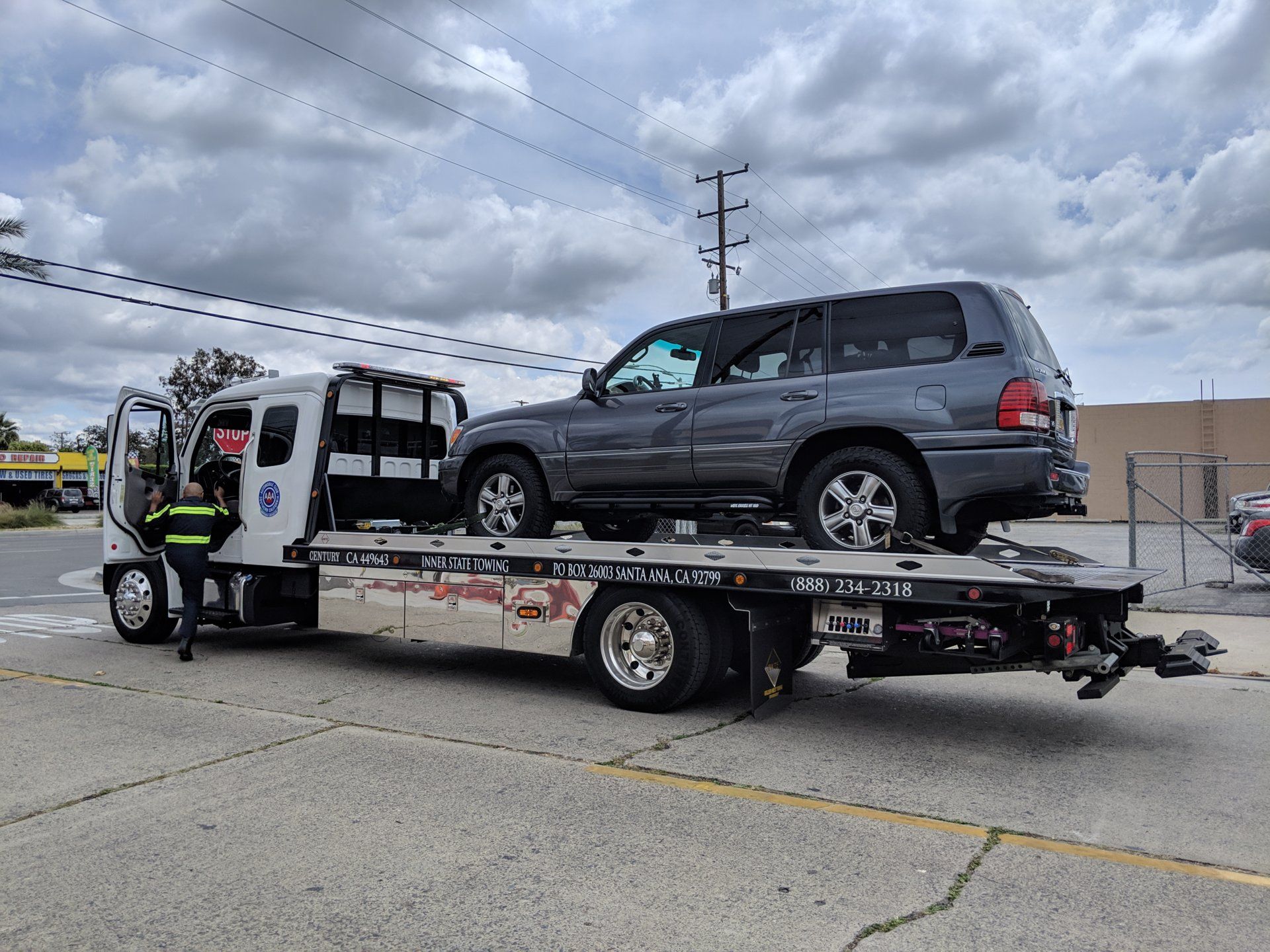

Total brake failure happened today, 2006 LX470 with 175k miles. Luckily it was just in a parking lot, but we were fully loaded ready to go camping. Good thing you didn't happen 4 hours later or we would have been a LONG way from help.
So glade everyone is okay. Fortunately that always seems the case!
Total brake failure happened today, 2006 LX470 with 175k miles. Luckily it was just in a parking lot, but we were fully loaded ready to go camping. Good thing you didn't happen 4 hours later or we would have been a LONG way from help.View attachment 1945543
