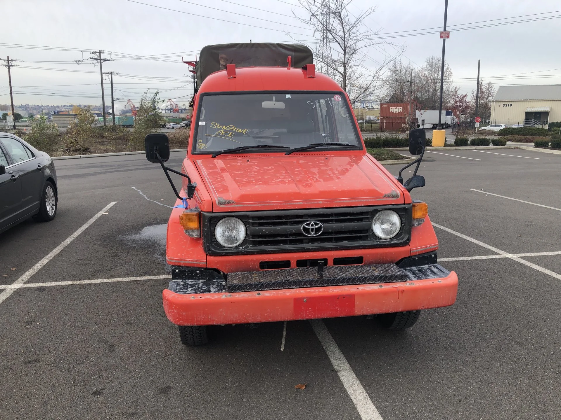

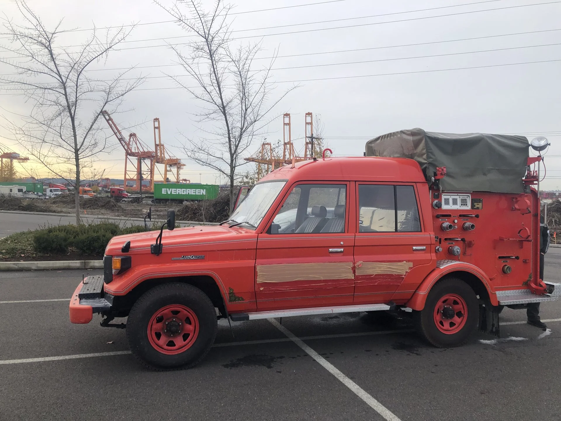

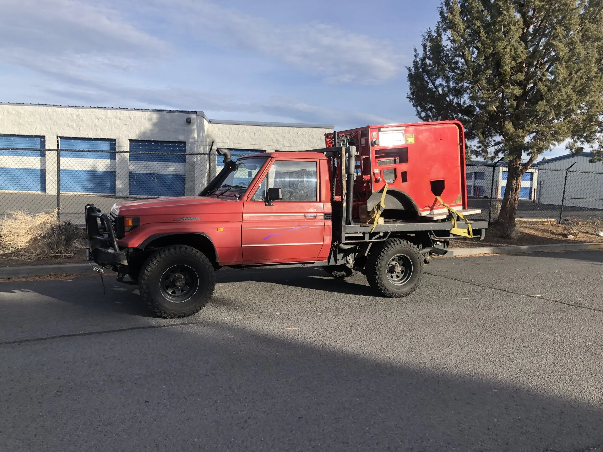

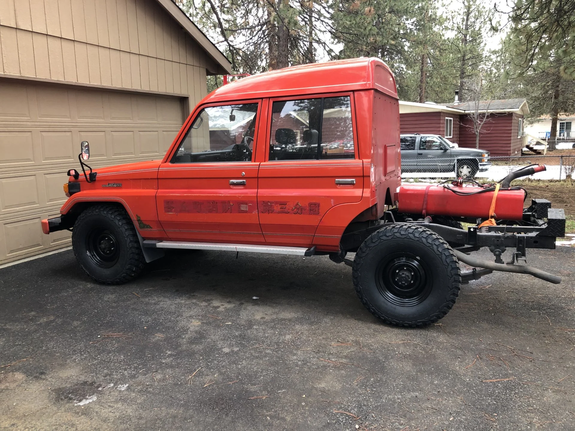

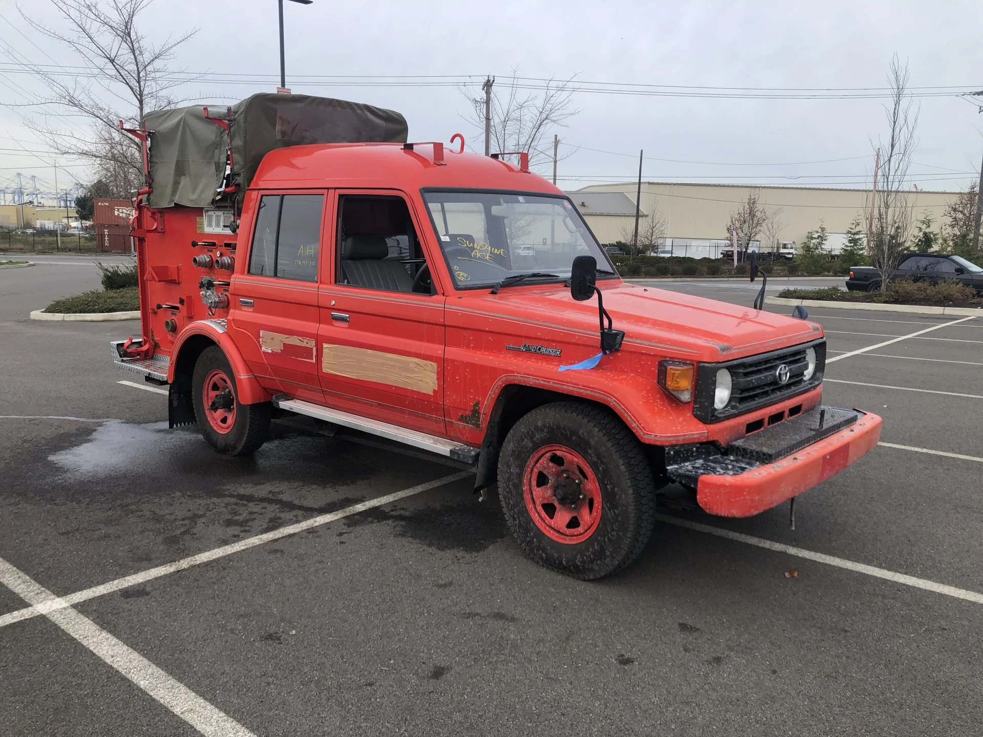

Picked up a 4 door Hzj75 fire truck from Japan with some low low miles. Give my beater 75 series Ute (pictured below) some well deserved company!

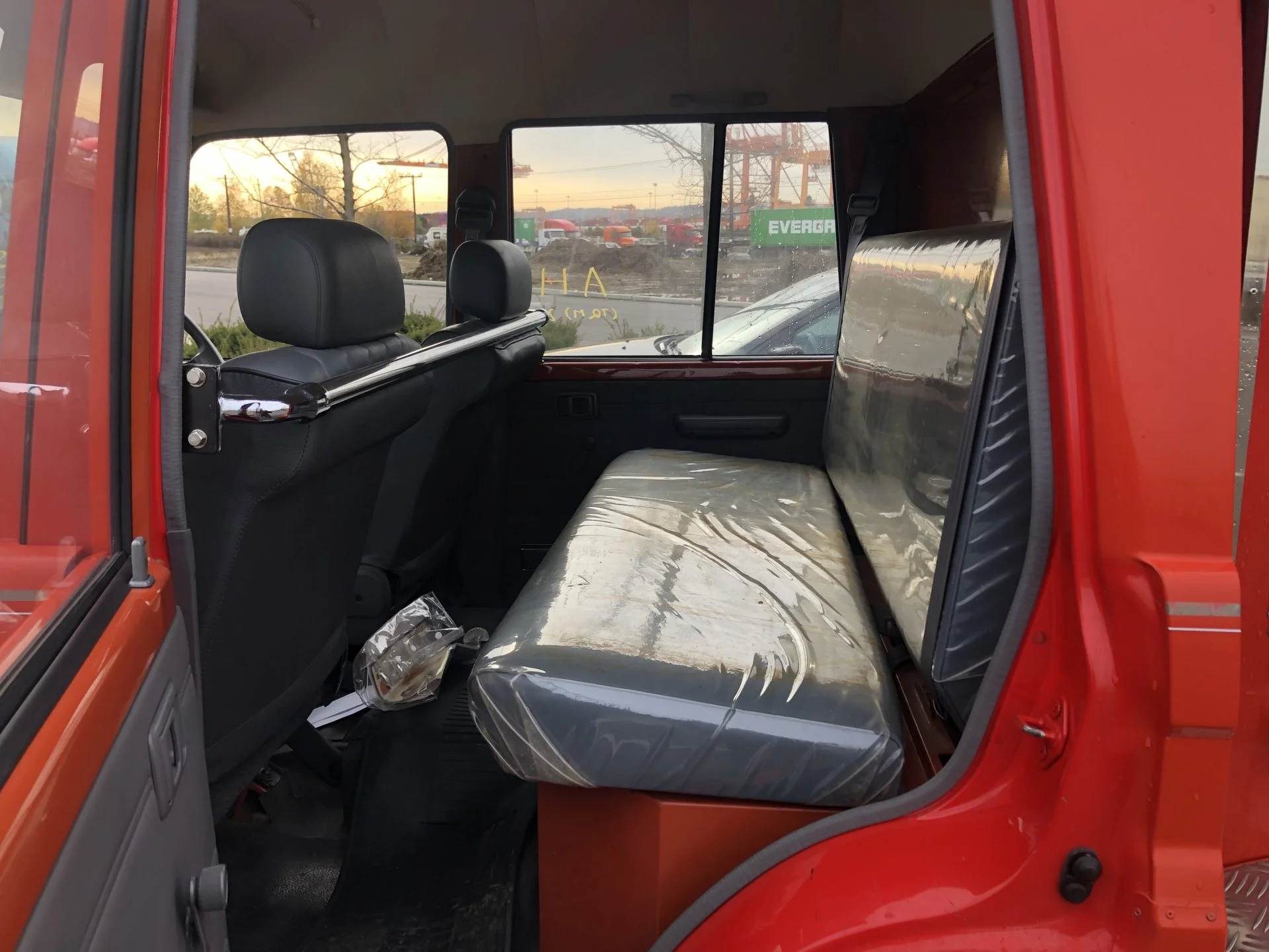

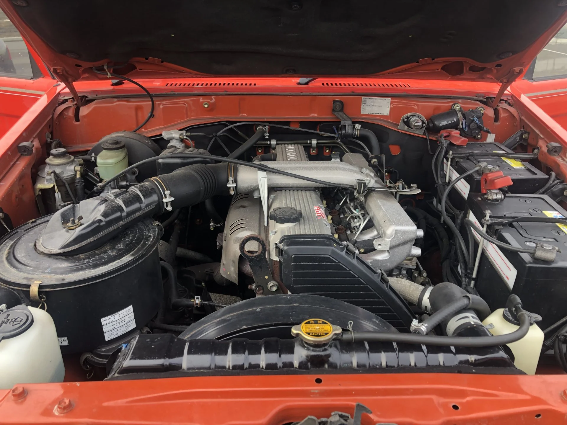

Anyways it’s got some super funky additions such as a front bumper heat exchanger attached to the radiator? No a/c or power steering. Don’t care about the A/C but have to add some PS at some point. The back seat is elevated to make room for the PTO pump. The seat just sits on that opening loosely which makes for a very loud car ride.
Tentative plan is to
-Ditch the pump platform

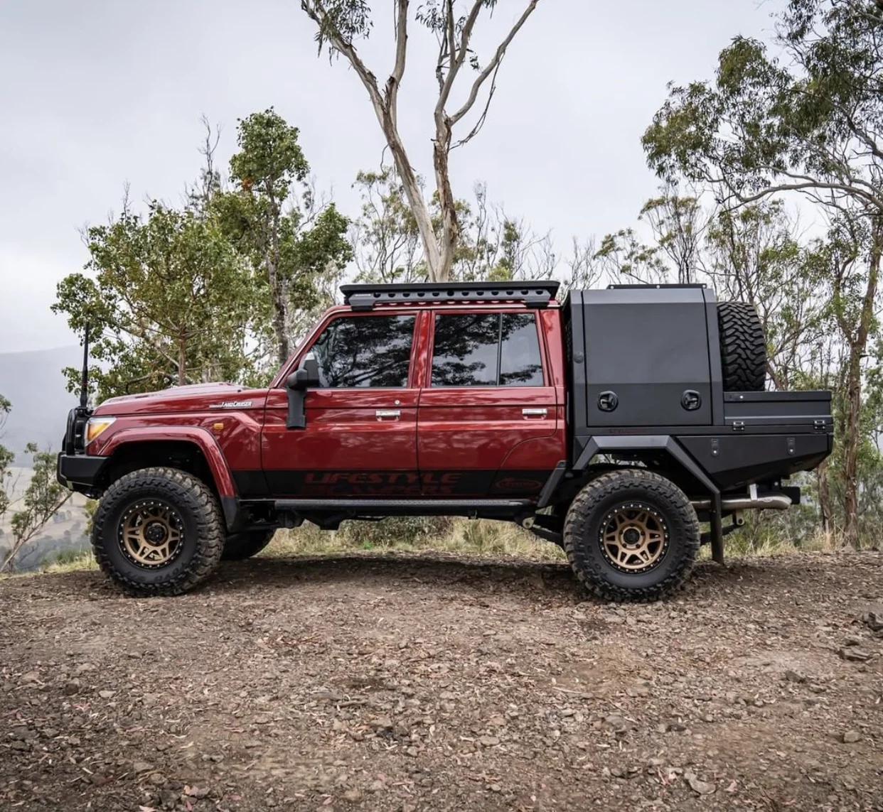

-Build Aussie style flat bed (see photo below)

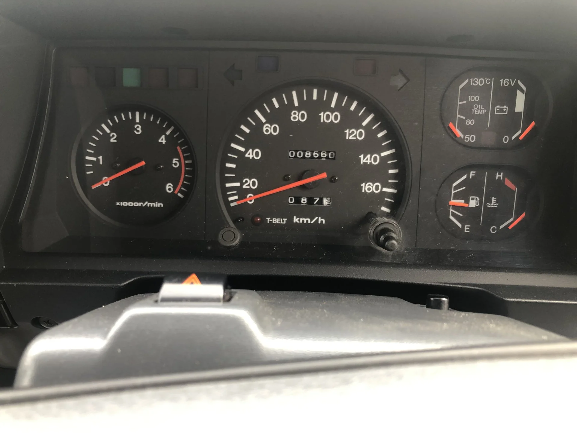

Does that say 8500 km's?
Yep 8500kms off the boat. Comparatively my single cab from Australia has around 480kms.

nice rig. personally I would keep the high roof, maybe for some sort of overhead storage of light stuff like coats
High roof has been slowly growing on me. It has a ton of little zipper cubbies in it. Tore into the pump tonight from underneath, some really neat engineering went into building this especially given the year. I’m expecting to lose near 3,000 pounds between the actual pump, the body and eventually going away from the heavy split rims.

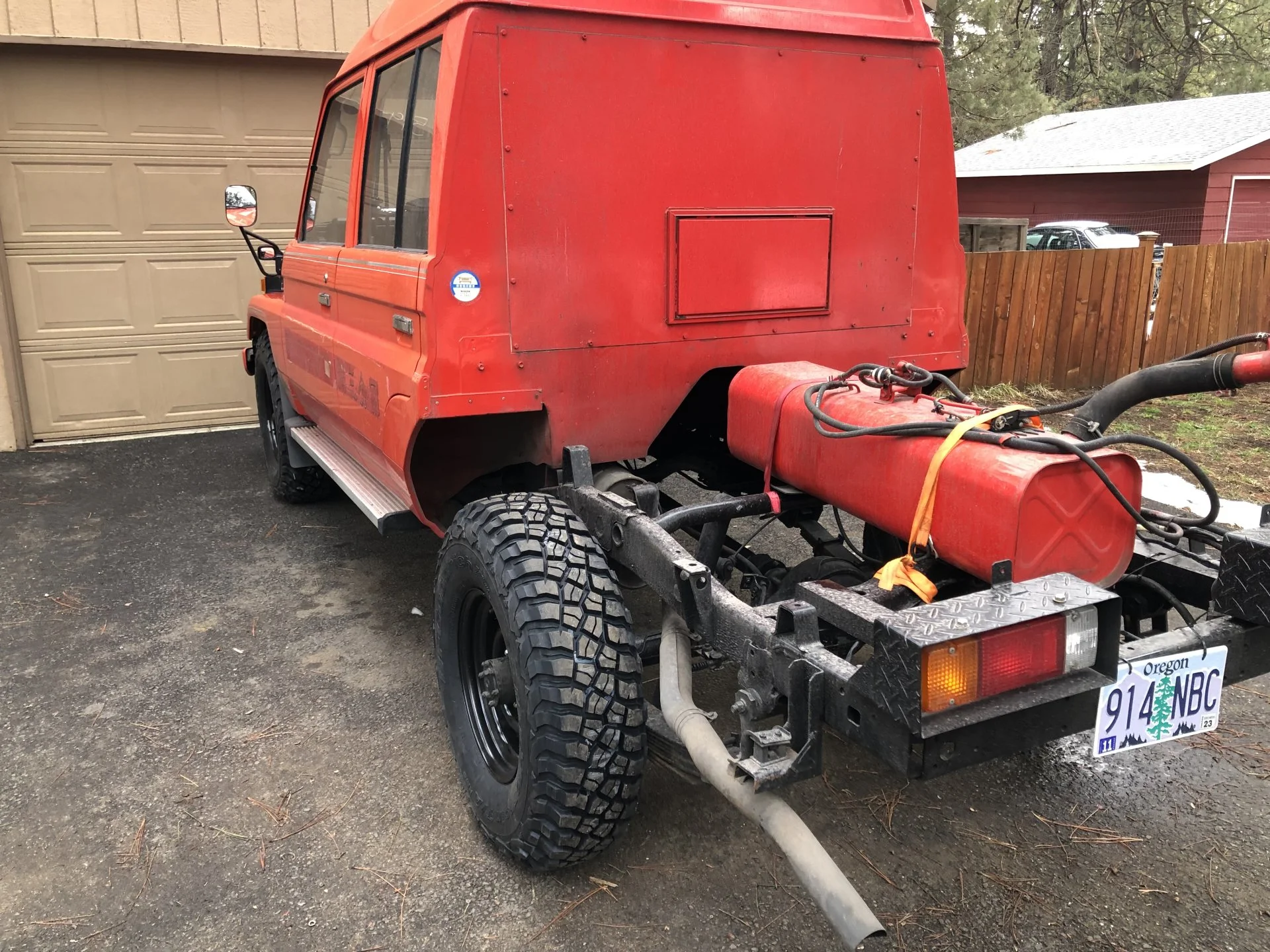

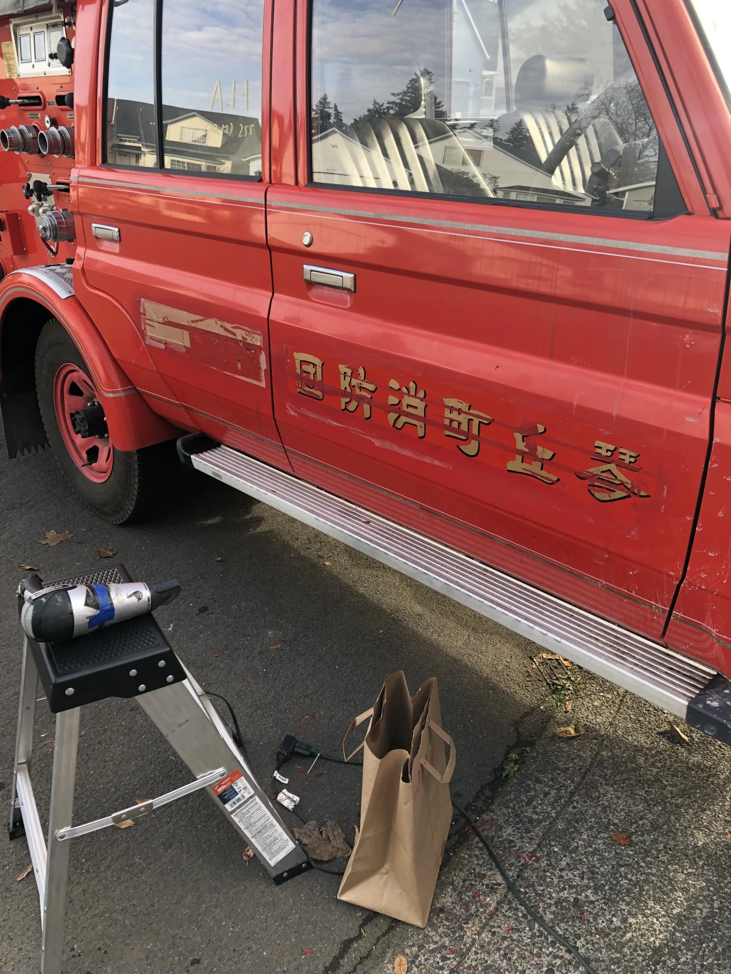

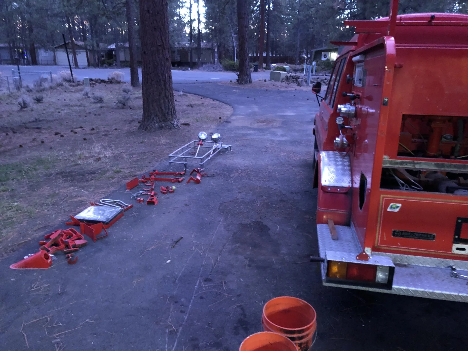

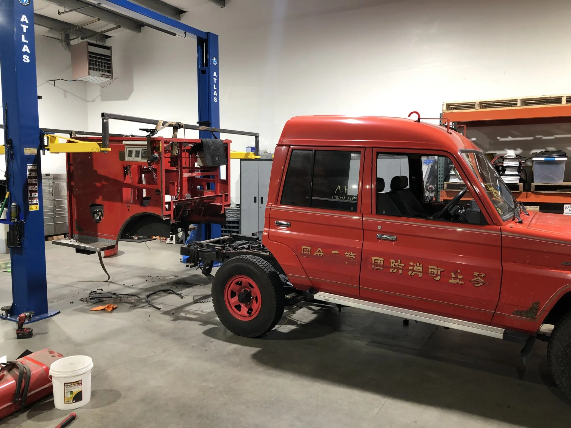

Made some progress today. Got all the accessories off the back and plates off so I can get a better idea what’s going on in there. Luckily nothing is rusted and everything is coming apart easy. Biggest thing to think on is it has an auxiliary oil cooler fed by the radiator which is also plumbed into the main pump. So will have to find a way to block it off somehow and also try to keep it functional.
You will be able to run an industrial sized compressor off the PTO. Like seriously, 125psi and at least 15cfm.
You could run a hydraulic pump off it as well. Then you could have an onboard hydraulic system like a Unimog. Or you could power the most ultimate hydraulic winch off it, or both!

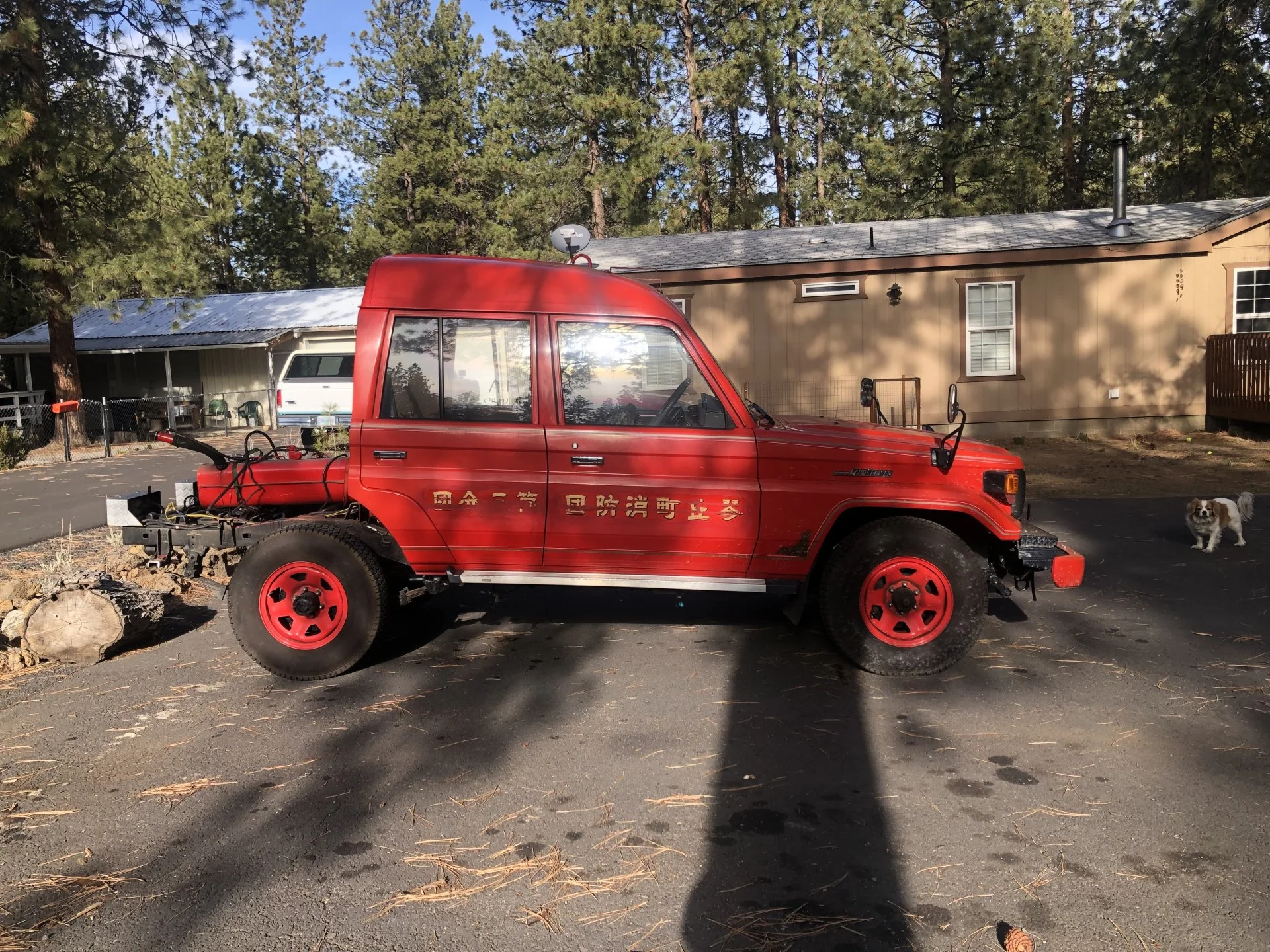

Trying the 33’s from the single cab on. A real bear with no power steering in parking lots.

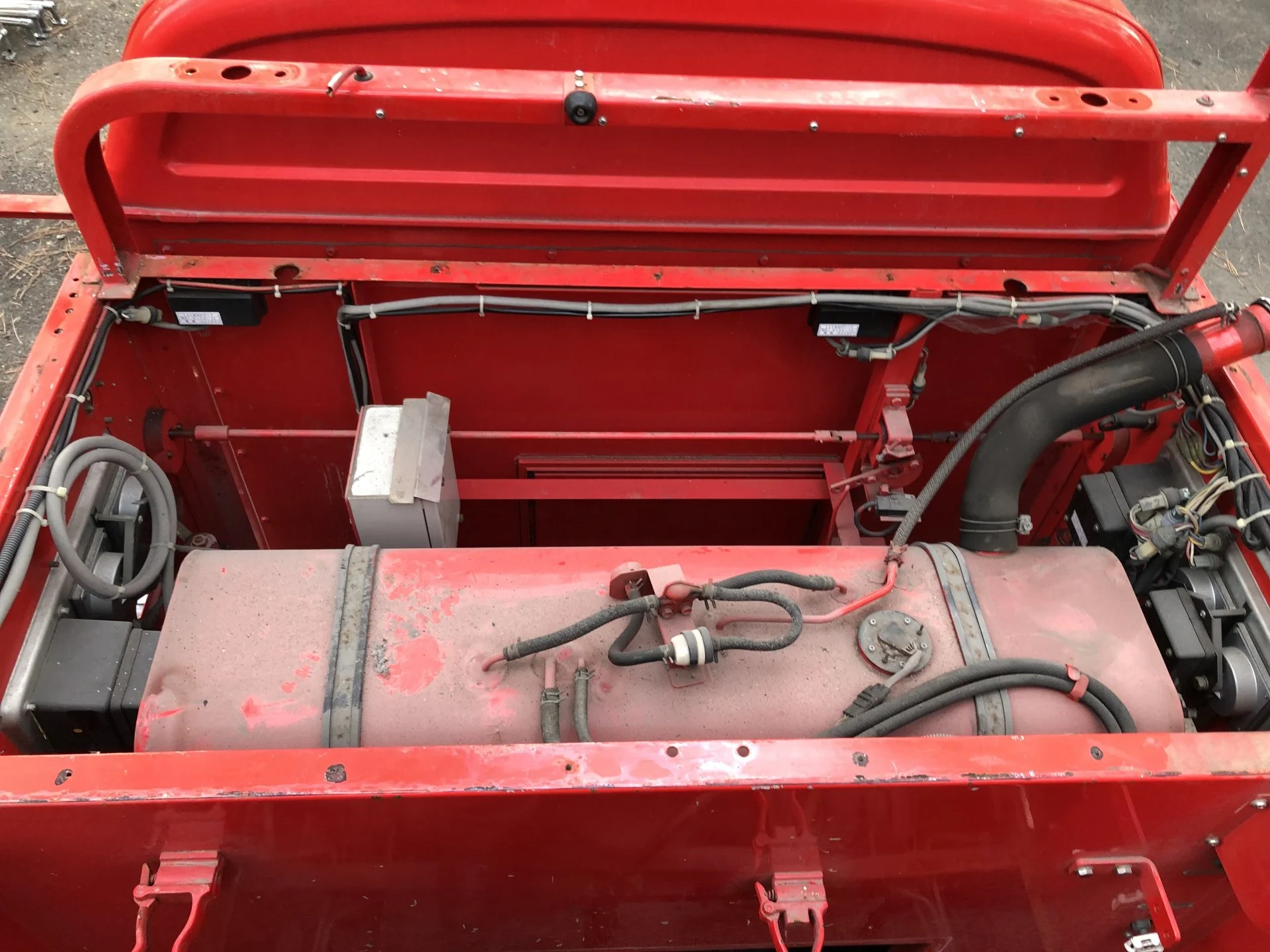

I’ve commissioned a local fab company to build me an Aussie style tray in February. In the meantime two major things to take on.
-Sourcing all the power steering parts. I can get a lot from partsouq but not everything. Still looking for the high pressure lines.
-Fuel tank. Need to find a factory fuel tank that I can retrofit. The current fuel tank is just tied down up top and is only 15 gallons. In place of the usual fuel tank location is the spare tire brace.
Thoughts on these two issues? I need to get the fuel tank sorted before the tray is built.

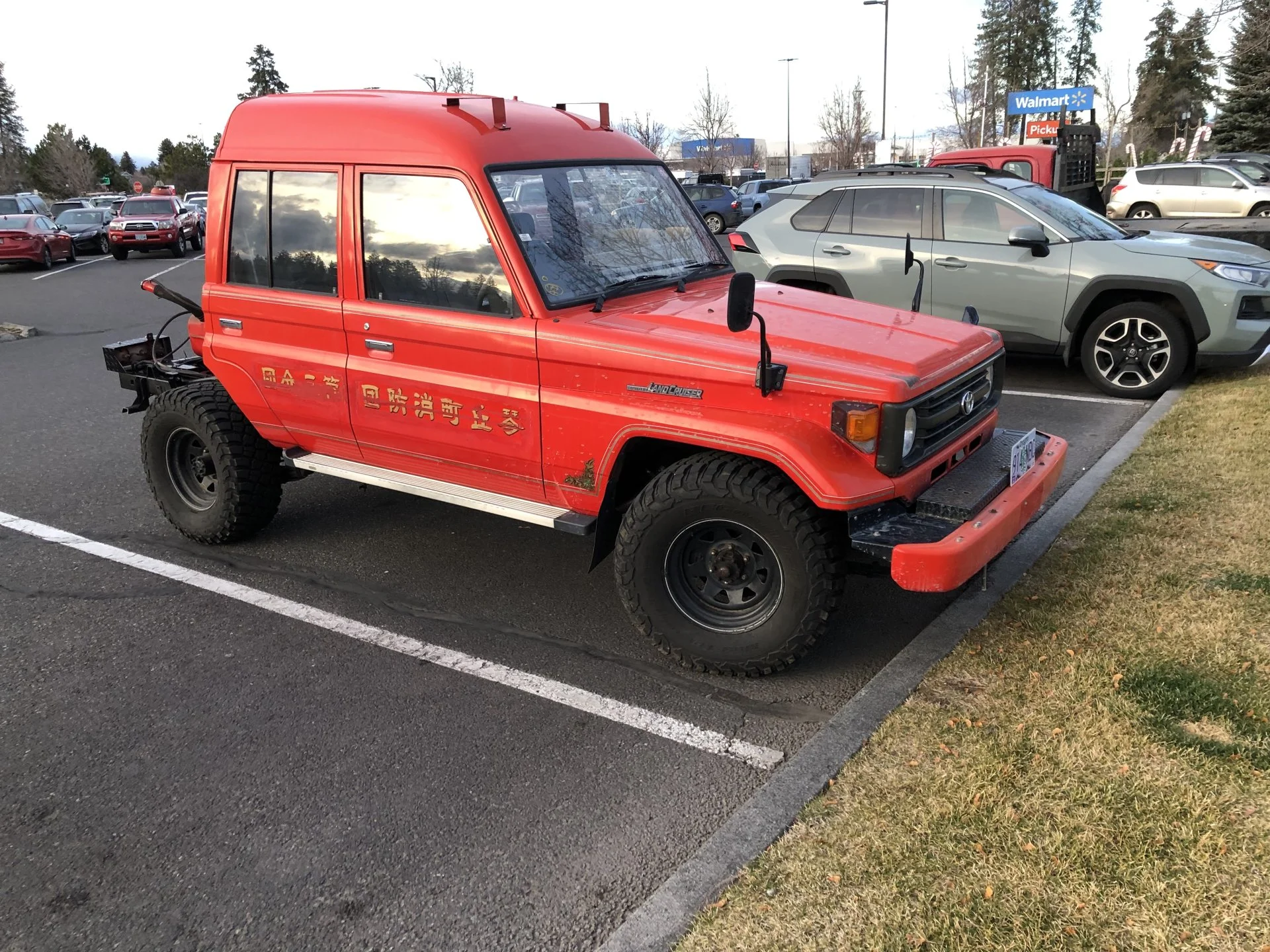

Ok we’ll have had some highs and lows with the truck mostly highs. Got a set of KM3 255/85r16 on a set of jegs steelies. Fit good and much easier to turn then the 315s!
