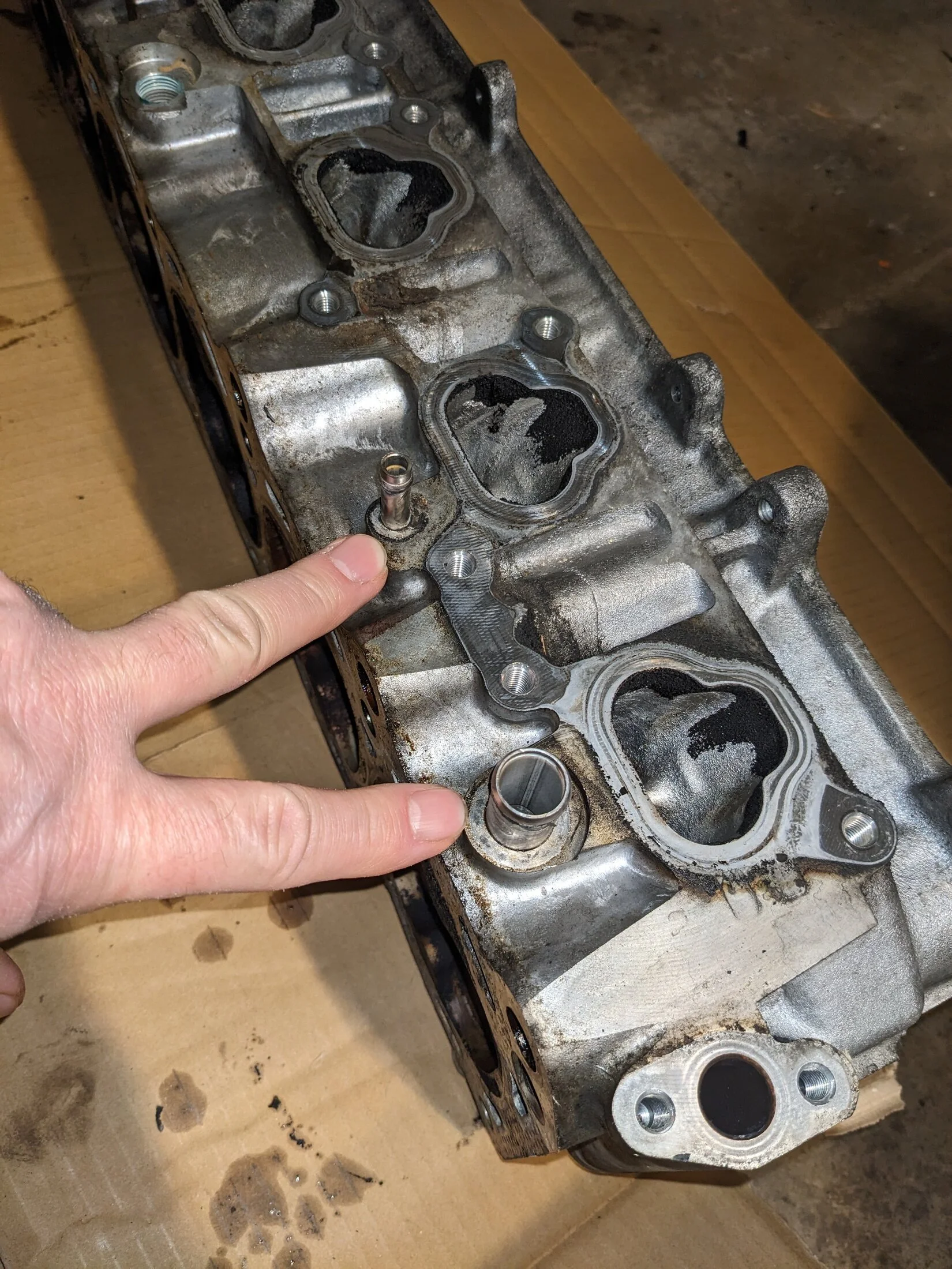

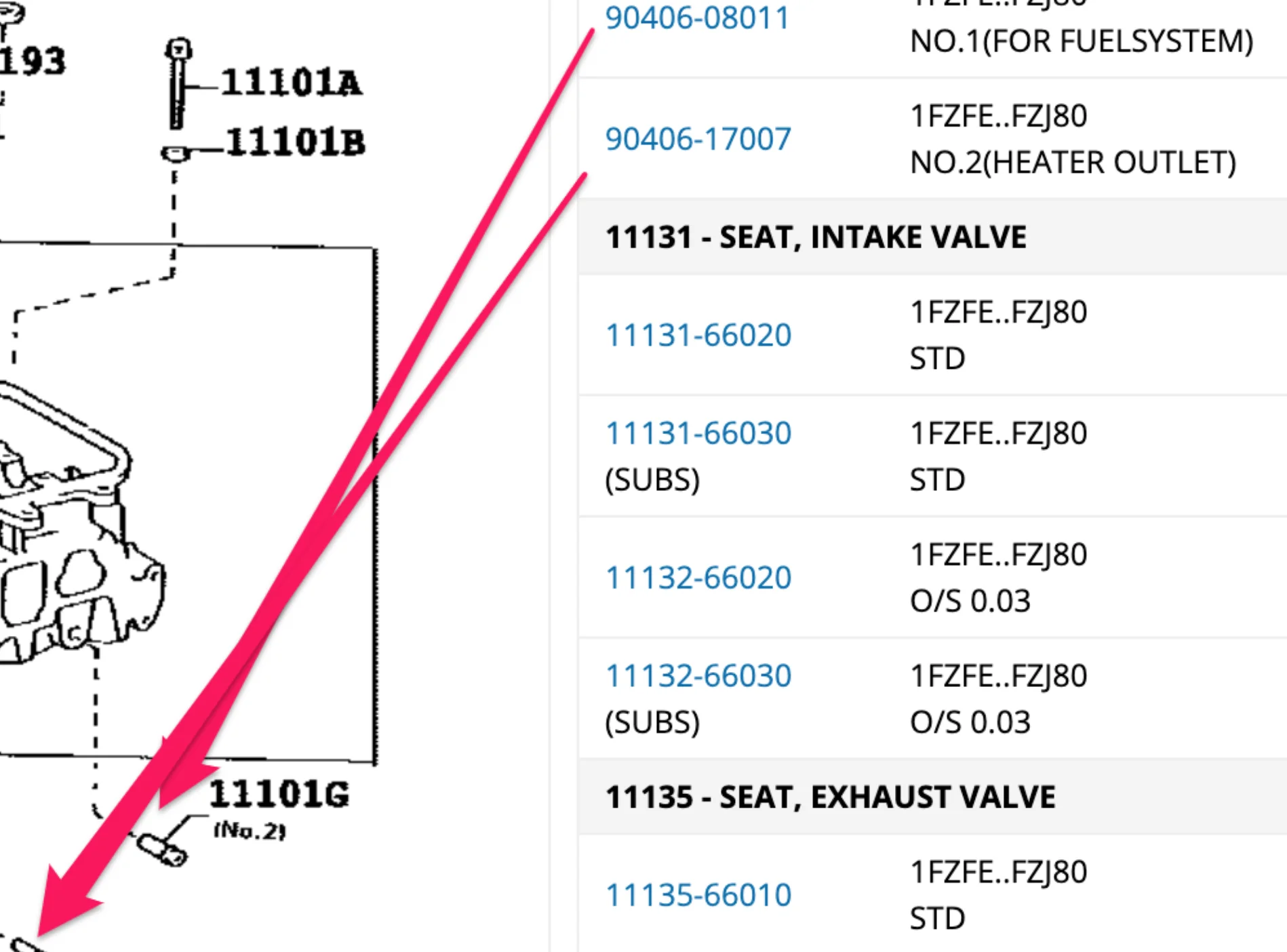

Please help to identify the part numbers: two pipes on the 1FZ-FE engine head.
Please share your experience: how to install two pipes on the 1FZ-FE engine head. Do I apply a sealing compound on the pipe ends and press them in?
I would use a locktite product.
But first freeze the pipes, use a torch to warm around the hole and then assemble.
