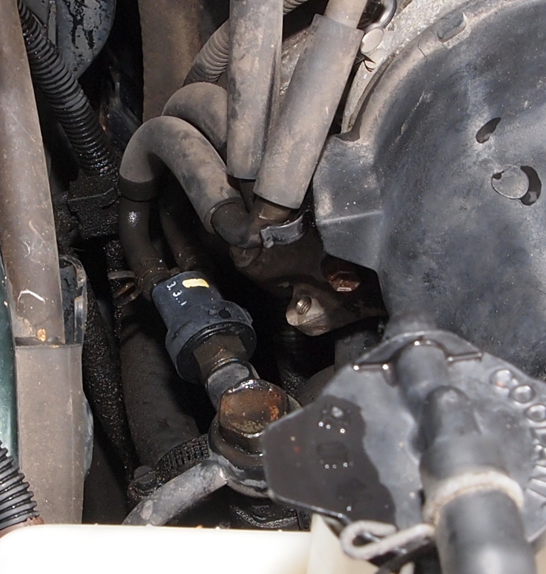

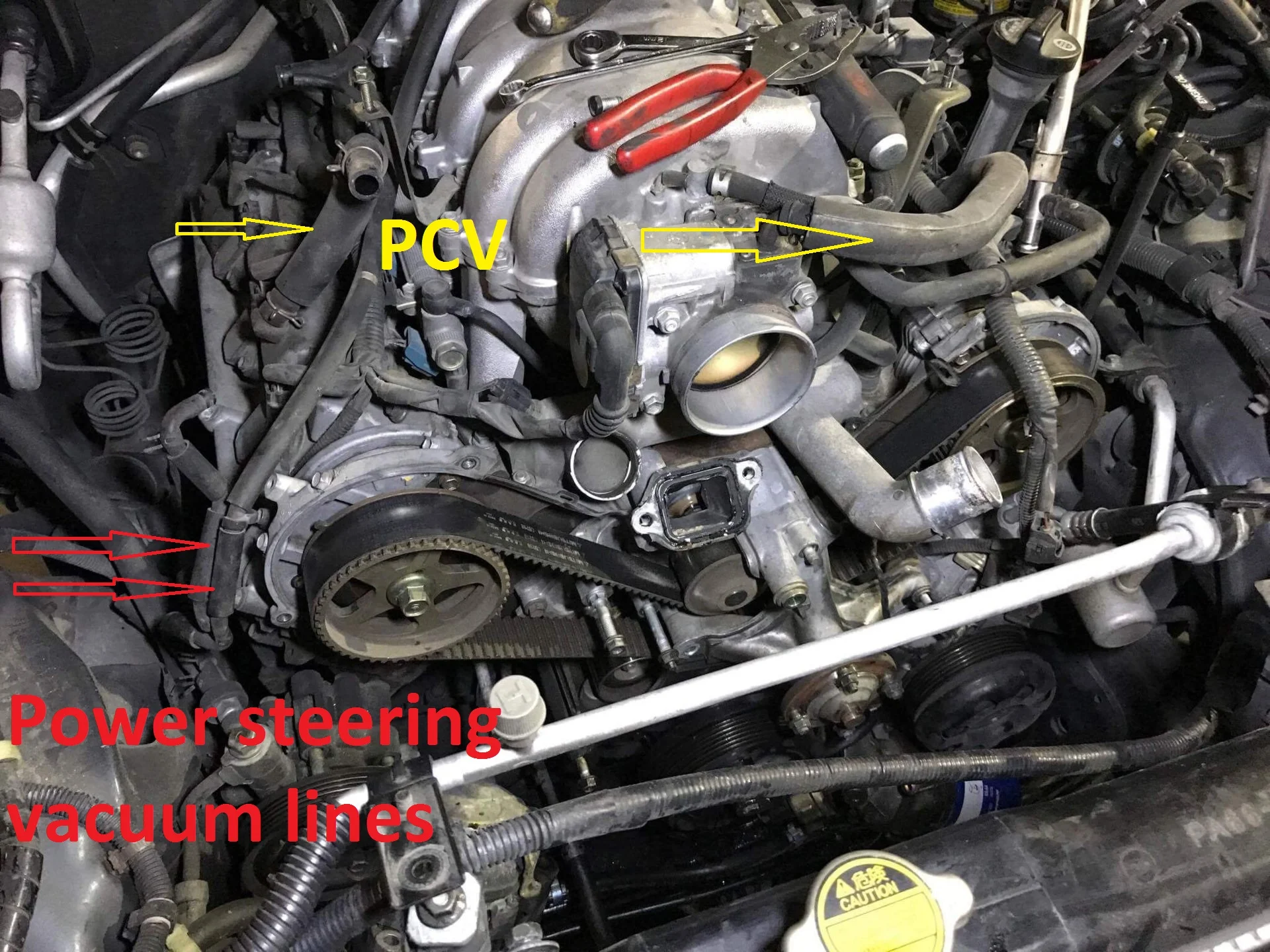

When turning, we tax RPM. Via fan belt which runs the vane pump (power steering pump). The HP line of vane, has a device call "idle up control" (IUC). IUC has two vacuum lines attached. Make sure rubber vacuum lines in good condition. Also make sure all vacuum line in good condition.
Idle up control & it's vacuum lines:
Also look at:
