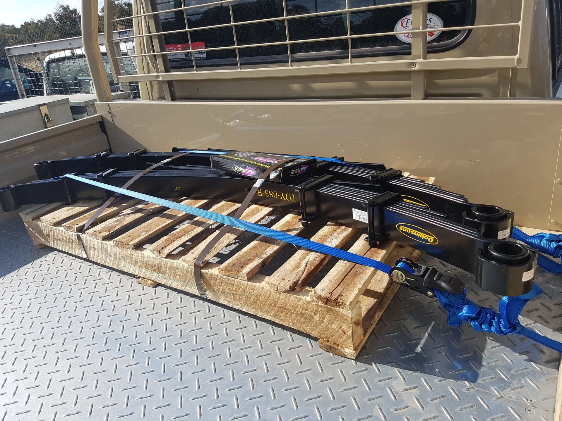

I was at Dobinsons head office in Rockhampton today and was ready to buy their parabolics, but they steered me away from them. So I ended up with these instead. 7+2 heavy duty. Constant +300kg
The parabolics were more expensive too.

And WHY did you / they steer away ?
@GooSe77 Dobinsons are having some sag issues with their parabolics. I was told they are made overseas (thailand?.) and they use inferior steel to the normal leaf packs that are made here in Aus. EFS have noise issues (loud clangs/bangs) with their parabolics and when confronted, said its not their problem.

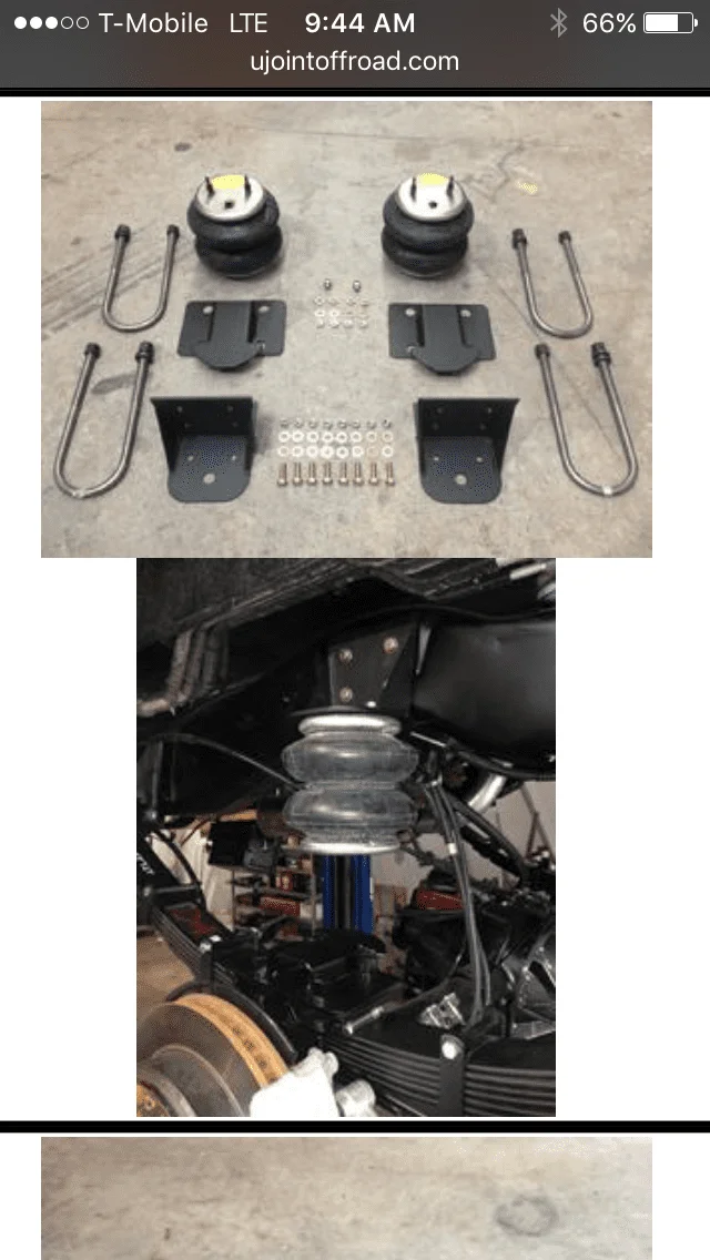

Run air bags for the weight.
Air bags (over leafs) limit flex and point load the frame in an area already stressed by the additional weight. One can reinforce the frame, but that doesn't solve the flex issue. YMMV
Guess you have not seen these...
4x4 van conversion parts
Cheers
Interesting design that does not limit droop. However, this kit would not work on a LC without reversing U-bolts or SOA. Options are pretty limited to parabolics... for now
Simple to solve that with a u-bolt flip kit.
