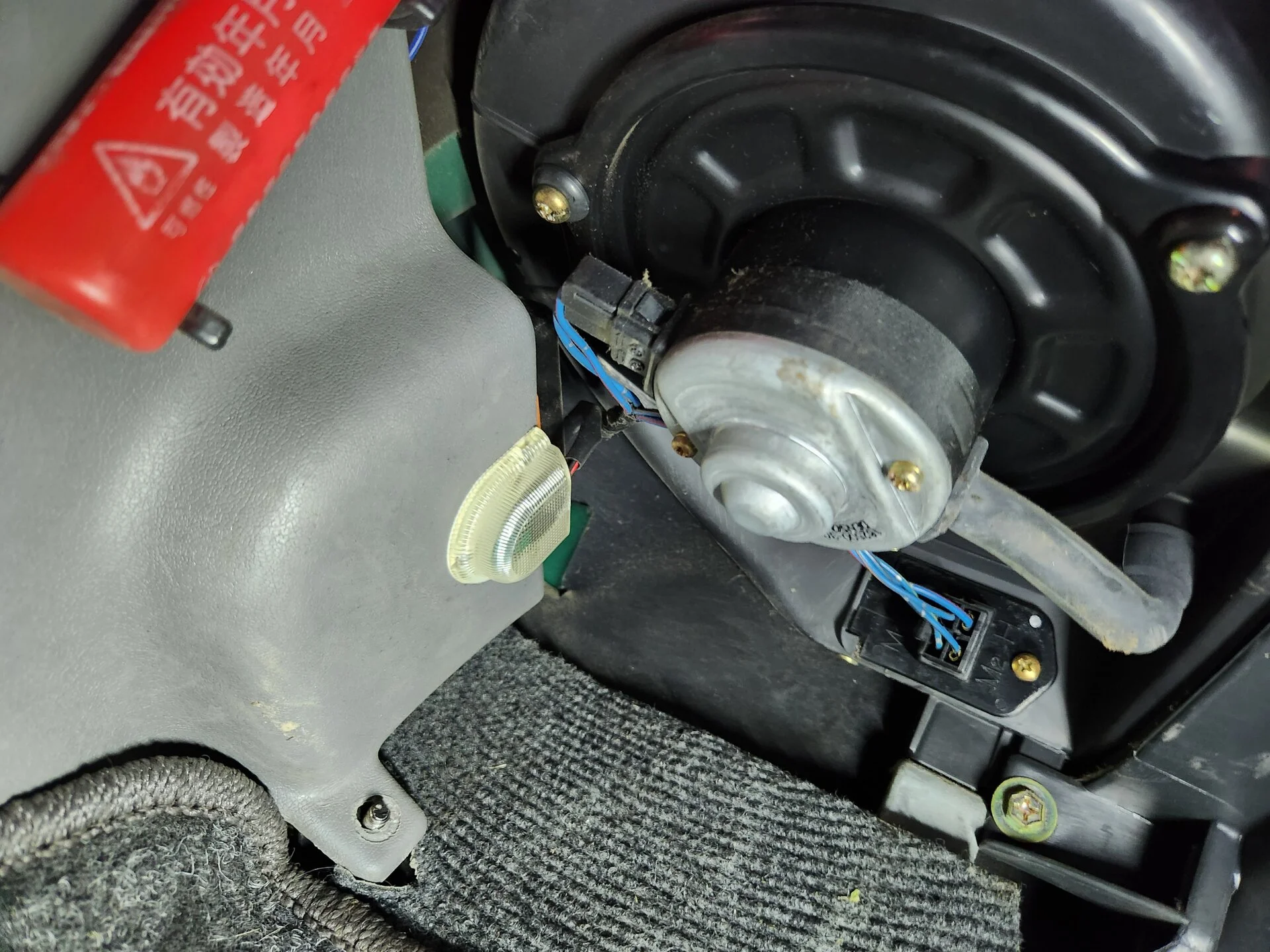

Well I found time today to do some vehicle work. I helped my two older boys get started replacing the parts on my oldest son's jetta, answering their questions where needed, but in between I took out the blower motor and cleaned it all out really well. The "bearings" were even simpler than I expected, just a shaft on each end with a sleeve.

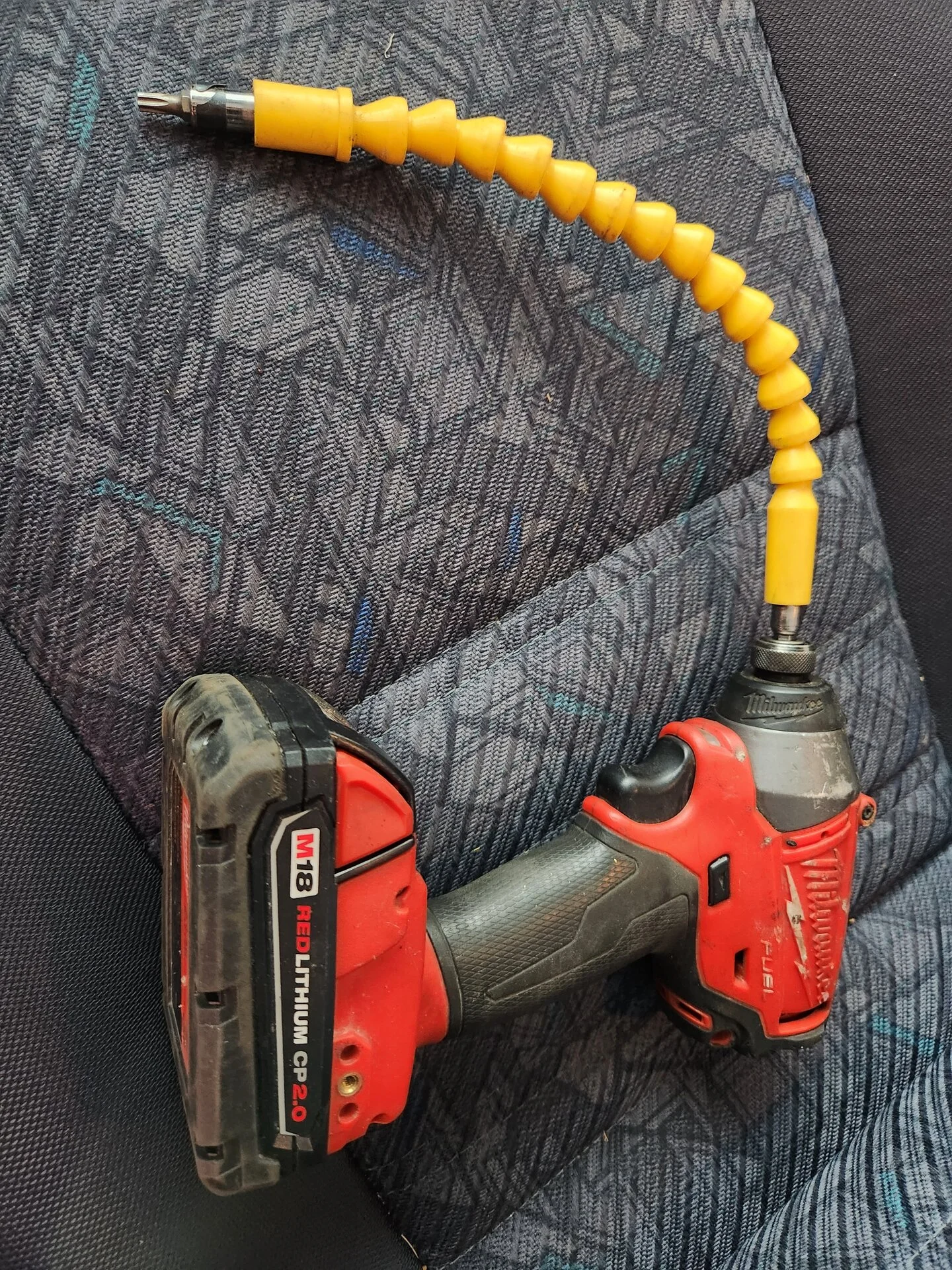

Accessing it was relatively straight forward, as stated above, 3 screws. You will never get the closest one to the firewall with a regular screwdriver, so I opted for a flex tool:

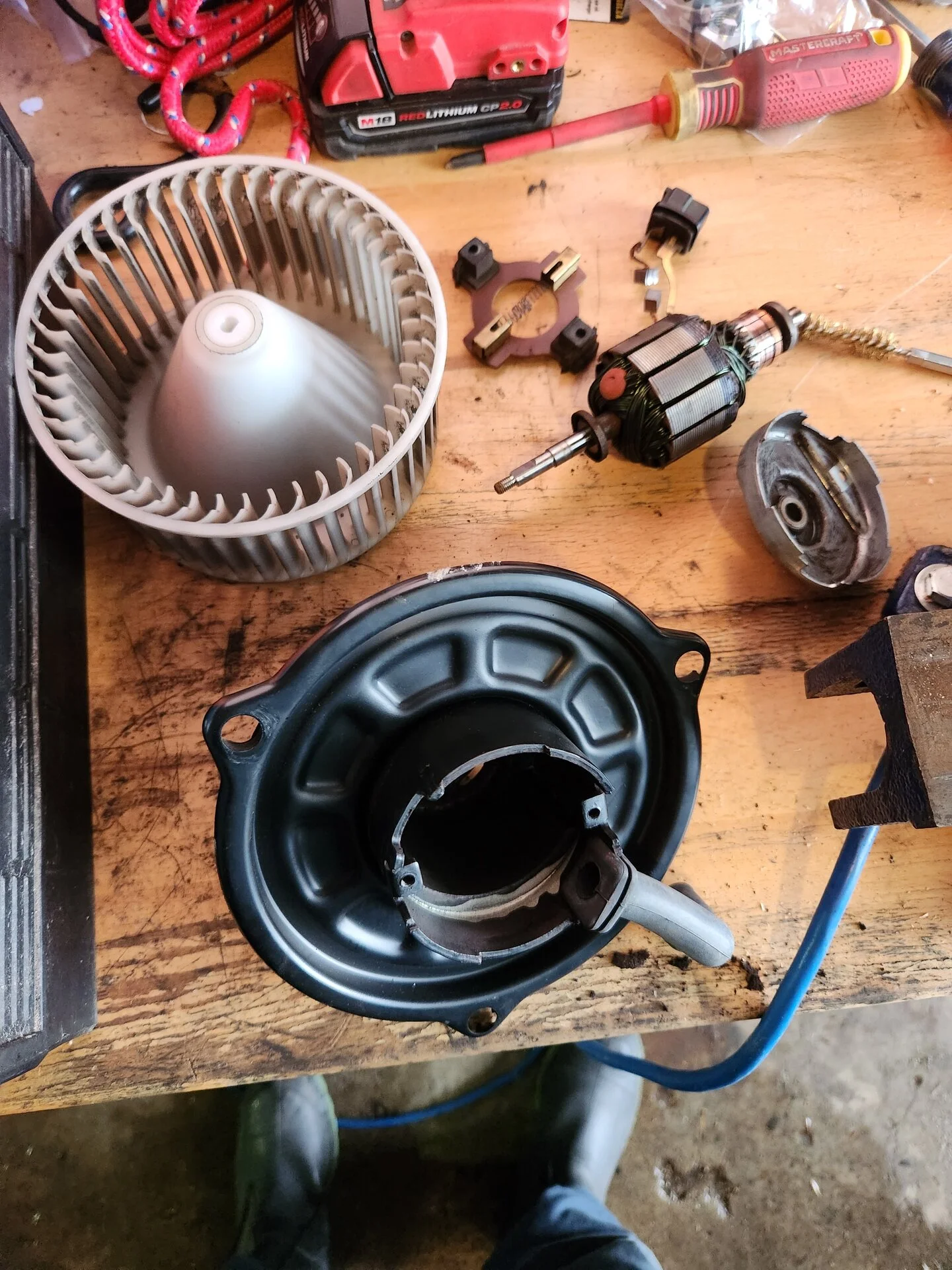

The motor itself is typical simple but good Japanese engineering

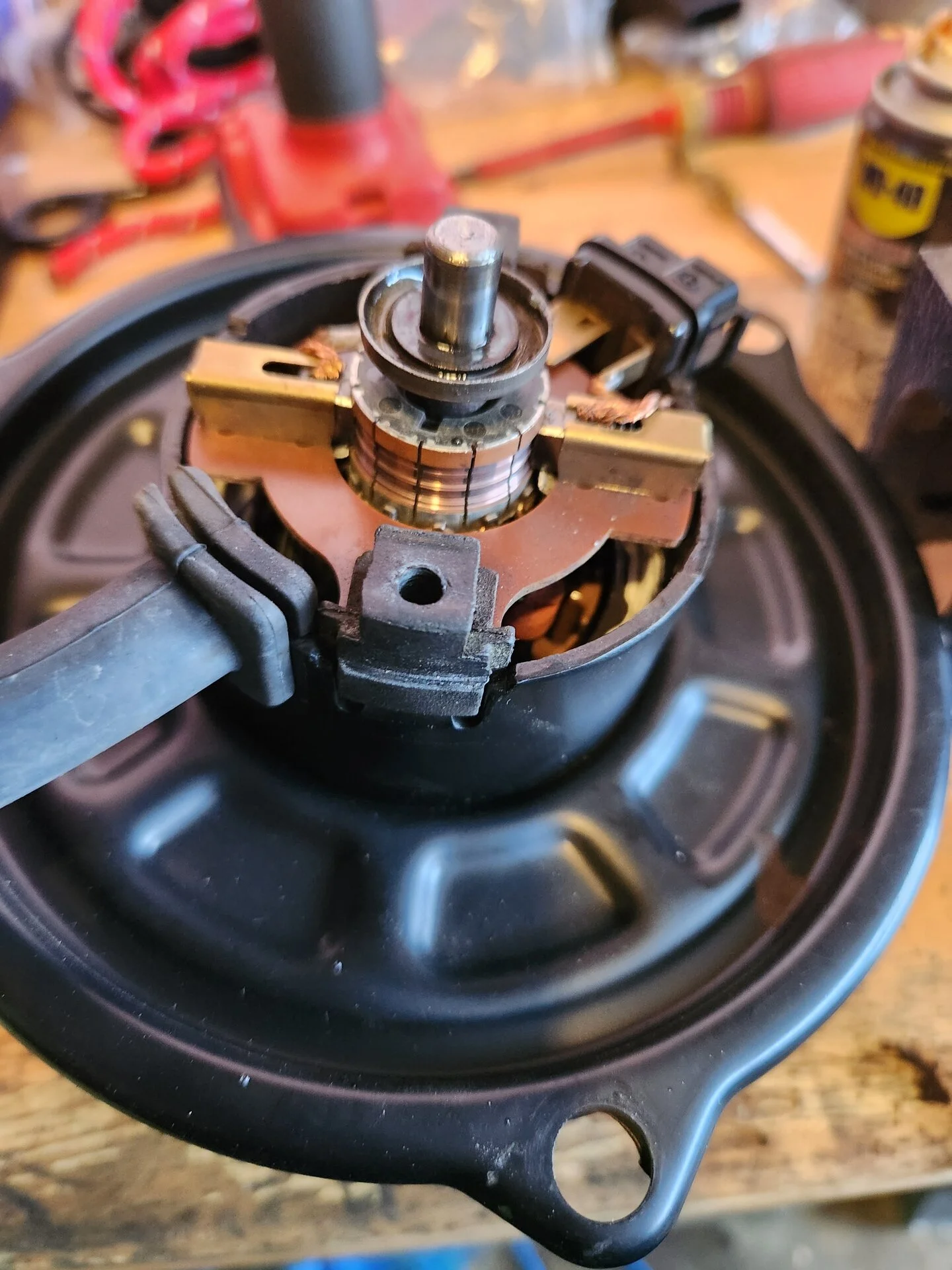

cleaned it all up well, then I used a "sticky" type chain oil for the shaft and sleeve style bearing. Reassembly is a little tricky with the long springs and bushings, so I used 2 thin strips of gorilla tape to hold then in place during reassembly, then pulled them out. Duct tape should also work, but I would not use masking tape as it tears too easily and you will end up leaving some in there.
Worked like a charm:
Reassembled, put it back in and no more crickets! At least for now. :cheers:
