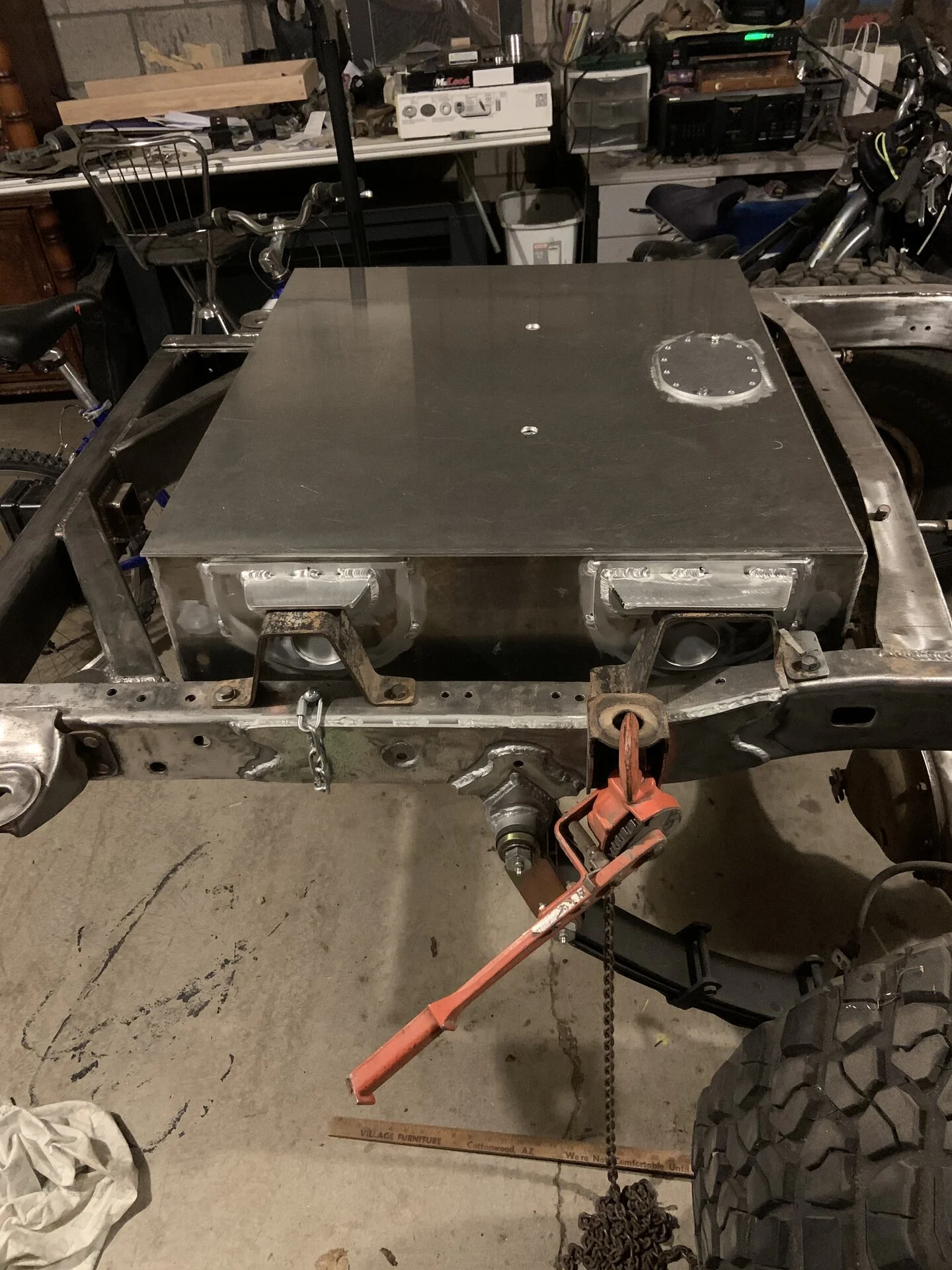

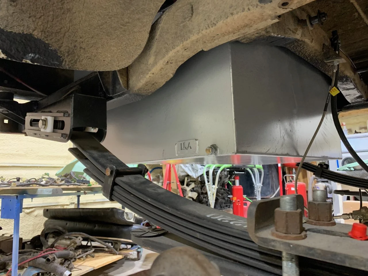

LRA tank definitely requires some fab. Installed one a few days ago
While we’re on the subject, what fab work did this tank require?
The brackets from LRA are basically only good as steel stock and get you in the area. To use their mounting holes was impossible and would have put the tank either too far forward or back (I don't recall). The brackets required clearancing around a body mount and new mounting holes needed to be drilled in both the brackets and tank flange.
Completely do-able with what they supply, but I wouldn't want to attempt it on my back and with a floor jack. Using my transmission jack, I probably had it up and out at least 8-10 times to get the fit I wanted.

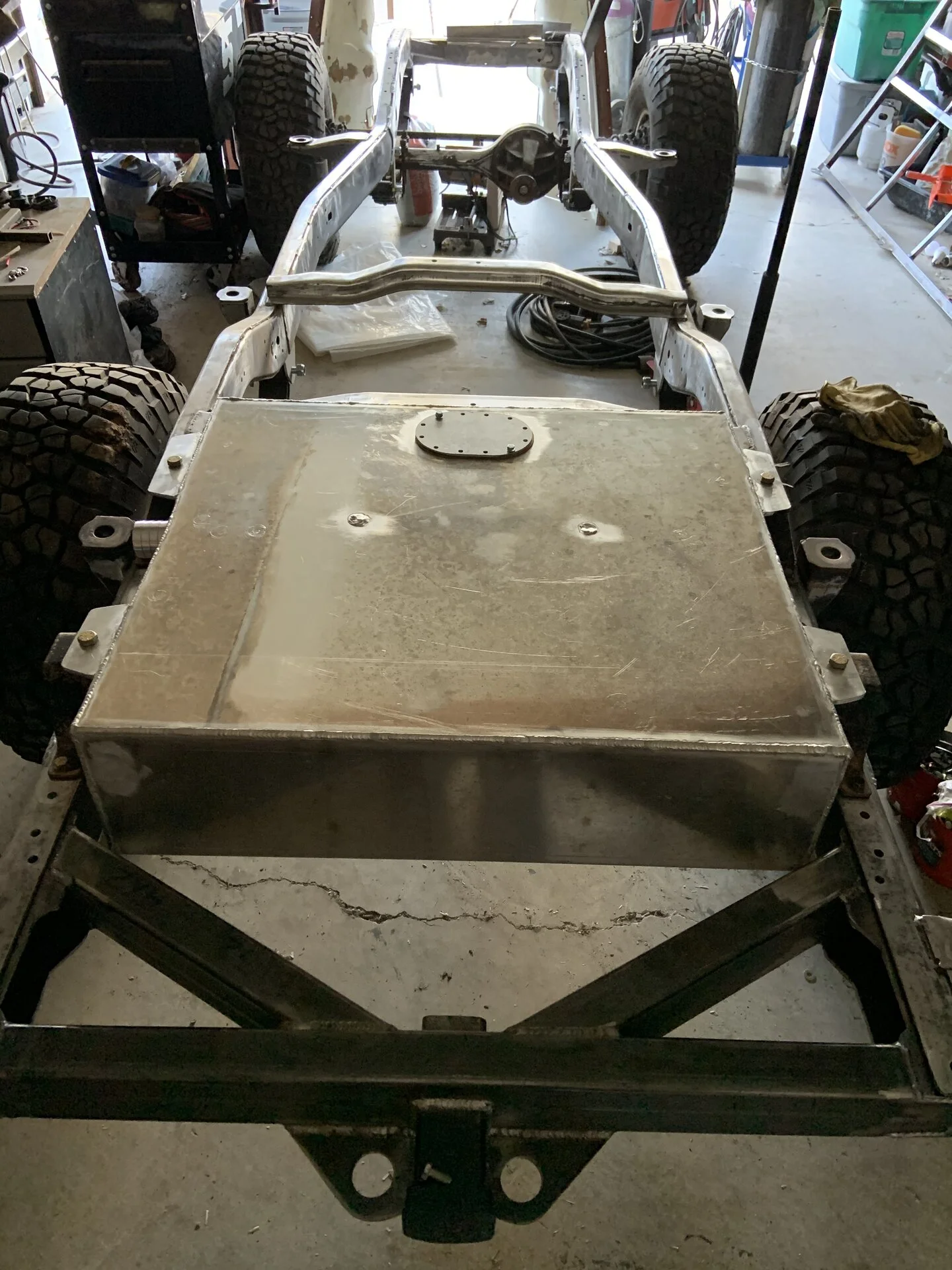

Interesting. This is the most concerning part about building custom larger capacity aluminum tanks - the best method for mounting. Toyota couldn’t make up their minds on the best way to mount the tank and so there’s several versions of tanks (don’t know the year ranges for the changes in tank mounting design).
The 77’s had the pedestal mounts which bolted to the frame. Earlier versions mounted to the tub. Curious if the earlier frames had holes for these pedestals. I imagine it would be an absolute bitch to try to drill out bolt holes in the frame for later pedestals with the body in place.
