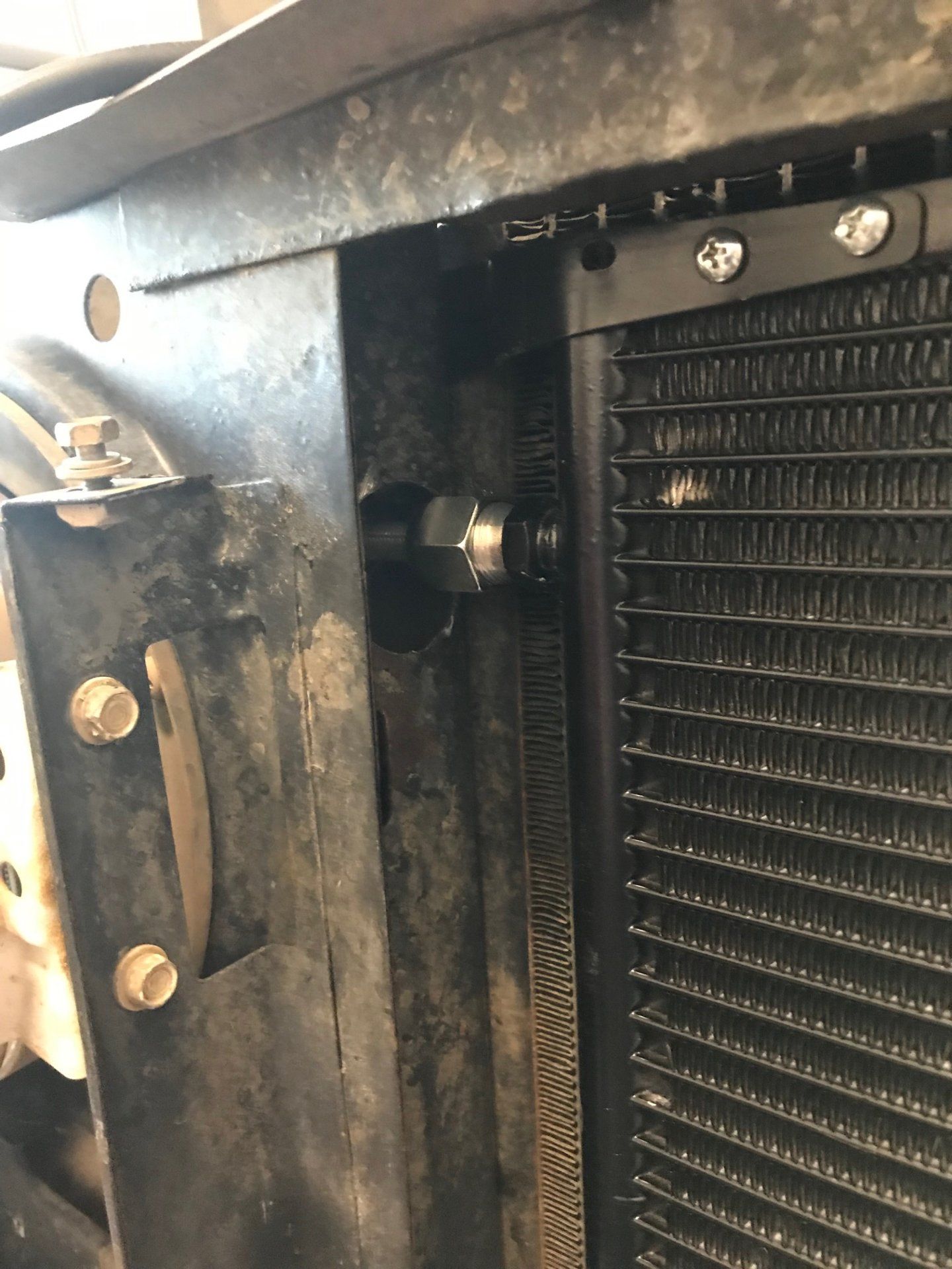

Anyway, this chapter is about the condenser. You'd think it was the easy part. You'd be wrong. It was kinda annoying. Anyway, first I removed the bad-ass grill, the hood latch thingy, and the vertical strut that's in front of the radiator. (Note: If you can't figure out how to remove these three thing, stop, do not pass go, do not collect your $200. Just roll down the window and hope for the best.) Next I took careful measurement of the front of the radiator to let VA determine the biggest condenser I could fit. Then I ordered the next bigger size, because I'm pretty smart and can make things work. Anyway after I returned the bigger one I started making the one VA recommended work.
The actual method to mount it isn't too bad. It comes with 4 little wings that bolt on each corner of the condenser. I then kinda customly bent them so that they basically fit between the radiator mount flanges and the metal structure the radiator mount flanges bolt to. The wings actually would have worked just kinda pinched in there, but I drilled holes in the radiator flanges and put some self tappers in.. Then I pinched them in also. So they are screwed and pinched. :)
It would have been really bitchin' to just run the AC hoses right up to the condenser and brag about my amazing success. However, there was Landcruiser stuff in the way. Namely there was a double walled shroud kinda thing there. After much head scratching, and conferring with Superdawg (who had been watching warily) we decided a 1 1/4" hole saw was just the needed item . (Remember the shroud kinda thing is double walled, double the drilling, no premature celebration.) Also make DAMN SURE you have the condenser in its final location to get the measurements prior to taking the plunge. You want the condenser plumb, square and looking good. You have to measure off the two fittings on the condenser to find proper location for the holes thru said double wall shroud kinda thing.
Anyway, in pix below you can see the holes through the double wall shroud looking thing, the hole saw (in a pretend action shot) and the AC hose coming thru the hole and attaching to the condenser. You can see the condenser mount wings a little bit.

My radiator support is already equipped with holes on the passenger side for the earlier condenser.
Did your support have holes before this project? Wondering if you needed holes period, or if you needed to move holes?
Do you have p/n and dimensions on the condenser?

1. The condenser I used was a Vintage Air VTA-03261-VUC. It's dimensions are 20Wx14H. ($150.48) The one I brilliantly figured i could make fit was 19x17. It would yield more surface area, but no joy. It's too tall. (I do have to fess up that because I live in Reno, Summit Racing's showroom is here. They pretty much always have everything in stock, and it's super easy to return stuff, even opened. That doesn't suck.)
2. My Pig had no holes for the liquid lines to go thru. Seems odd they wouldn't just stamp them in all of the bodies, but they didn't. I suppose there is a chance the stock Toyota holes will work for the VA unit, but you would have to be living right I think. (Maybe if it was a dealer installed option the dealers drilled the holes? Anyway I used a 1 1/4" hole saw.)
