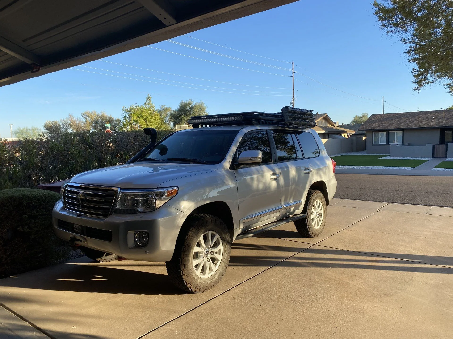

How do you like those safari rails on the Rhino Rack?
They have been great and added little to no wind noise. The light bar works well as a fairing.
I have been considering them on the GX rack. I like the look of the half rail, just might have to try it.

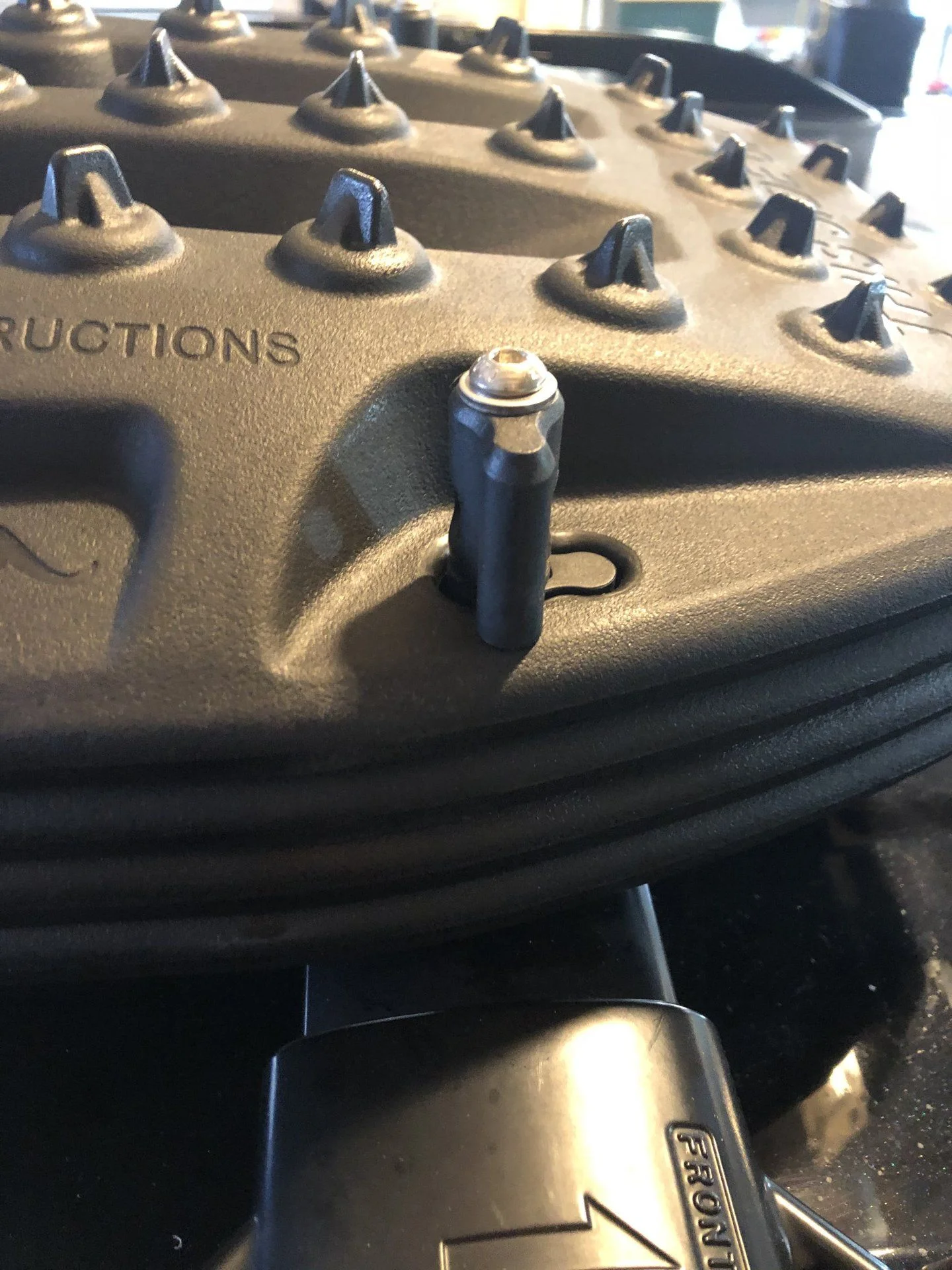

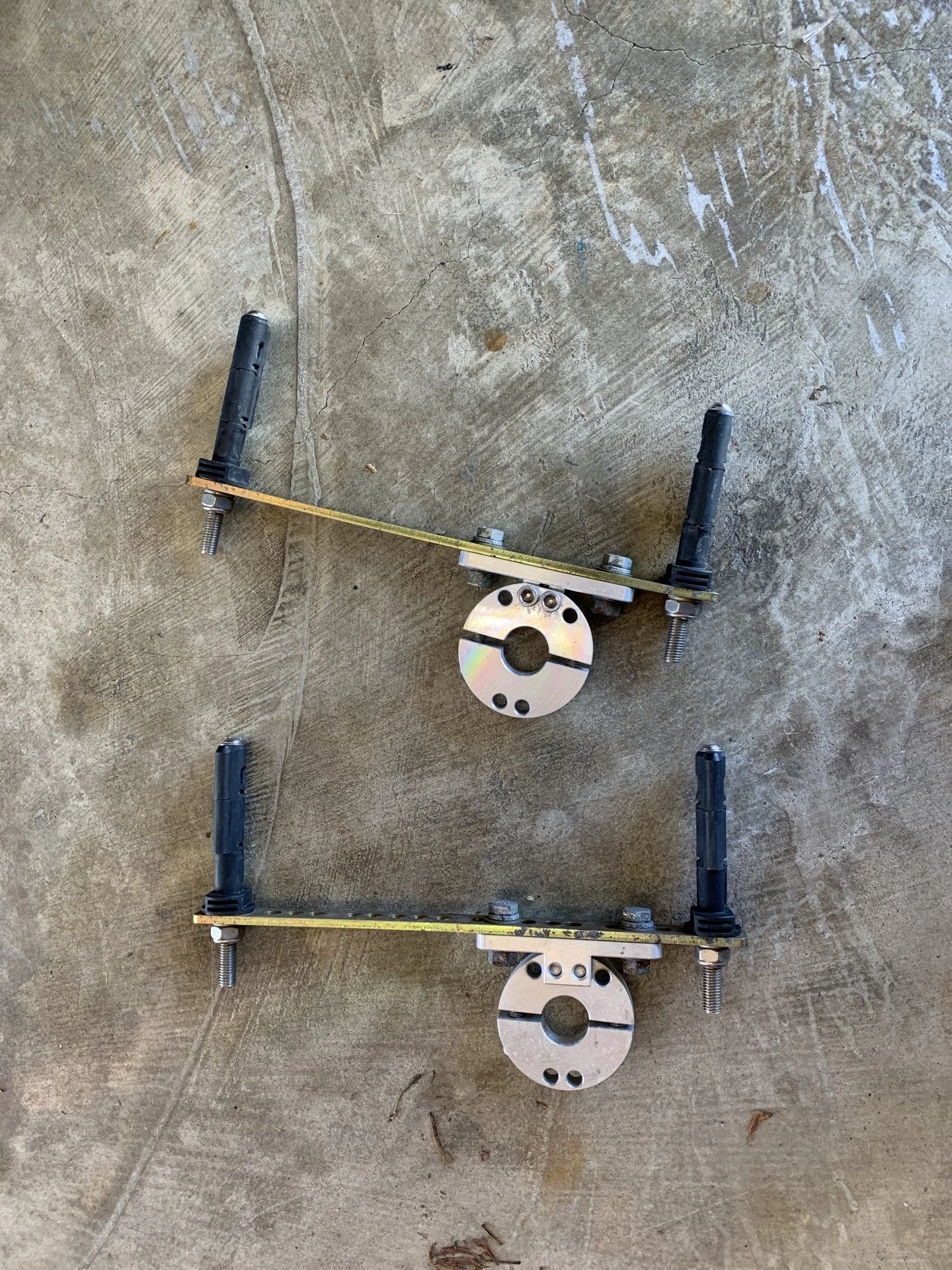

I opted to try the @mcgaskins approach. It worked well. The only thing I wish I'd done differently is to not follow the 27cm (side to side) base hole spacing - since there is a little bit of curvature to the crossbar ribs, the tops of the posts are more than 27cm center to center. The boards still fit, but it takes a little bit of encouragement to align them. I think if they were 3-5 mm closer they'd for better. I might adjust them when warm weather arrives. A teeny bit of elongation of the mounting holes would probably suffice.

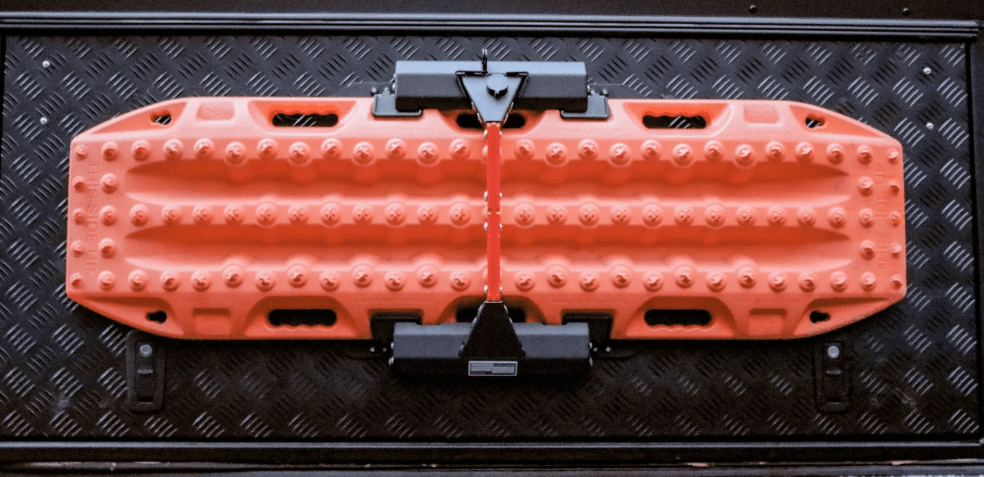

Front runner for me, only problem is I can’t get in my garage with the bracket on, so I have to attach before I go on a trip.
