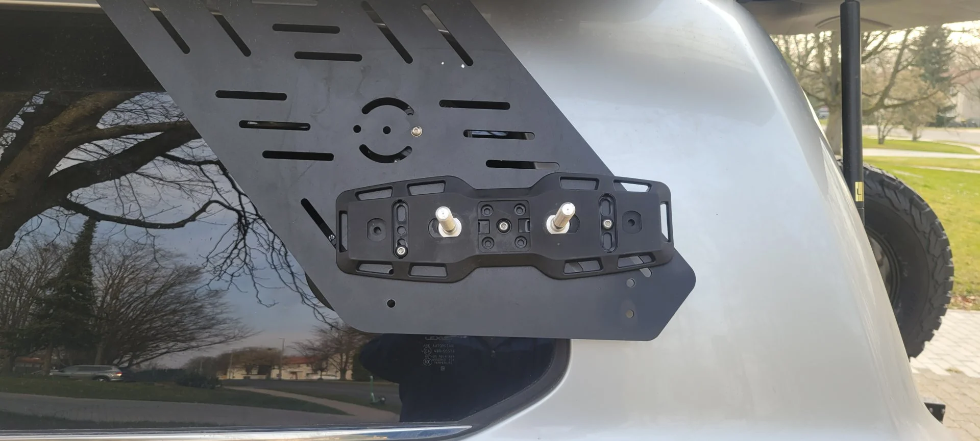

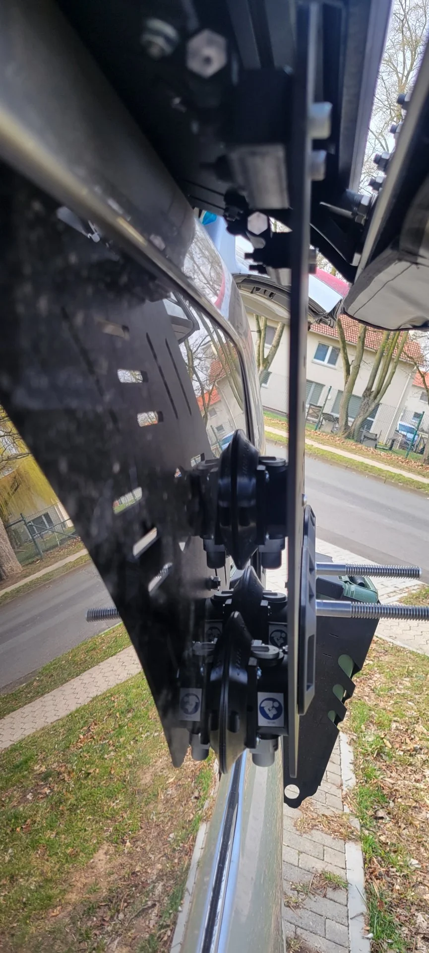

I have two pairs of TRED Pros that I mounted to a Vuctory 4x4 side panel. The traction boards weigh 32 pounds altogether. The side panel is only rated to 20 pounds so I added two extra mounting cups which I assume brings the dynamic load rating up to 60 lbs. Added a couple zip ties for piece of mind, no issues so far.
4x maxtrax on maxtrax pins on a dissent accessory panel. They fit like they were meant to be.
I love this setup to maintain lowest roof profile as possible. Also I’m 5’6”, I’ve only got so many jumps left from the rear tire before I blow an Achilles 😁

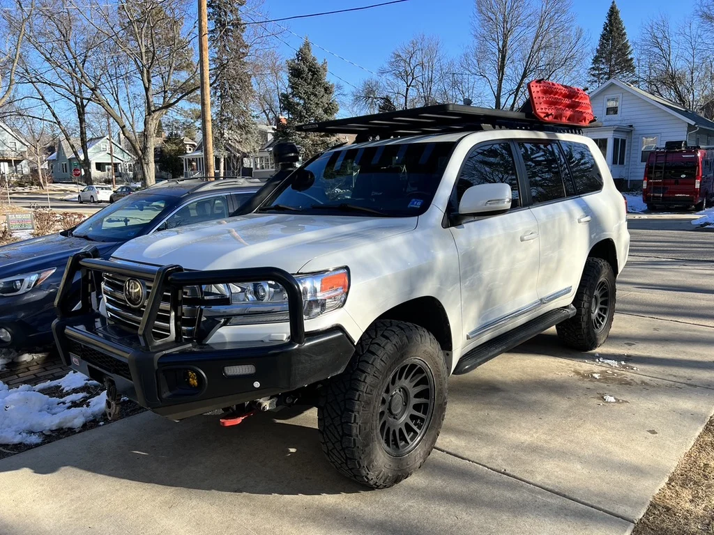

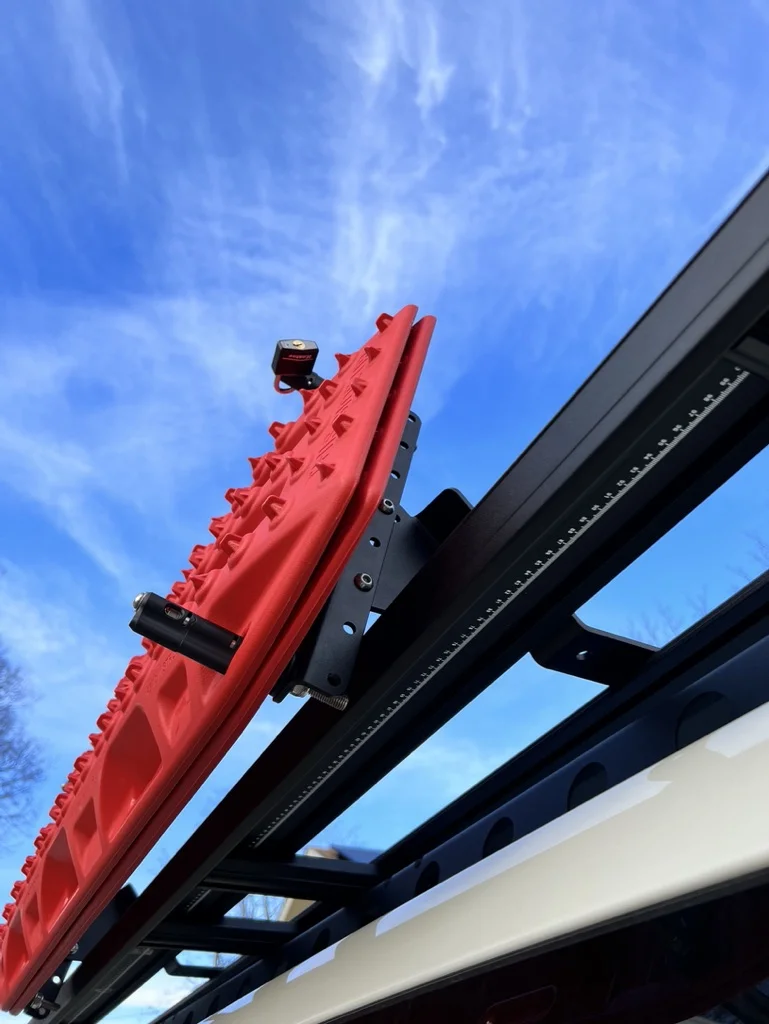

Finally finished up my adapters plate and bought tamper resistant hardware to mount the FrontRunner Max Trax brackets to my Prinsu. Simple design that allows me to still keep surfboards on the roof and is semi tamper resistant overnight. May get MaxTrax lockable pins or may just run a good cable lock through 2-3 of the d ring bolts.
@mcgaskins It must've been your setup that I saw posted previously that got me thinking about just mounting to the factory rack. It definitely seems like the most straightforward and inexpensive way to go.
Since I already have the Maxtrax mounting pins and even some spare crossbars, it would be free.

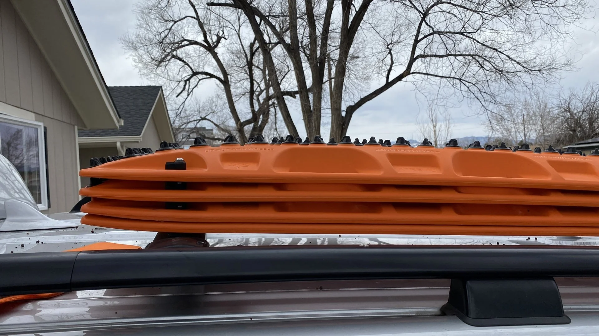

How is wind noise with the Maxtrax mounting pins in place when you are running without the Maxtrax? I'll be running without them more than I will with them.
If I do this, was thinking about replacing the locknut with a wing nut so the pins can be removed when not in use. But if they are unobtrusive, maybe that is a bad idea...
Just a note for anyone that does this with stock bars and plans to remove the maxtrax pins: you may find that you get a whistling noise when the pins are removed. Kind of like when you blew air across the top of a coke bottle as a kid. The easy fix is to cover the holes - I put small squares of automotive vinyl over the holes. Problem solved.

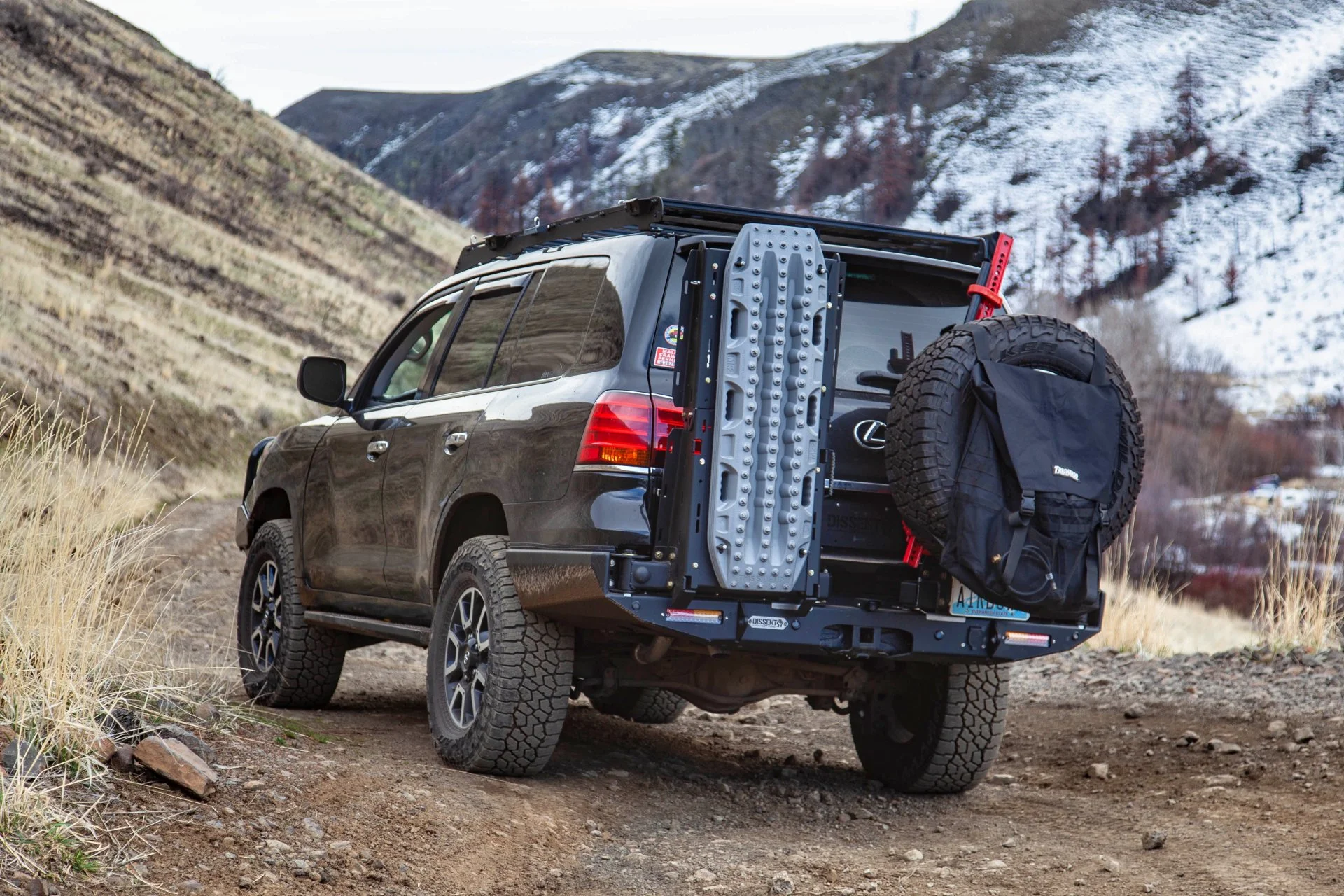

Hey @CharlieS, did you ever build your tire carrier mount? I ended up building a simple roof mount that works but I don't like them there. I think a tire carrier would be better but the ones that look good are expensive (I know, that's how it works).
Not really.
I've tried a bunch of solutions, what I'm using now is a mount from Maxtrax that straps to the spare tire.
I only put it on when I am on a trip and leave it hanging on the wall of the garage most of the time.
I also have a plate solution from Gamiviti, but I broke one of my maxtrax mounting pins (in a rush used a battery tool and galled the hardware) so never got around to trying it in the field. It has potential though.
