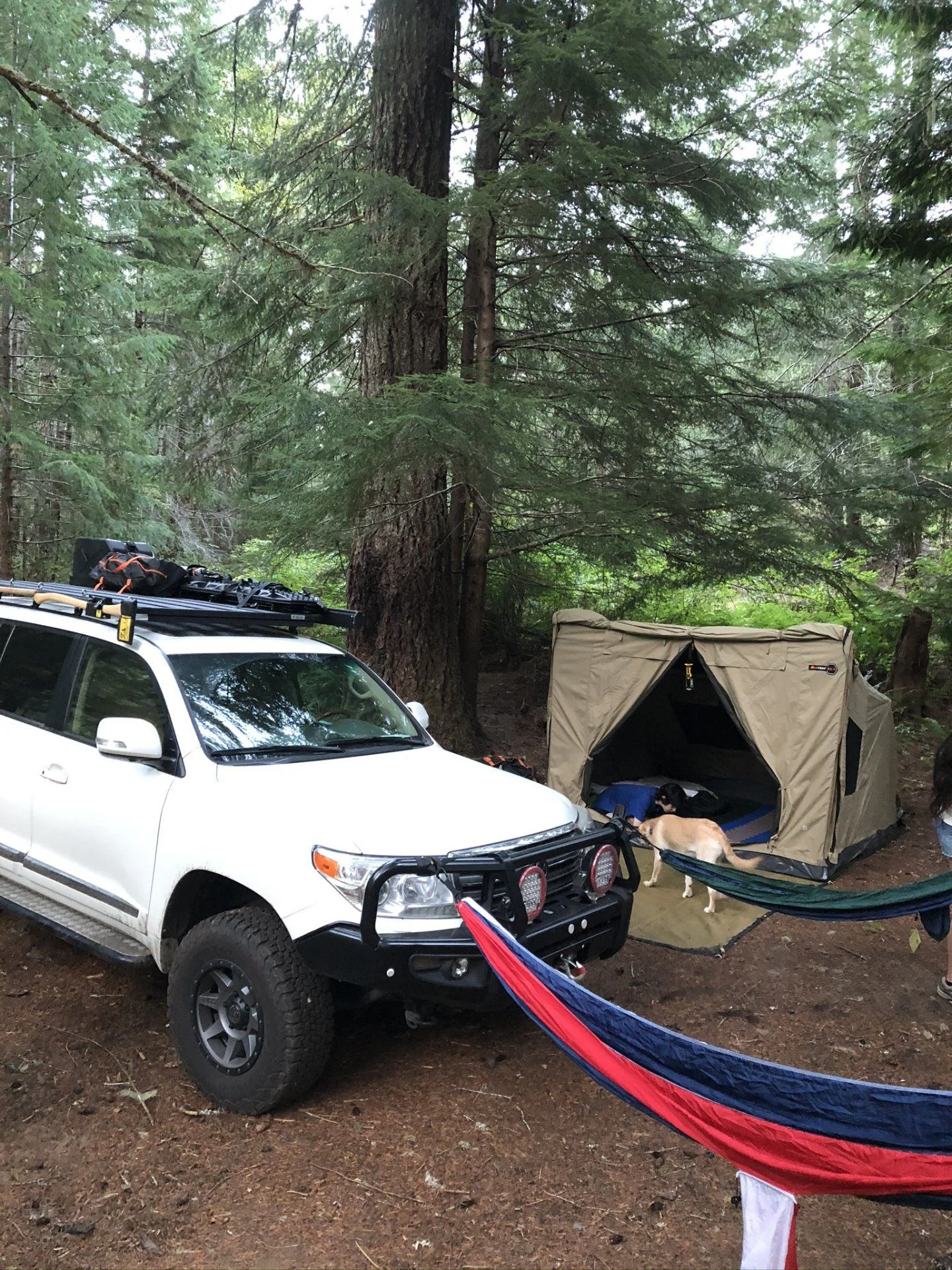

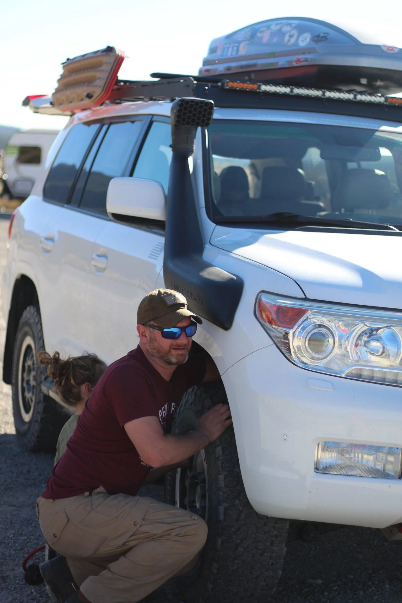

Pictures of your Maxtrax mounting solution?
I could be wrong, but I don't think there is room under the crossbars for two trax.
Likely depends on the cross bars. My Rhino Rack set seems to sit a bit higher than OEM.
But yes, getting two in there will be a tight fit (if even possible).
Here
Yep. Singles sideby side can fit under the OEM crossbars, but not two stacked.

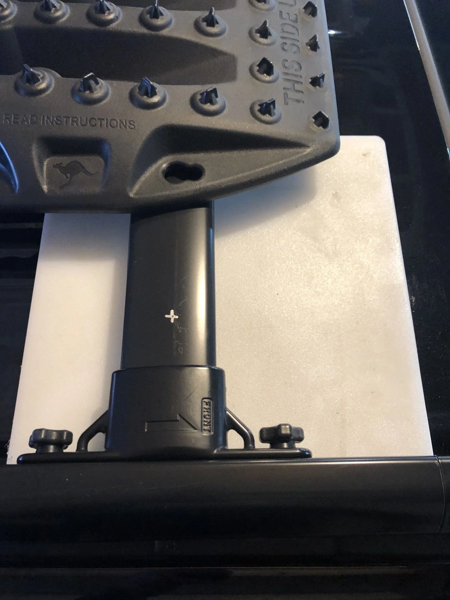

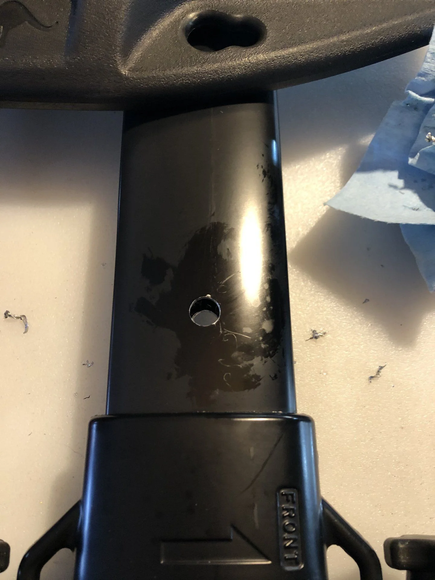

That’s the only thing I have up there, but I doubt it would reduce the weight limit because the maxtrax mounting pin is bolted securely through the crossbar where it’s drilled. I’ve done the same thing on 3 sets of crossbars with no known downsides.
I agree with @mcgaskins. I don't have any engineering knowledge, so I can't say for sure, but it seems like it remains sturdy.

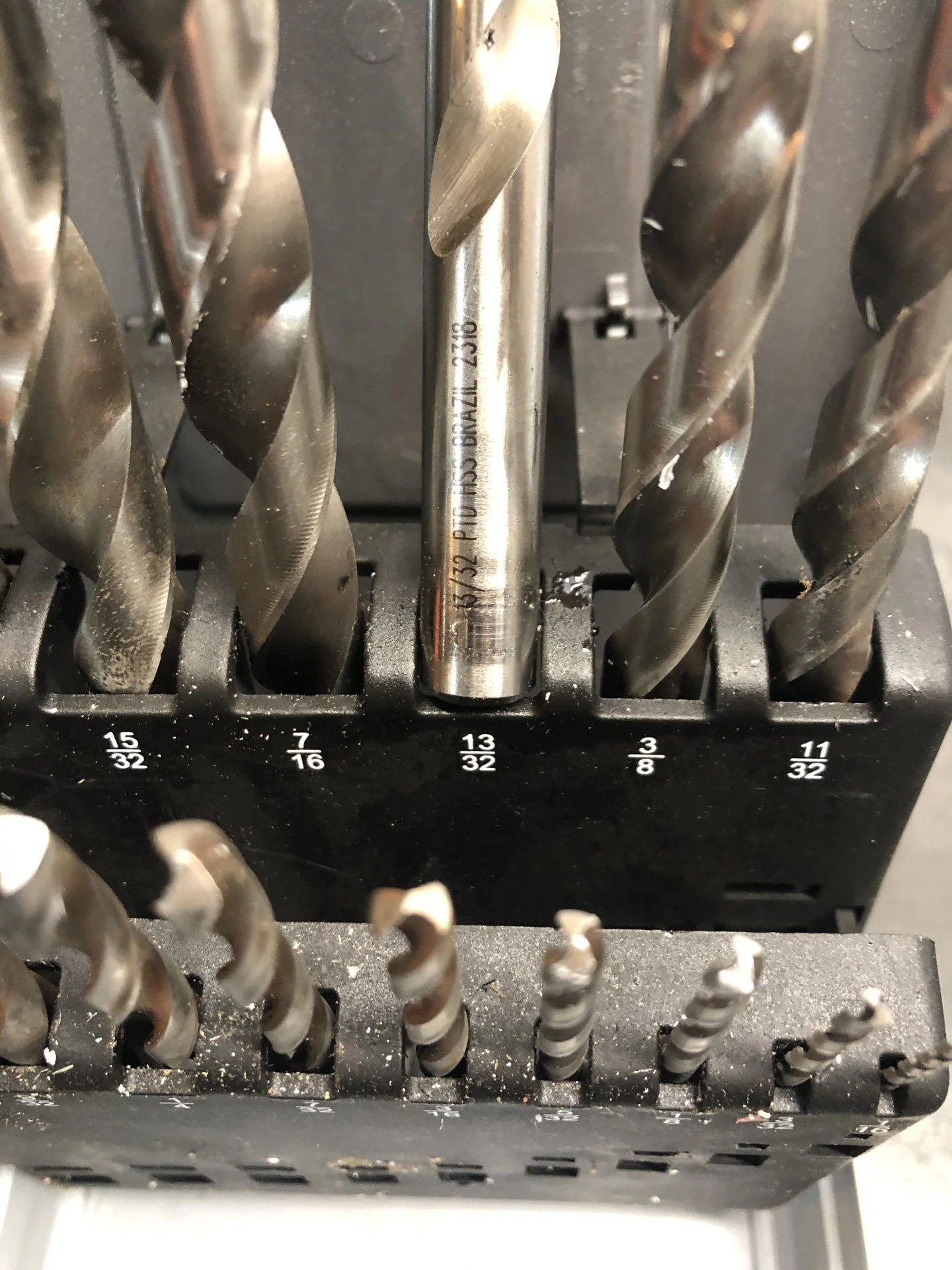

I used three sizes to step up while drilling, but ended up with a 13/32" drill to create sufficient clearance for the posts.
No idea about load capacity issues, but I run a few extra crossbars to spread the load of anything I put up there.
One thing I'd reiterate from mcgaskins instructions is protecting the roof. It would easy for the drill to contact the roof if you don't do this. I think he used some lumber. I used a cutting board that I keep in the garage for things like this - I like it that it is thin so it can fit in small spaces. A "2x" is too thick for putting under the crossbars.
