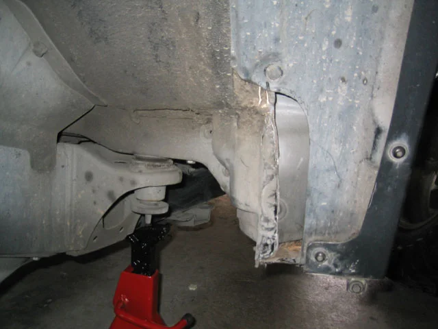

"the cutting i did completely fixed all issues i had with the rubbing."
Tell us more about the cutting? Are you sure you did not compromise the frame?

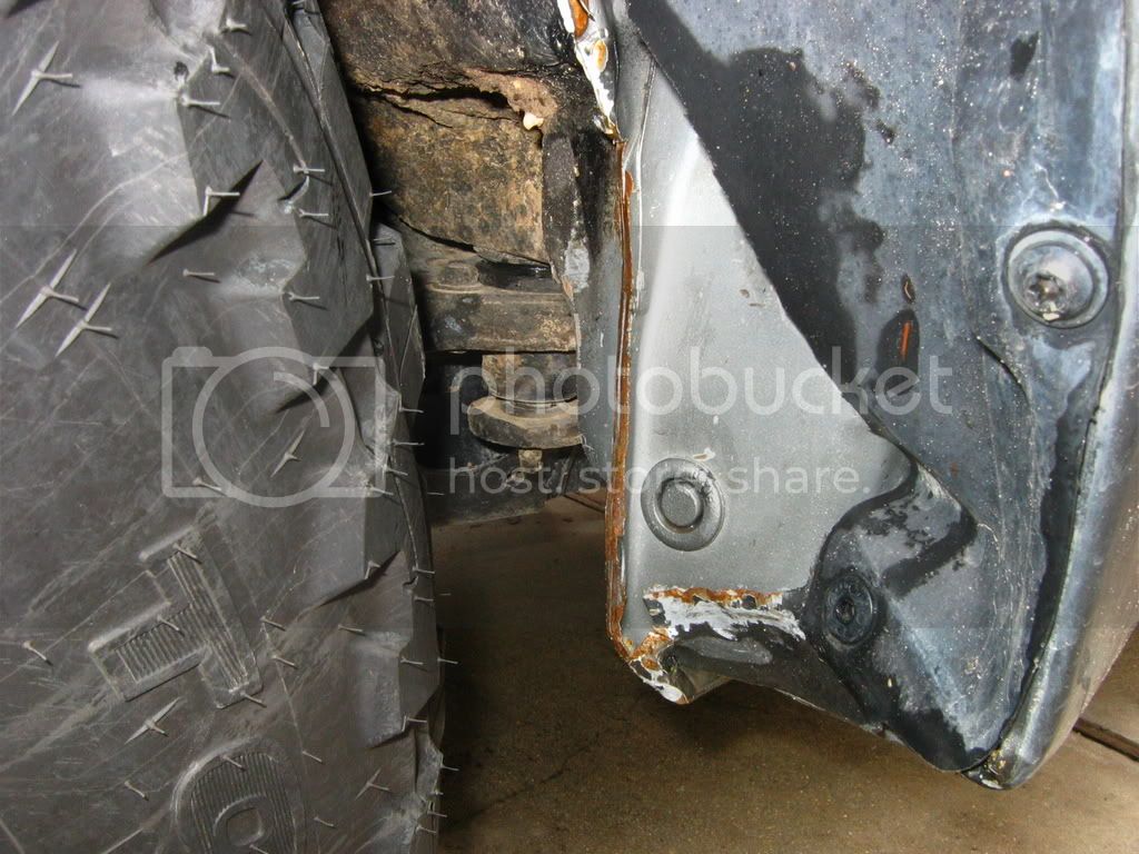

it was the seam weld in the back of the front fenders. its behind that plastic cover thats there. i trimmed the plastic and took the sawzla and cut about 6" long, and around 5/8" to 3/4" off. i believe i might need to get it re-welded as there is now a small "opening" between 2 of the peices there. as for compromising the frame, well the frame is below and around this peice and i didnt cut the frame. this peice is like where the fender, firewall, and the rest of the body all meet and is welded together. as for compromising this peice, i honestly have no idea. nothing is loose or anything. im taking it to a shop sometimes this week to see what they think about it and if it needs to be re-welded. imma post some pics in a few minutes
I understand now, thanks for the insight. Sounds like its not a structural part, but you may want to close it up to keep moisture out and potential rust out. I look forward to seeing your pictures.

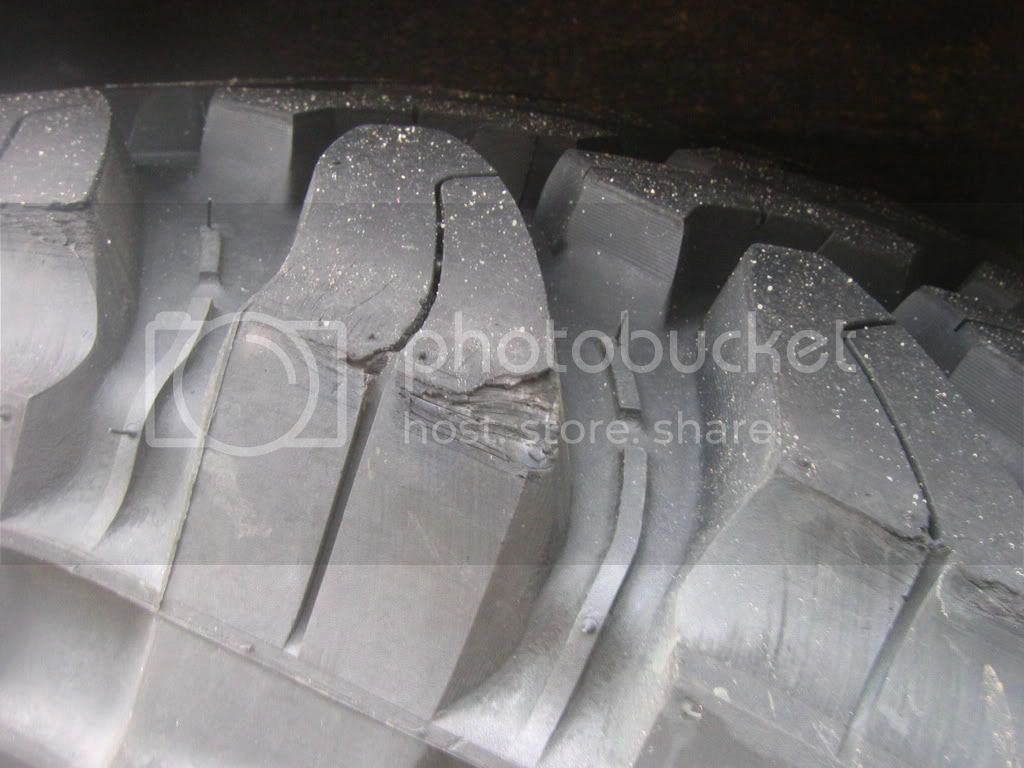

I just noticed this yesterday on my rear-driverside tire. every other tire is fine. and every outside lug looks like this. is this regular trail type wear, or something more? im inexperienced in this stuff and dont really know what to look for on tire wear.

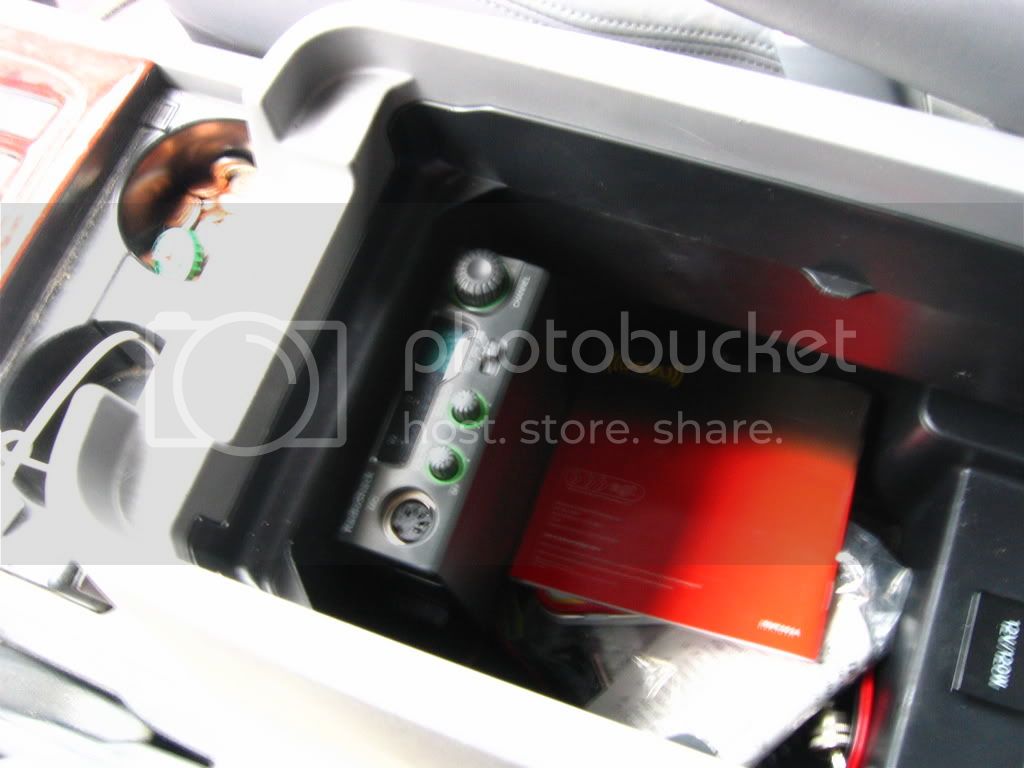

here is my CB Radio mount. the hand-mic plugs in easily and can stay plugged in aswell, just you have to push the top down, instead of just letting it fall to close.

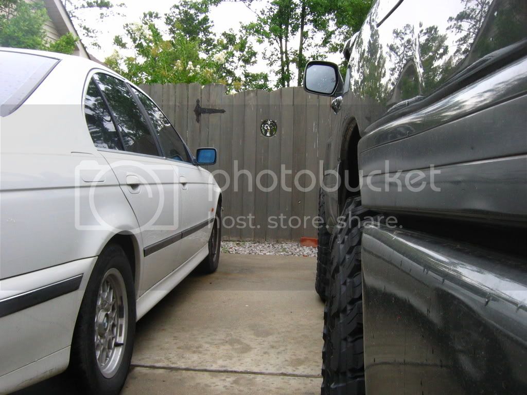

side profile. you can see how far the tires stick out
here is the part i trimmed. please note the rust is just surface rust and it looks a lot worse in these pictures. i will be taking care of this in a few days. the horizontal peice at the bottom i just smashed in with a BFH.

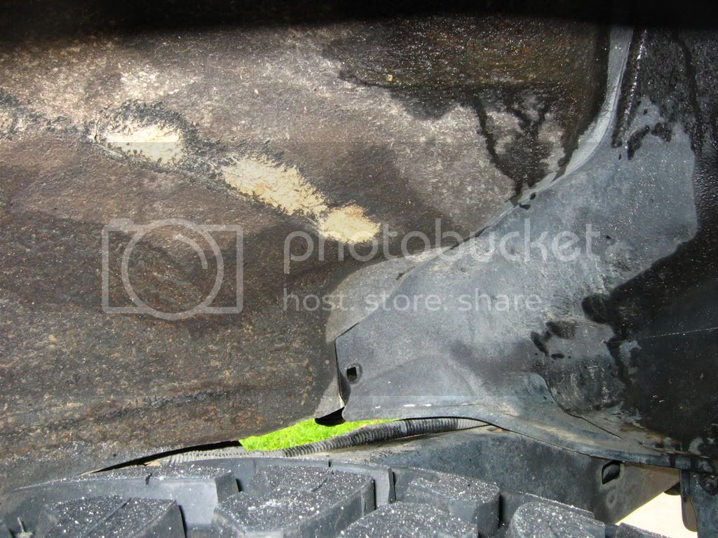

here is the rubbing in the back fenders. it rubs on both sides there and the top, and on the driver side, it rubs that back plastic peice. does anyone know whats behind there? the rear AC? would that rubbing also stop with the lowered bump stops?

The cuts in your lugs don't look like normal trail wear. The way the lugs are sliced it looks like the tire is rubbing on sheet metal. Maybe the spacers (adapters) are causing the problem, though it's strange that it's only on the drivers side.
I've went through 4-5 sets of tires on my 100 and 80's. I see new chunks like his all the time and in varying spots.
its only the driver side rear, and only on the outside of the tire. maybe when it was stuffed in the fender it rubbed on the lip or something. anyways, ill be watching it to make sure it doesnt get worse from street driving.
do you find that wierd to be only that one tire?
could alignment have caused this? is the rear alignment adjustable? could the rear alignment become screwy with the lift?
also a small update: i got the seam welded up today. when i got there i talked to the shop owner/manager about it and when he looked at it he quoted $130 total and said it would probably take an hour a side. that seemed way too much for what needed to be done. he said i could wait a few minutes for the welder guy to come back from a test drive. the guy came and said no problem, and finished both sides in under 10 minutes. now i just need the weather to cooperate so i can clean up the remaining surface rust and shoot a layer of paint on it then it'll be finito
Nice write up. Just wanted offer an alternative to the saw-zalling the pinch welds. You could also knock them back with a small sledge hammer/mall. The end result in clearance will be nearly the same. Though the lowest horizontal portion on mine was cut as well.

that was my original plan, though i did every thing from the smashing, cutting, welding, grinding (though with a dremel + carbid bit, not a angle grinder), and painting all with the wheels still on the car. i couldnt get enough force to smash that seam in with the tire still on so i just cut it. i did hit back the lower corner with a hammer though.
