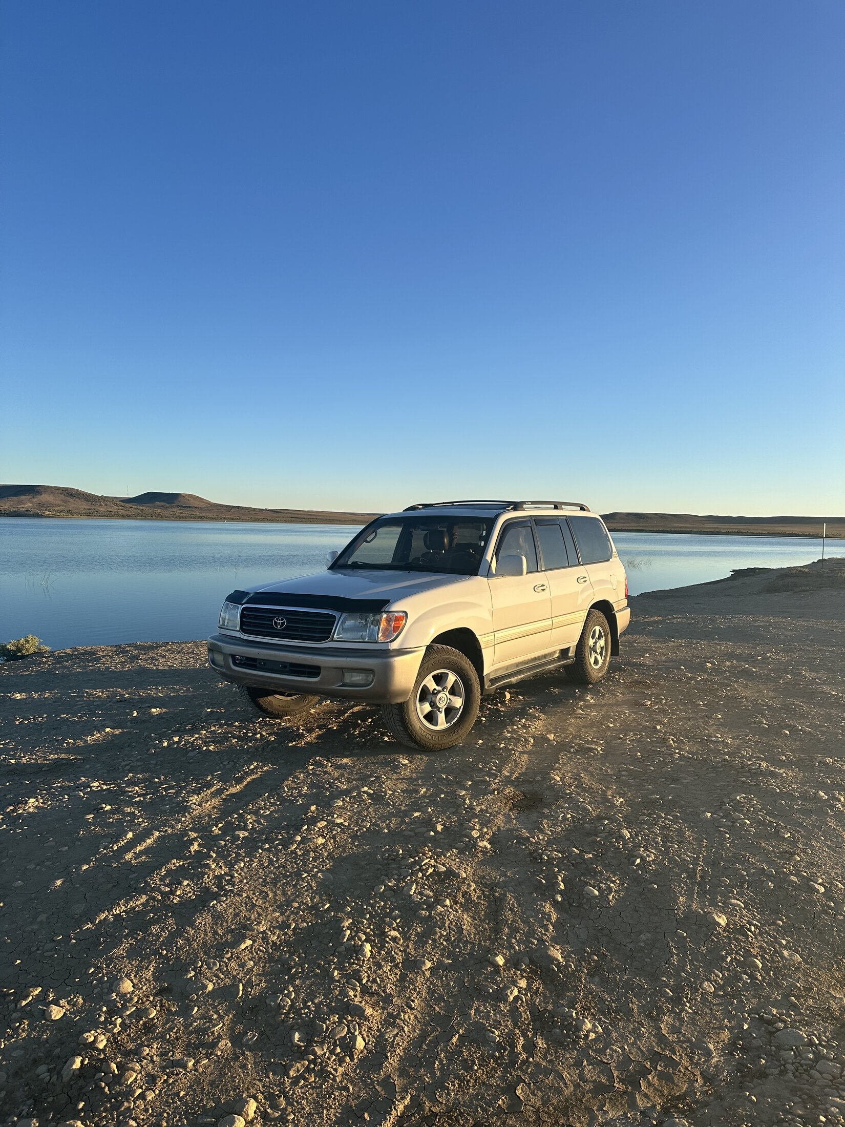

Here's the truck the day I bought it:

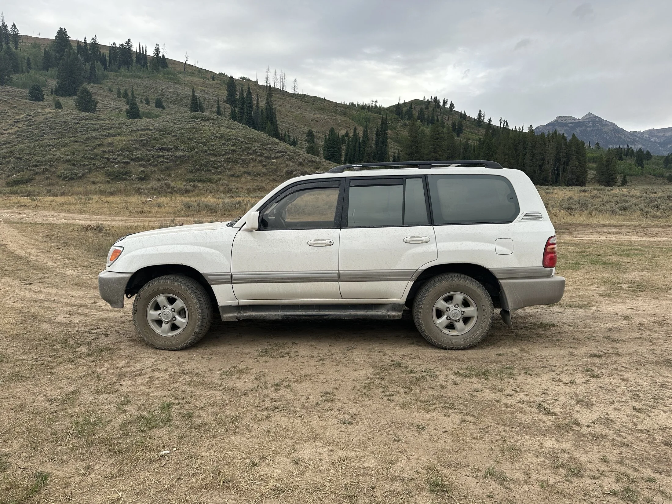

And a couple more from the backroads on my trip:
