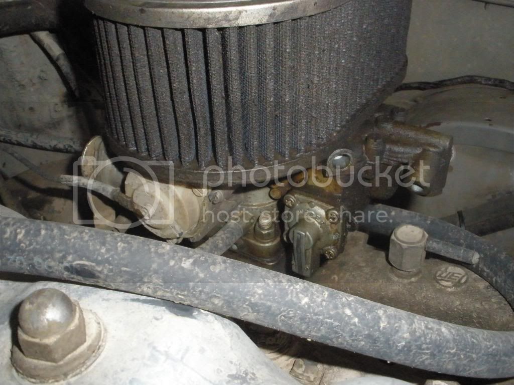

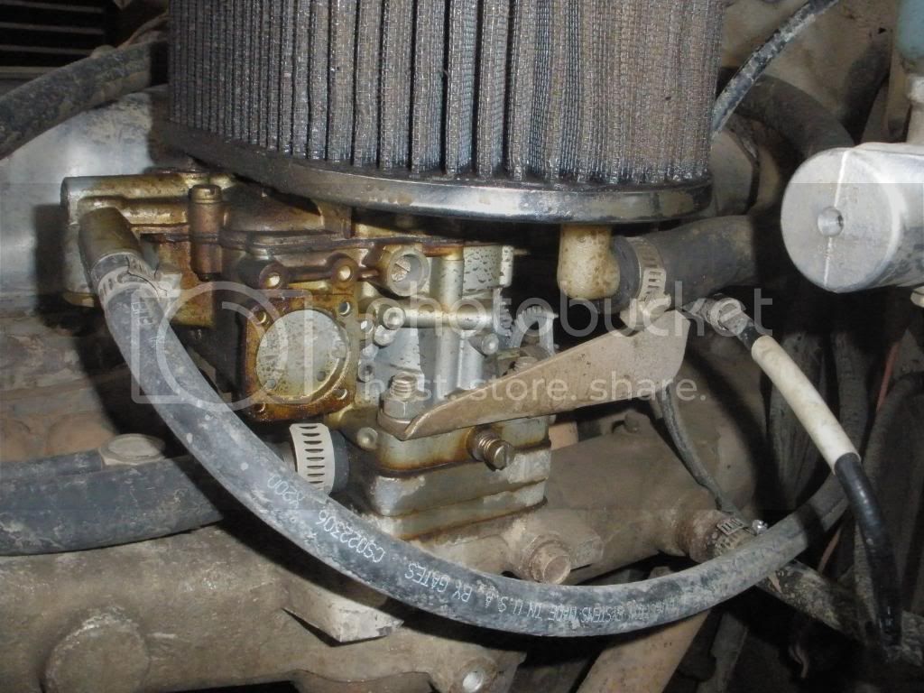

Does anyone have any pics of this? Also what is the throttle return spring attached to? This thing is a nightmare so far - it better run good!
This still may not help, but it is bigger. The return spring can attach to anything that pulls it towards the valve cover.

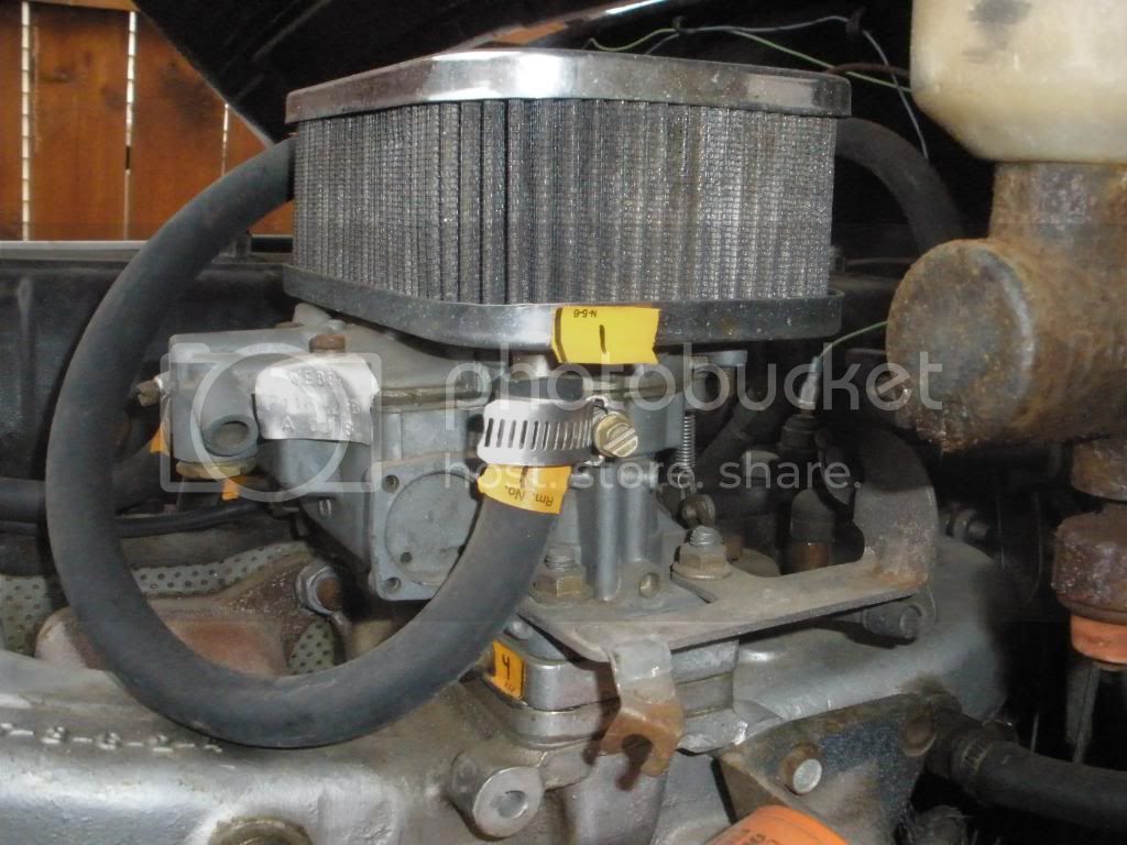

I have a this carb in mine but I am unable to get photo's of it for you right now. My Throttle return spring is connected to a small metal bracket that I made and attached to one of my valve cover bolts. I have the aftermarket cable linkage and pedal on mine. My plan is to go back to the stock carb because I want to get back to a stock setup but my 76 runs pretty good with this carb on it and is my daily driver. I get about the standard 11 MPH in and around town driving. Hope this helps.
