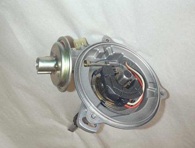

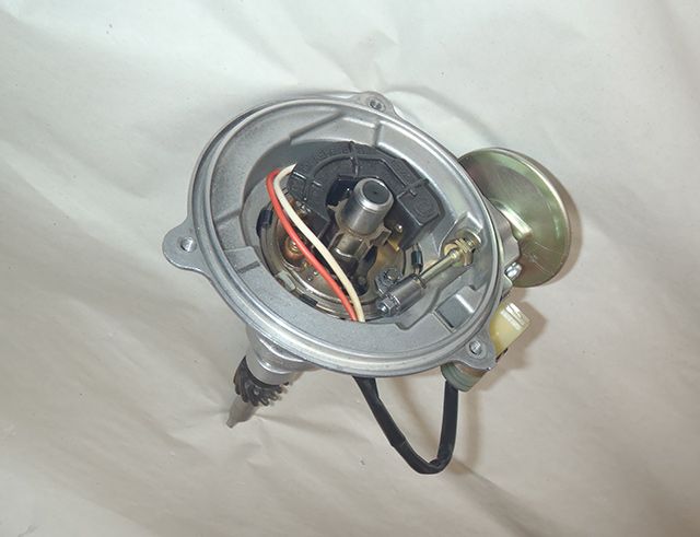

Speaking of Skunk Works efforts, I've finished modifying an FJ60 distributor to 1) replace the dual diaphragm vacuum advancer with a new single diaphragm NipponDenso advancer that has a similar vacuum advance curve to the '77 2F distributor and 2) replace the original signal generator with an early '80s Cressida signal generator. Once my ToyotaPartsDeal order arrives (rotor, distributor cap, cap dust seal, and shaft O-ring) I'll finish the assembly and install the distributor into my '76 FJ40. The '76 already has a stock FJ60 distributor, coil, and igniter, so the installation will be really easy. Signal generator courtesy @ToyotaMatt.
I installed this modified FJ60 distributor in my '76 FJ40 yesterday and took it out for a drive. It seems to drive really well around town, including up some of the steep residential streets. I'll drive it more today on some of the rougher 4WD roads north of town and report back.
I have quite a few more of these new NipponDenso vacuum advancers in stock and available for purchase now that I'm an IH8MUD Supporting Vendor. My Small Business name is Pajarito NipponDenso Ignition Service.
Installation of the advancer requires two straightforward minor modifications to the distributor housing. This modification is well suited to Land Cruisers with the earlier 2F engines that don't have the high altitude compensation (HAC) system (and therefore no need for the dual diaphragm advancer). This is the second distributor I've modified, the other distributor retained the original signal generator and is working well in another MUD member's '77 FJ40.
