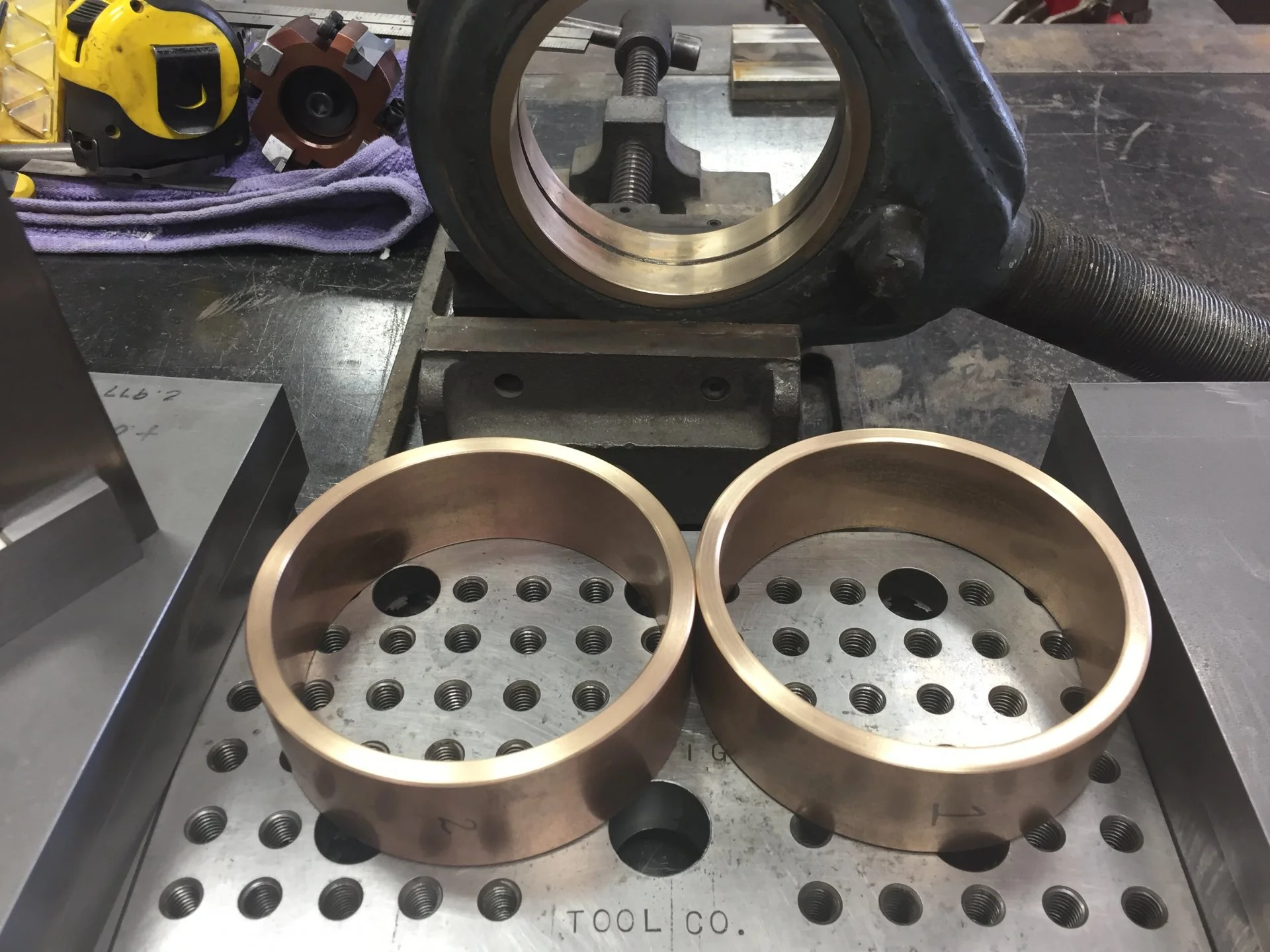

I'll share a couple of shots on machining Oilite and show the how its sweats when friction is applied.
The Oilite bushing I sourced from a local bearing house along with other sizes (no machining required).
This particular bushing has a 4" ID and came in 5" length. I needed two for the Dries& Krump break. The break manufacture is still in business but they quoted me $80 each plus shipping, these are not Oilite material . I ordere the larger single Oilite from the bearing house and made the two I needed for $48 and some left over.
Here, I'm cutting a slight bevel prior to parting.
The two new Oilite replacements. In the backrounf you can see the original still in the large link. Its made from bronze and had a oil groove machined into the middle. The link has a small hole for lubrication that lined up the the groove.

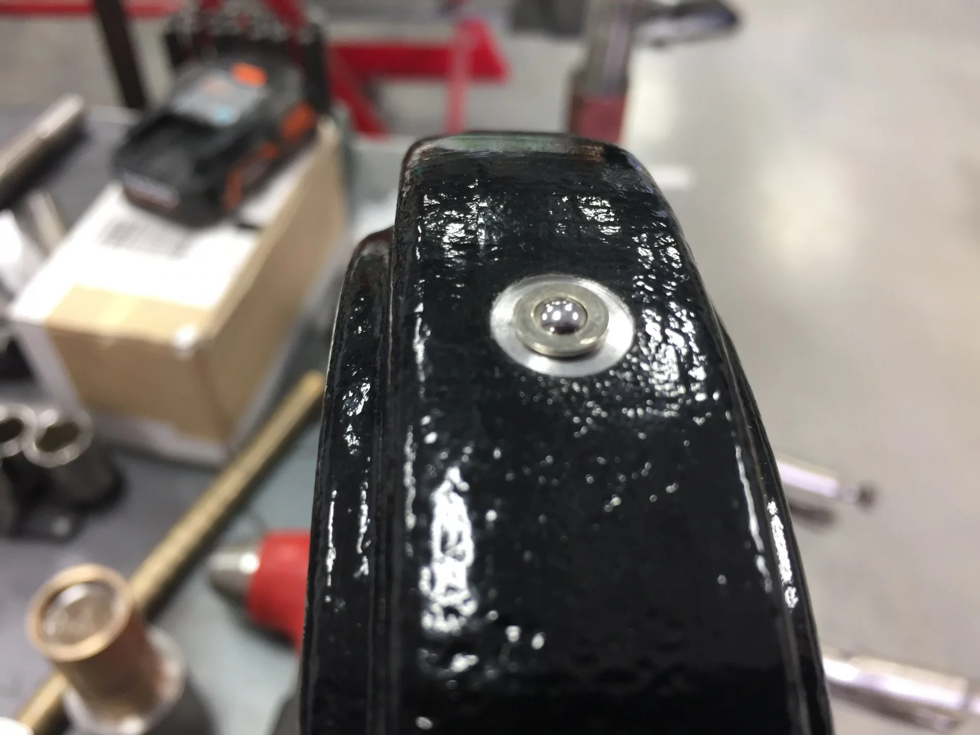

After removing the old sloppy bushing (from lack of oil) the new Oilite bushings were pressed in after the link was blasted and painted.

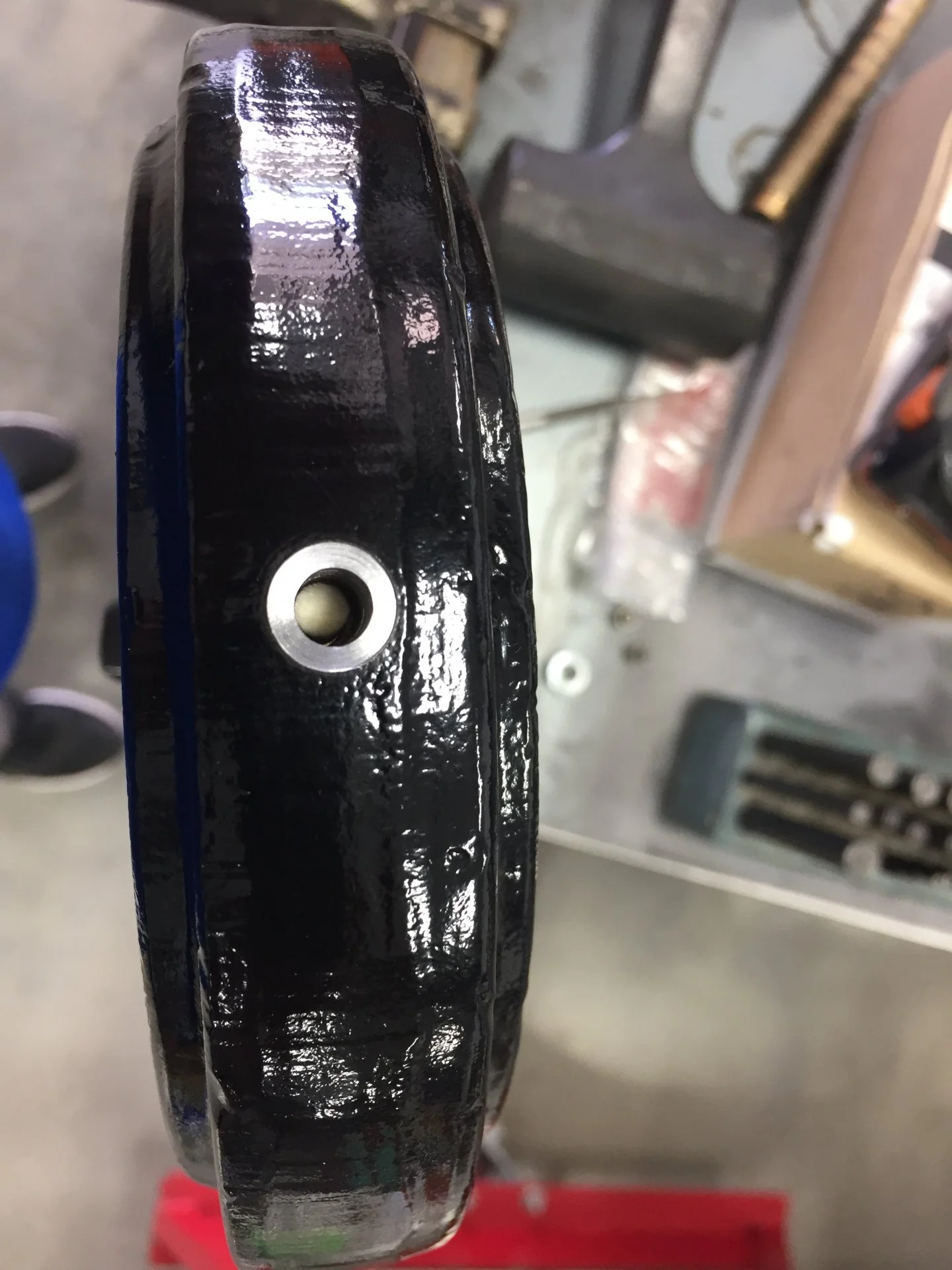

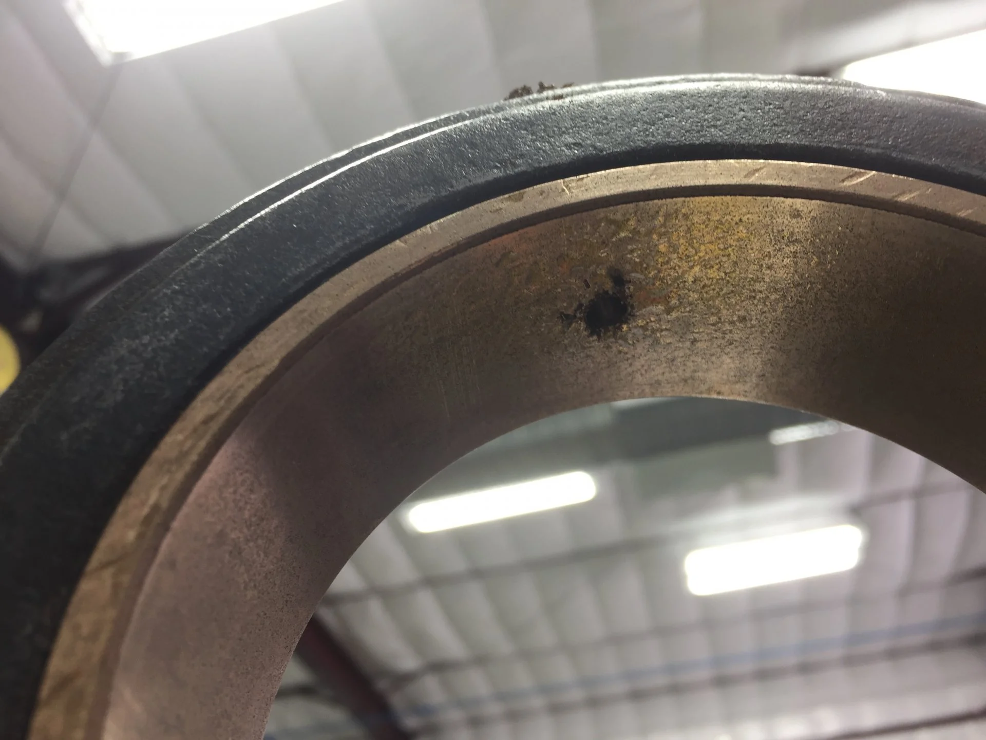

The photo you see shows were I drilled a small hole. Look closely and you'll see the oil that sweated out during the drilling process. Drilling took less than a minute as you can imagine but the amount of oil speaks for the Oilite. Once the bushing temp was normalized the oil was reabsorbed. You see why I wouldn't recommend this for a higher RPM application.
The original oil hole on the links were opened up to accommodate a ball oiler. The white thing inside the hole resembles a cigarette filter. The idea is to soak the inset via ball oiler to keep a slight drip on the new Oilite bushings to flush out ware particles during use.
The ball oiler installed.

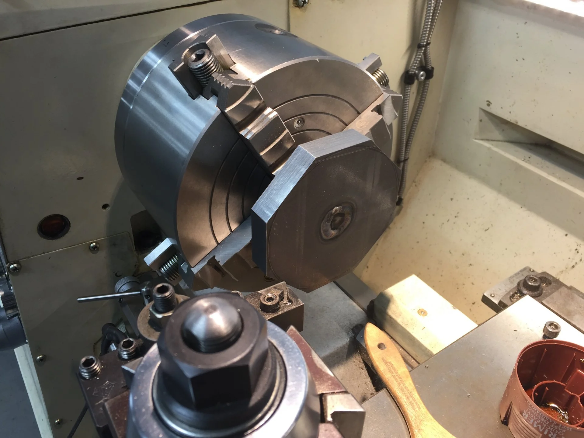

Speaking of interrupted cutting here an examples of turning 3/4 CR on a lathe using an CNMG432 in a 3/4" sq holder.

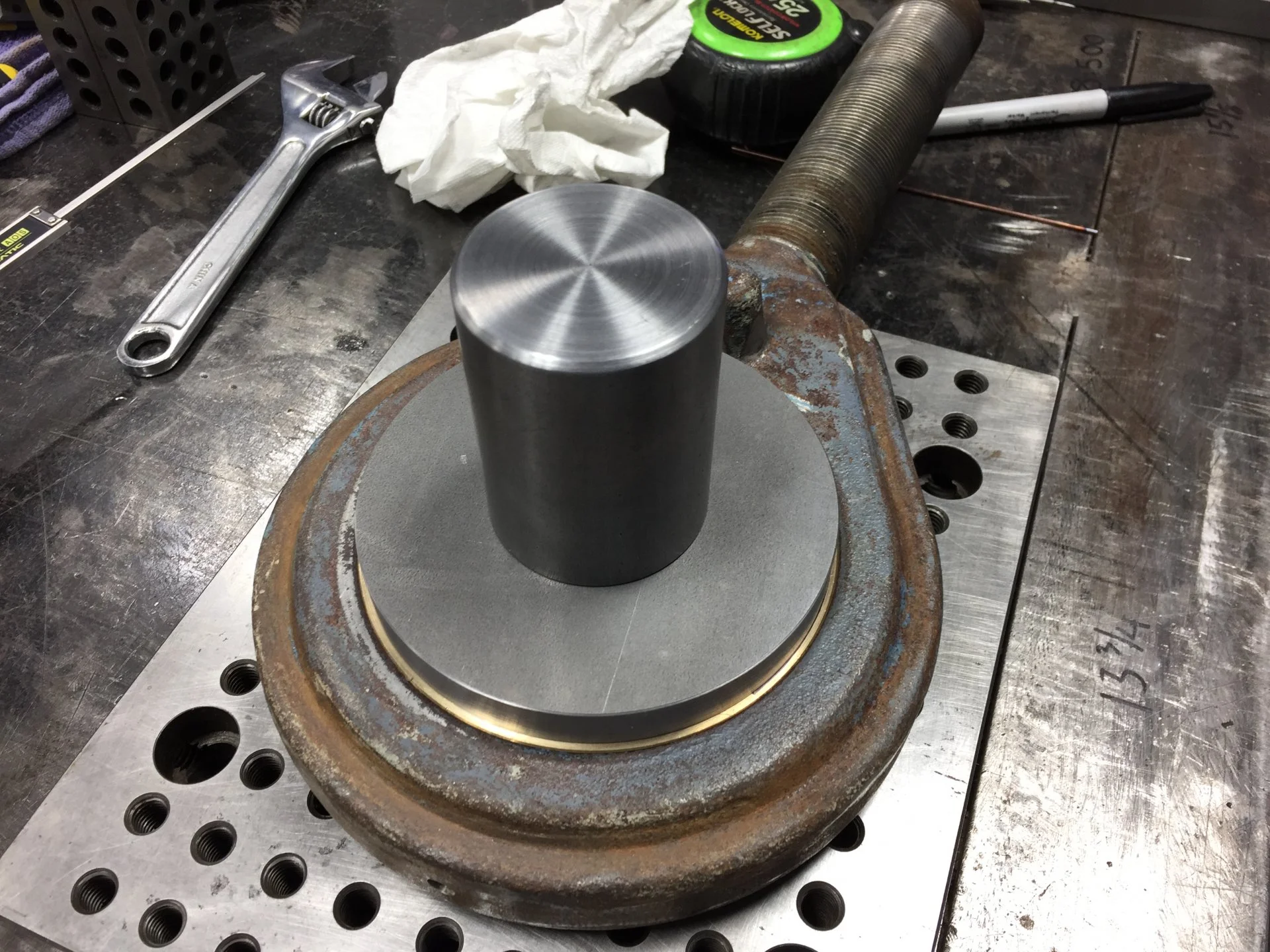

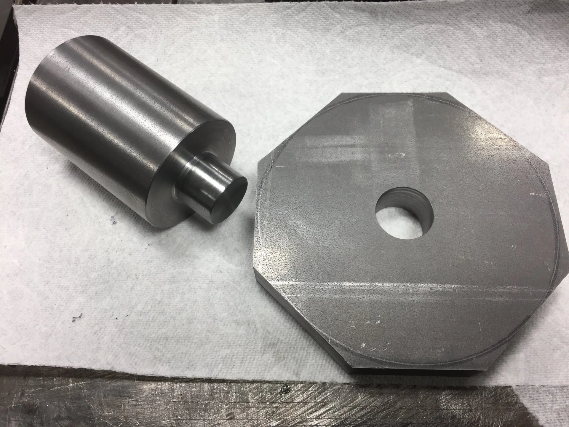

This was the press tool I made to assist in pressing out the old link bushings and pressing in the new Oilite bushings.
The blank was cut on the band saw.
After machining the arbor a hole was drilled to mate the two as one.
The weld set up to keep things square.
Ready for interrupted cuts. The Depth of Cut (DOC) was .060 per pass at 550 RPM with a very nice surface finish the carbide insert has a rounded nose not pointed.
No drama cutting but the set up is fairly rigid. Im running an Aloris CXA QCTP that supports 3/4"insert holder. This lathe was my older 1440.
Just wanted to show interruption lathe cutting. This operation can be frustrating on a machine laking rigidity.

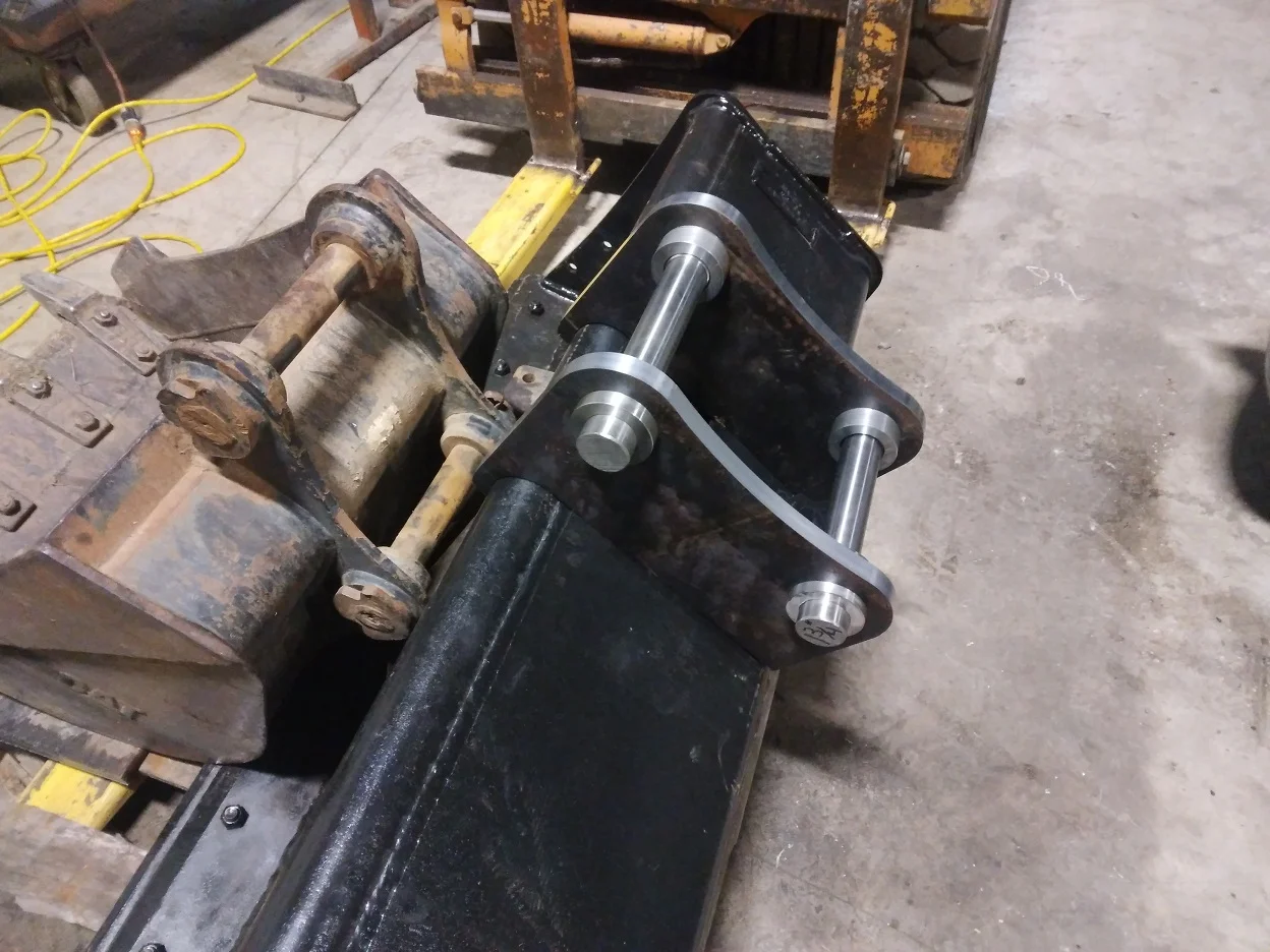

Here's a 48" bucket coupler I made for a friend yesterday morning. The pins are 1.75" prehard, the bushings are 2.75" 4140N and the plates are 3/4" A36. The pins are necked down in the center 6" to 40mm to fit the quick change on the machine. All that lathe work was done in about an hour on a 14x30 15HP 4 ton engine lathe from the 1950's. The longest time was spent drilling 1-5/8" through a combined 10" of 4140 to make the bushings. The rest was quick with decent tooling and a heavier machine.

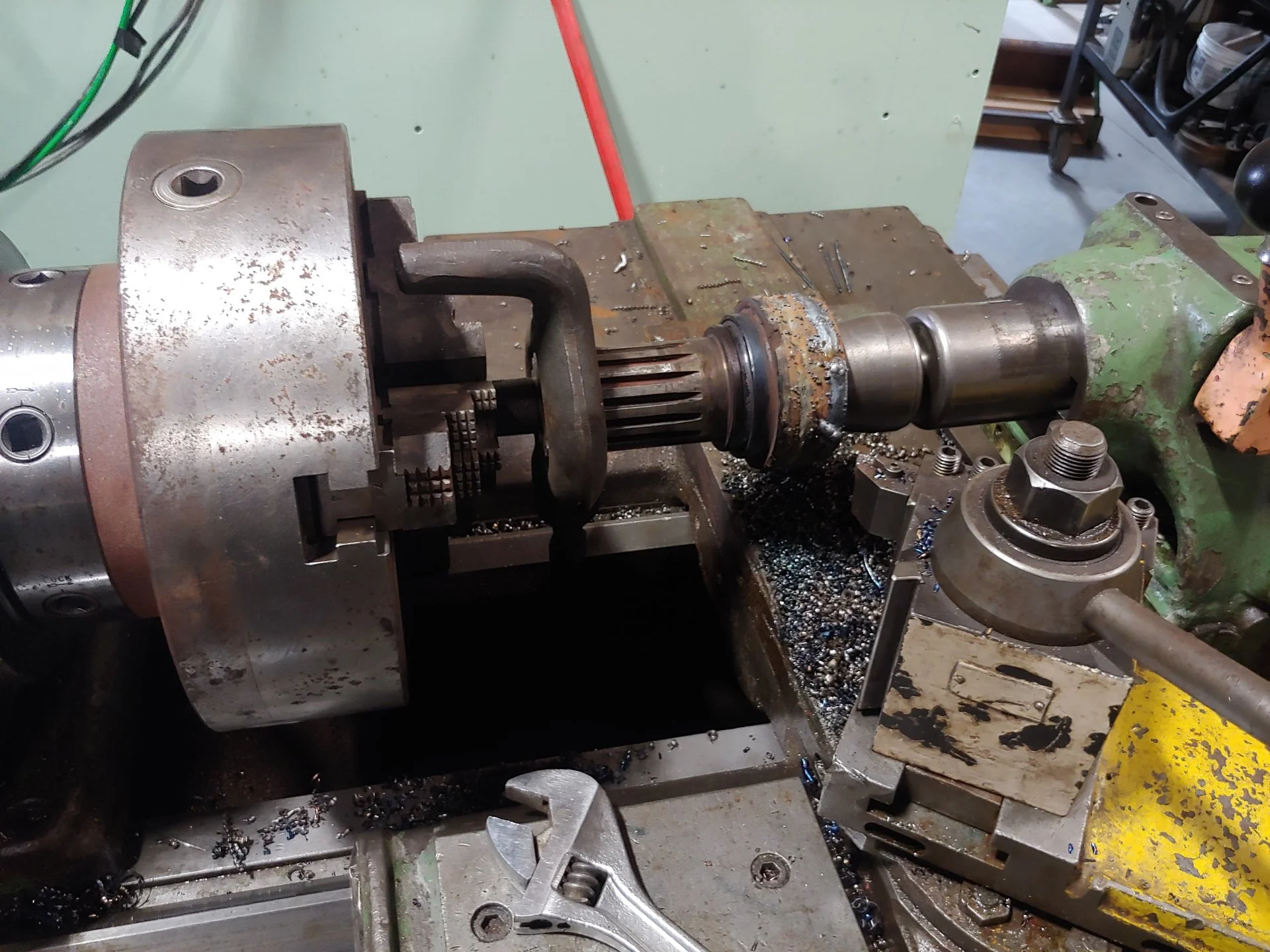

This is dog turning a short shaft between centers. That shaft is the center support bearing for an 1810 dumptruck driveline that was bent when the driveline exploded. It had to be torch straightened, built up with weld, new centers cut in alignment with the old splines and then the OD turned to keep the tube concentric with the splines. That was done on a Sunday while the truck owner waited for $300/hr. Good lathes make money.
You can't see it in the picture, but there's a penny in there protecting the splines from the grub screw in the dog.
