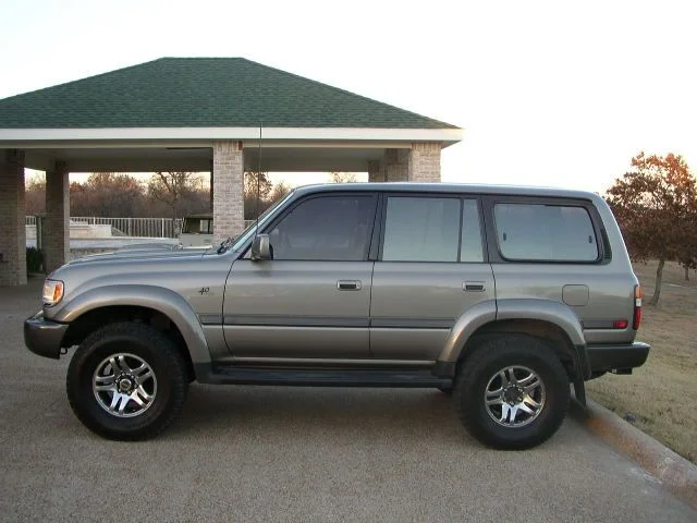

photo request : fj80 w/lift and 35"-ish tires
1994 2.5" 35ish
you are THE MAN! that's eggsactly my truck with the setup i like.
what kind of tires and springs/shocks?

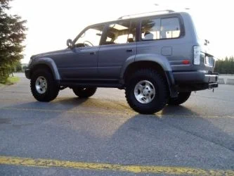

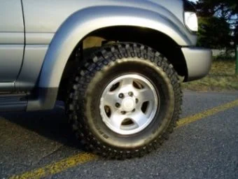

N70 and N71E shocks
851 and 860 coils
BFG All Terrain T/A KO 315\70\R16
Sorry about the huge picture, I can't seem to get it to resize. N/M finally got it!

How much rubbing do you get with that setup?
I generally just play in the sand, so I have had no problems at all. The only time I had any rubbing was when I had it loaded with about 2000 pounds of dirt in the back.
