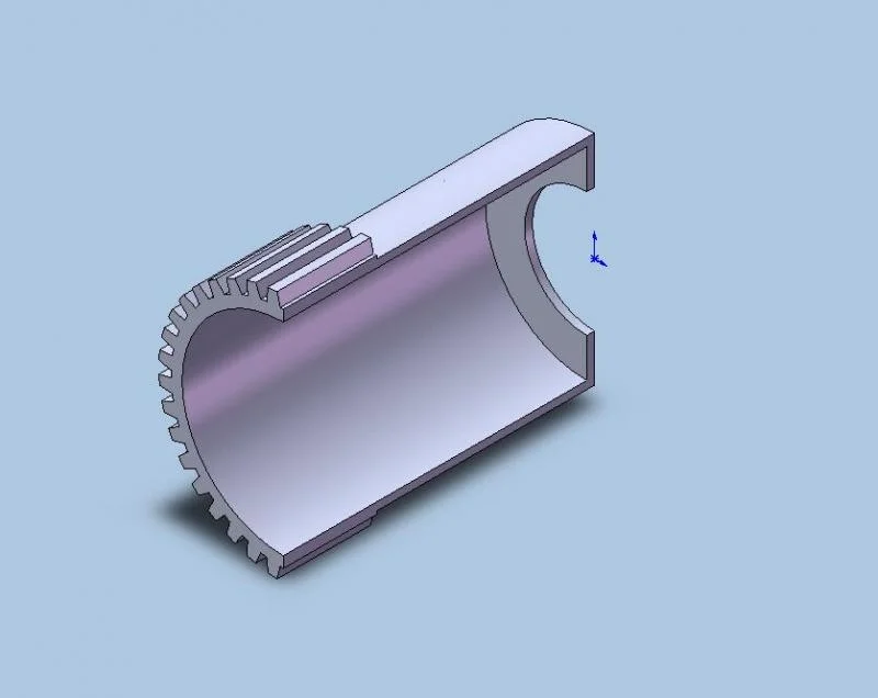

My split-case is gone, so I've no reference for the design details. From what I could find in pictures on the net it looks like there is a nut on the rear of the input shaft that clamps a bearing & possibly more onto the shaft. Seems like a 'washer' with a tube welded to it's OD could project back and carry a welded/bonded-on tone ring. The tube would need to have an ID large enough for the socket for that nut to fit inside of, and that might kill the idea. Dunno. Something like the attached?
Awesome idea. I hadn't thought of something like that, but it should work really well. And it will be an easy install as well. I'll have to look into the dimensions of the nut and socket and such, but I think it should. I'll have to model the part and see what I can get for prices locally to do the machine work. I'm not at school right now so I don't have access to any machine tools :meh:

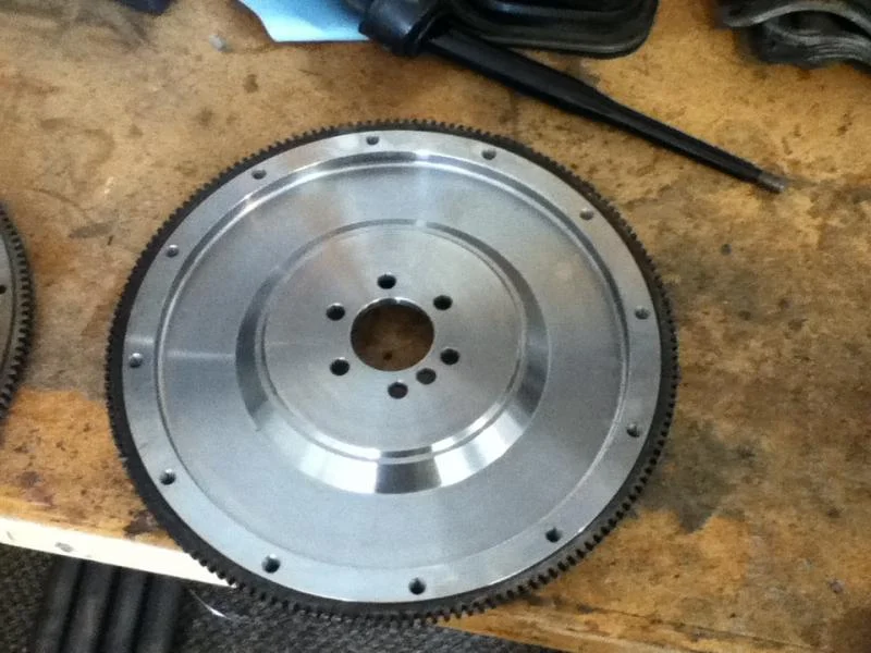

Sometime during the fall, pulling into my driveway after an afternoon of biking, my clutch went out. Somehow the slave cylinder over extended causing the clutch fork to end up lodged in the bellhousing and brake fluid all over the driveway. I determined that my using the LS1 flywheel was actually incorrect for this application, due to the difference in flywheel mounting location between LSx motors and a SBC. The use of the larger pilot bearing allowed the input shaft to be located and supported properly, unlike the small pilot bearing the old SBCs had. The purchased conversion flywheel had a face offset of .400". This put the clutch assembly in the same position relative to the bellhousing mounting surface as the SBC, so now everything fit how it should.
Here is the difference in flywheels:

I'm not sure I'm following what you did to the flywheel? Did you shave it .4"? I'm having a problem with my clutch slave not engaging/disengaging as nicely as with the 2F/4spd. (I have a Vortec V8, Marks adapter, H55F setup now.)
djawahir, I didn't do anything to the flywheel, I just had to order the right one. What flywheel are you running in your setup? The .400" is additional thickness to the flywheel, so that the flywheel surface, where the pressure plate and clutch are mounted, is in the same location relative to the bellhousing mounts as a earlier SBC. Since all the kits out there are designed for SBC not LSx motors, this adjustment should be made in every situation where an LSx motor is used with SBC adaptors.
Elbert, you can use the stock flywheel as you have a 5.7 Vortec, not an LSx Vortec. the 5.7 still has the usual SBC locations.
Oh, I thought you machined your flywheel to look like that. The flywheel I'm using is the one from man-a-fre: part #700120. Looks like the one in the first picture.

5.7 "vortec" truck engines are not gen III/IV blocks (they aren't the same block as the 5.7 LS1 even though the displacement is the same). 4.8/5.3/6.0/6.2 "vortec" truck engines are gen III/IV blocks and require a different flywheel or spacer to mate to a transmission designed for a gen I block. They otherwise bolt up the same (except for one inconsequential missing bellhousing bolt in the gen III/IV).
