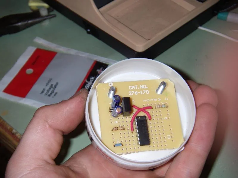

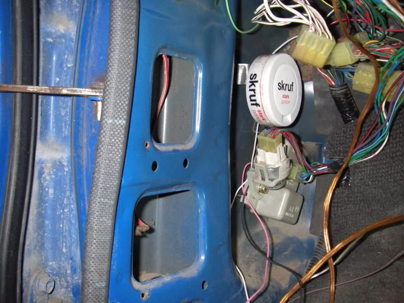

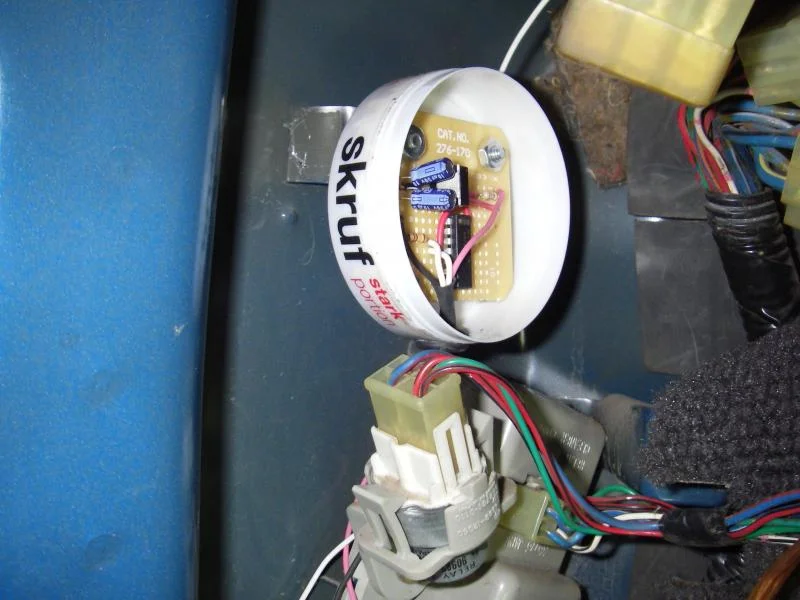

I made the signal conditioner for me tach signal. It wasn't too hard, and buying parts through the EE department at school made it only cost about $5. I'm pretty happy with how it came out, but I haven't had a chance to test it since I don't want to wake the neighbors. Here are a few pictures of the signal conditioner.

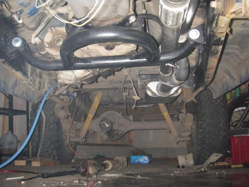

Its been a PITA routing it so that I have clearance with my front drive line. I'm wrapping the passenger side around the front of the oil sump and over to the drivers side. There wasn't really enough room to do anything else, and I might have to extend my bump stops 1/2 in or so. I'll just have to be careful with it until it gets 80 axles under it, since I'll be moving the front axles forward a couple inches. Probably would have been easier if I wasn't using 2.5 in tube too... :rolleyes:
That's good info since I was looking at 2.5"from the headers to the y-pipe too. Do you think dropping down to 2.25" would give you more clearance?
Dropping down to 2.25" would only give you an extra 1/8" on each side of the tube, and I don't think that will make that much of a difference. If I was to start over and do it again, I'd still use the 2.5", but I would design my transmission crossmember differently so I could run the passenger side along the inside of the frame until the back of transfer case.

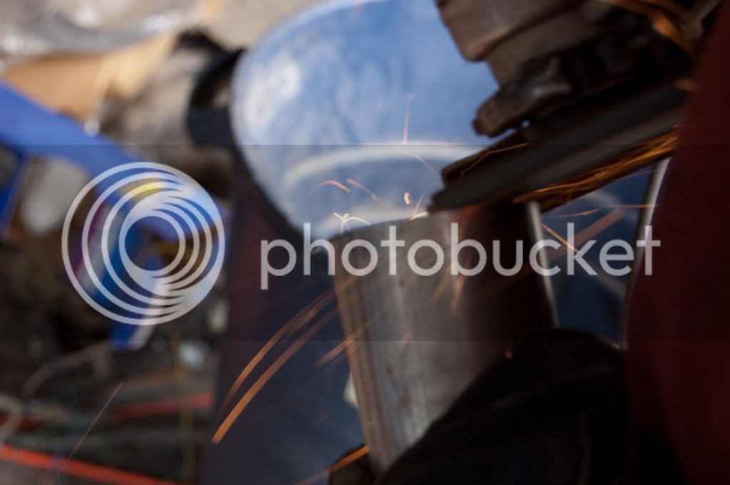

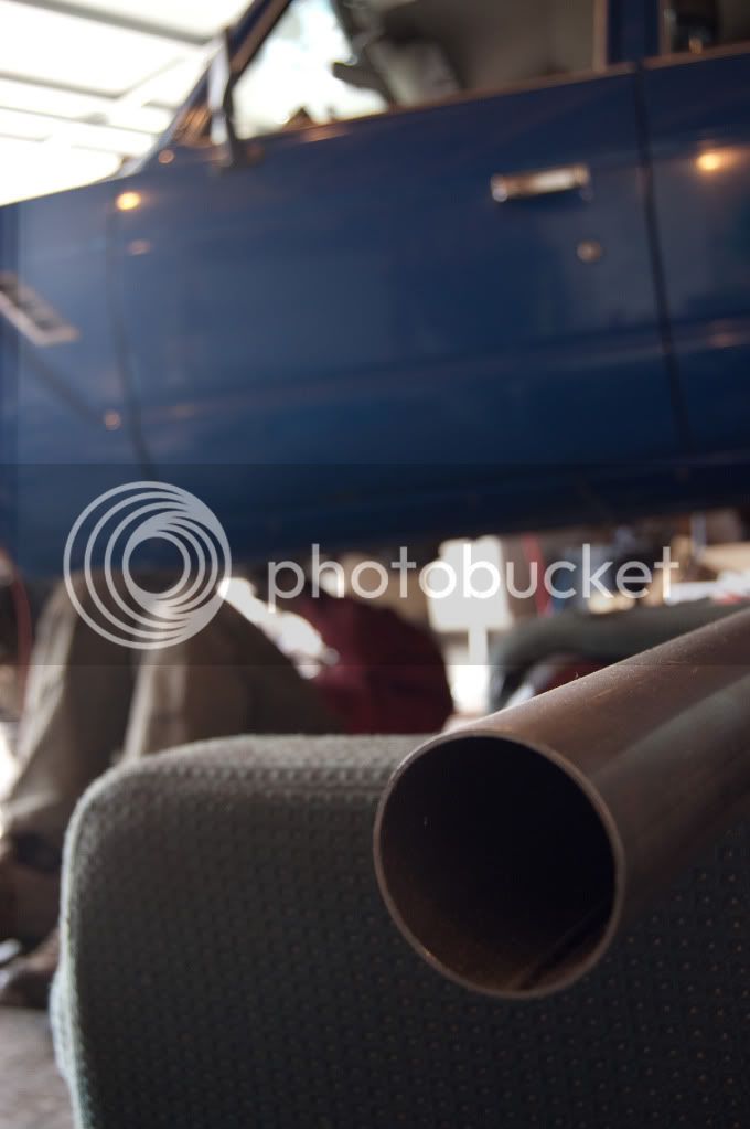

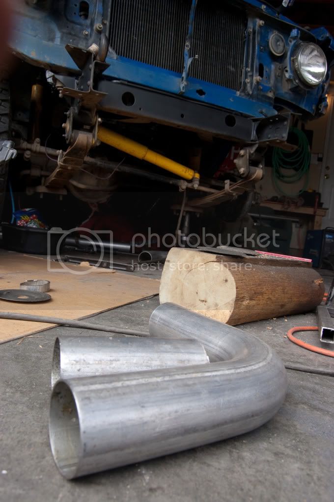

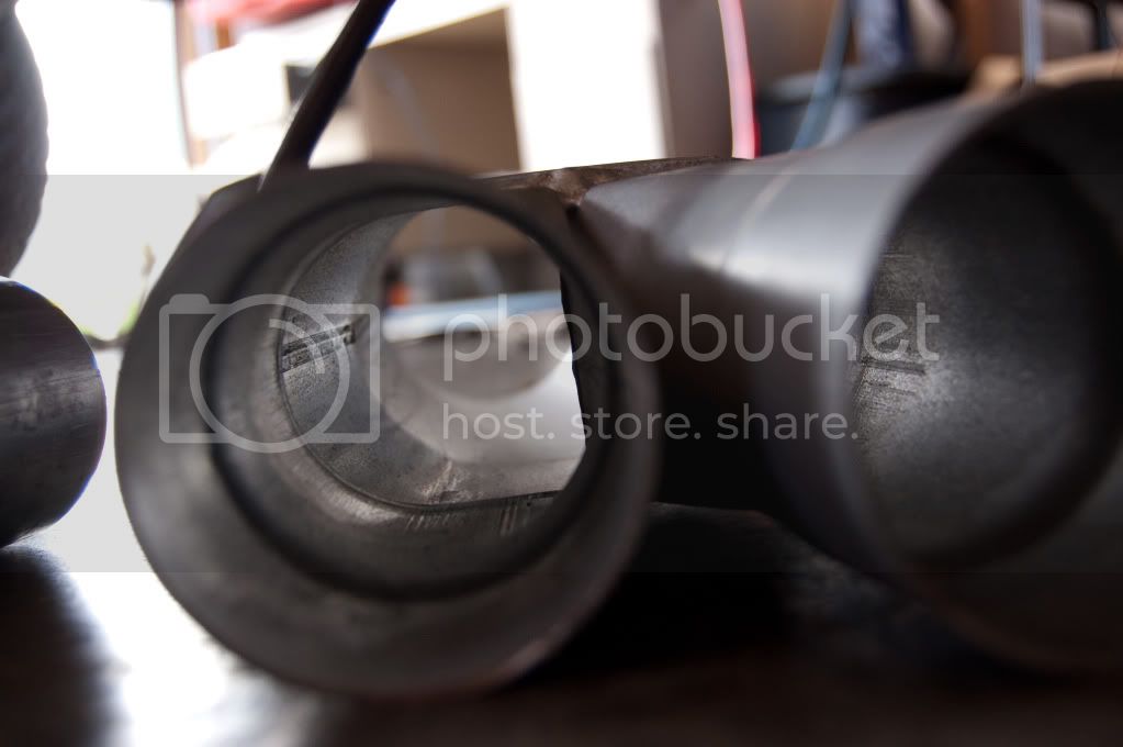

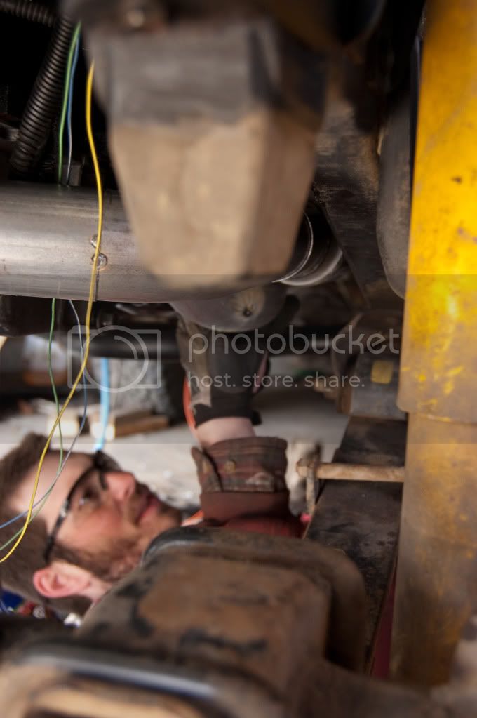

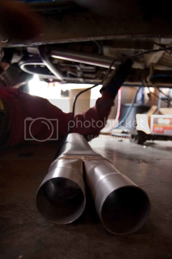

so for a photo essay assignment i had to do for photo class the subject was karl's exhaust. thought id put it on here for s***s and giggles.
Nice, that looks sweet.
finally got the exhaust built. I'm pretty excited about how well it turned out. I just have to put two mounts in on the crossovers and weld it up in the morning.
I understand now what you meant about the clearance on your crossmember being an issue. Looks good though. Bet it'll be nice to be able to start it up without waking up the whole block now :D

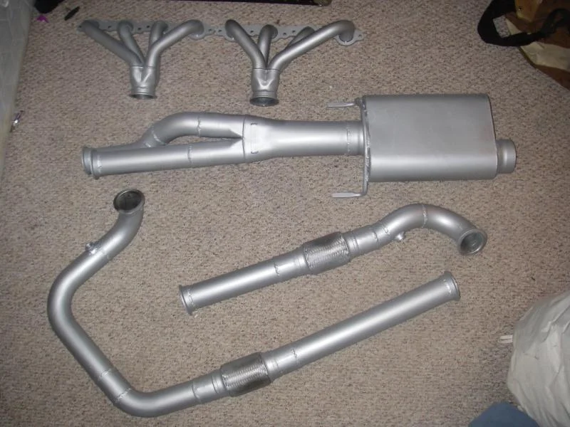

I turned my bathroom into a paint booth since it was cold out and snowing occasionally. Painted the exhaust with some VHT paint, designed for this application. The color I got was exactly the same as the Flowmaster muffler and y pipe I purchased.
Here are all the exhaust parts on my bedroom floor :hhmm: I'm going to just get a turn down for the outlet of the muffler for now. I'll build a tailpipe this summer.
Are you planning on running cats or no?
