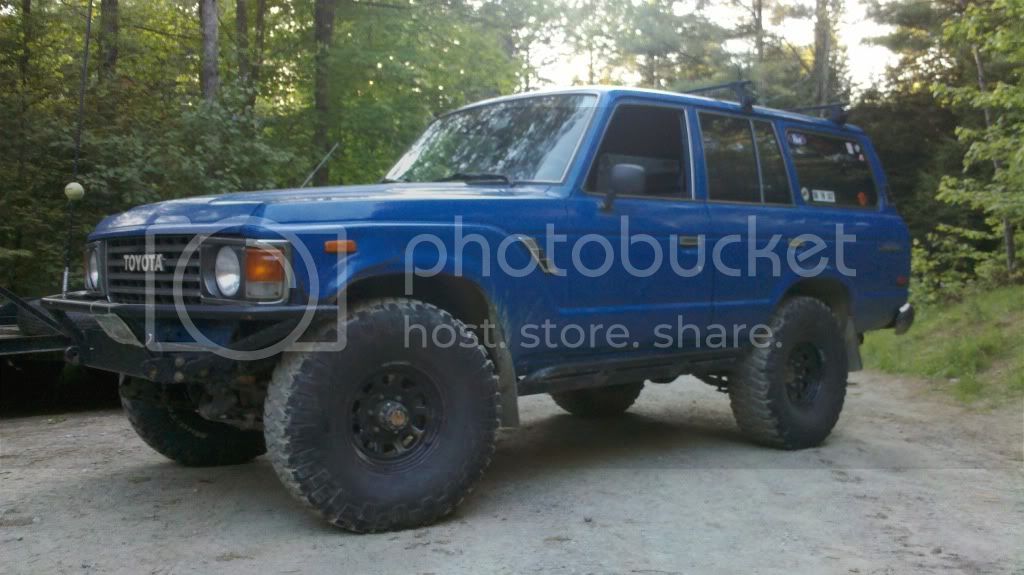

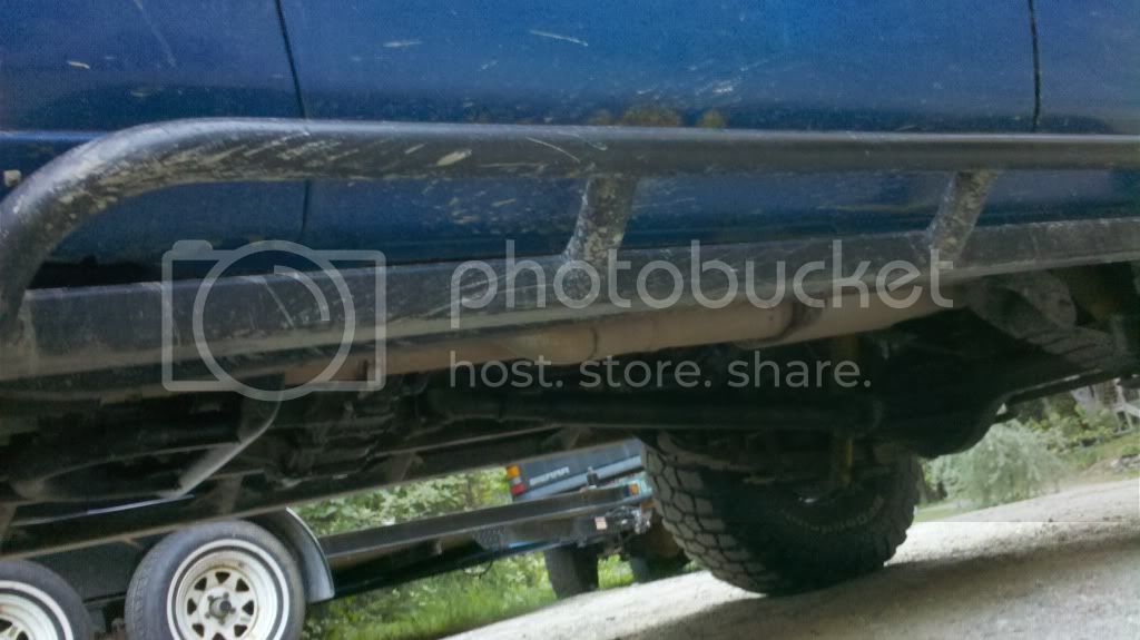

This fall I built myself a set of rocksliders. They are made from 1.75" .120" wall DOM round tubing with a 2x3" .250 wall square tube along the bottom of the rocker panel. I think they're pretty stout.

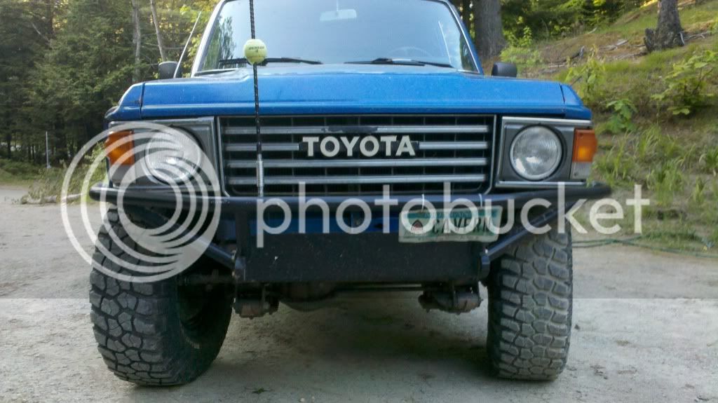

Right before Moab I built a front bumper. It is not complete yet but it is close. Still needs a hoop of some sort and some gussets. It is made from the same round tubing as the sliders, and the winch tray is .250" plate and the mounting points/recovery points are 1x3" bar stock. The bumper is designed to accept a winch. When I get a winch I'm going to cut a slot for the fairlead. In these pictures I have a set of 35" KM2s mounted and I flexed and it looks like I can just barely clear them with the OME lift.
