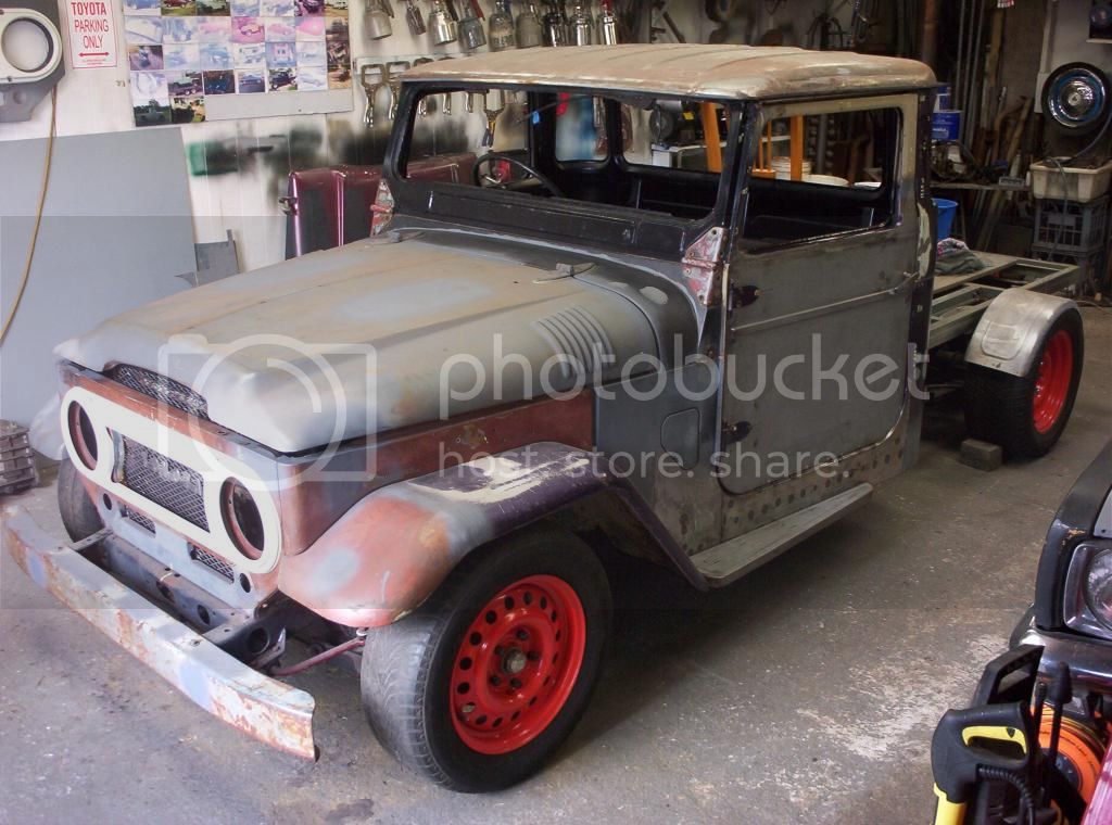

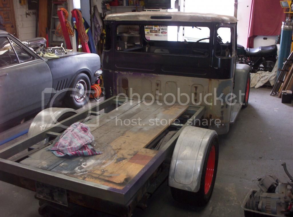

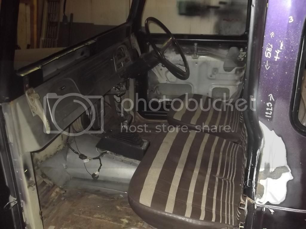

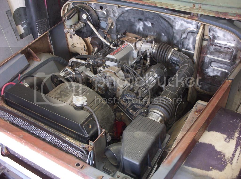

Here's my efforts so far. be no where near as quick as a skyline based one, has injected 3.8 v6 and 4sp auto, but shouldn't be no slouch either:grinpimp:
chopped 3" channeled just over 2"

sweet ride … keeps the classic 40 look, but adds to it … very nice … :)
