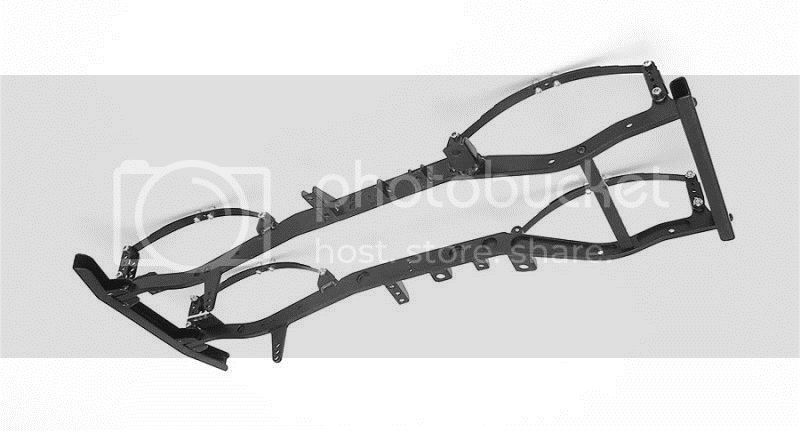

And the more I study these pictures, the more I get the feeling that this COULD be resorted to, for lowering the vehicle to hug the ground...
The FJ40 Frame...
The FJ40 Frame...flipped...
Of course, at this point in time, this is all conjecture. But I do think it's workable in theory. You'd have a very low-slung Land Cruiser, indeed...with a ready-dropped platform for you to mount your body parts on. This would provide for a nice low centre of gravity...to keep your high speed beast stable around bends and curves. At the same time, though, this would also entail reworking the body mounts, engine mounts, spring mounts, reducing the shackle length, some readjustment of the U-bolts, re-positioning the shocks...and may probably NOT just work altogether. But Like uted said up there...isn't facing problems and finding out-of-the-box solutions to 'em, part of the fun? :)
BTW...has anyone attempted such a thing? Physically, or in principle?
Thinking out loud...
The Pros
Low-low slung stance.
Stock frame, makes it cheaper than a custom-fabbed one.
Provides all the necessary mounting points for everything...making it easier to adjust them accordingly, in proportion.
Since it lowers the entire frame, you can still retain decent amount of leg-room and head-room, as opposed to channeling...which raises the floor higher.
Allows you to chop away at everything above the waistline of the car, with more ease, since the floor of the vehicle, vis-a-vis the body panels would remain largely undisturbed.
Actually encourages you to use humongous wheels and tyres with the vehicle...as opposed to other lowered cars which need smaller, lower profile tires.
The Cons
The suspension keeps the frame PULLED aloft rather than keep it LIFTED aloft. A very big con, since it's easier for conventional sprung suspension to do the latter rather than the former.
Uncharted territory...for me, at least.
