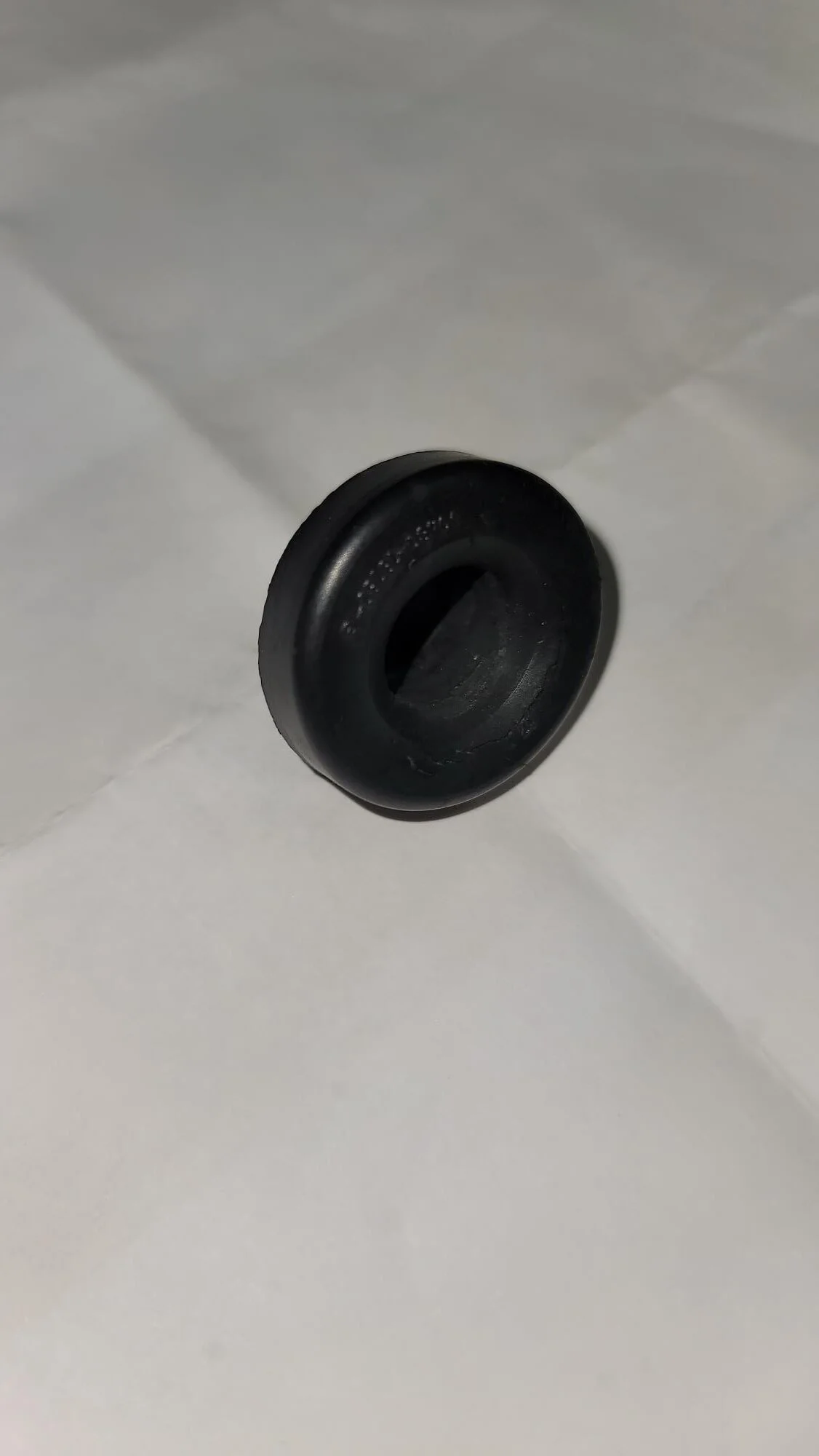

Any tips on removing a petrified PCV grommet?
Thanks
Dave
Its plastic. Its brittle, chip it out. Soften it with a heat gun or dissolve it with a good solvent Acetone or Methyl Ethyl Ketone Peroxide.
Thank you!
The heat gun was the winner. I was able to get it out in one piece with a pair of needle nose pliers.
If its crumbling, I'd grab a shop vac while you're picking at it.
I was lucky... came out in one piece
