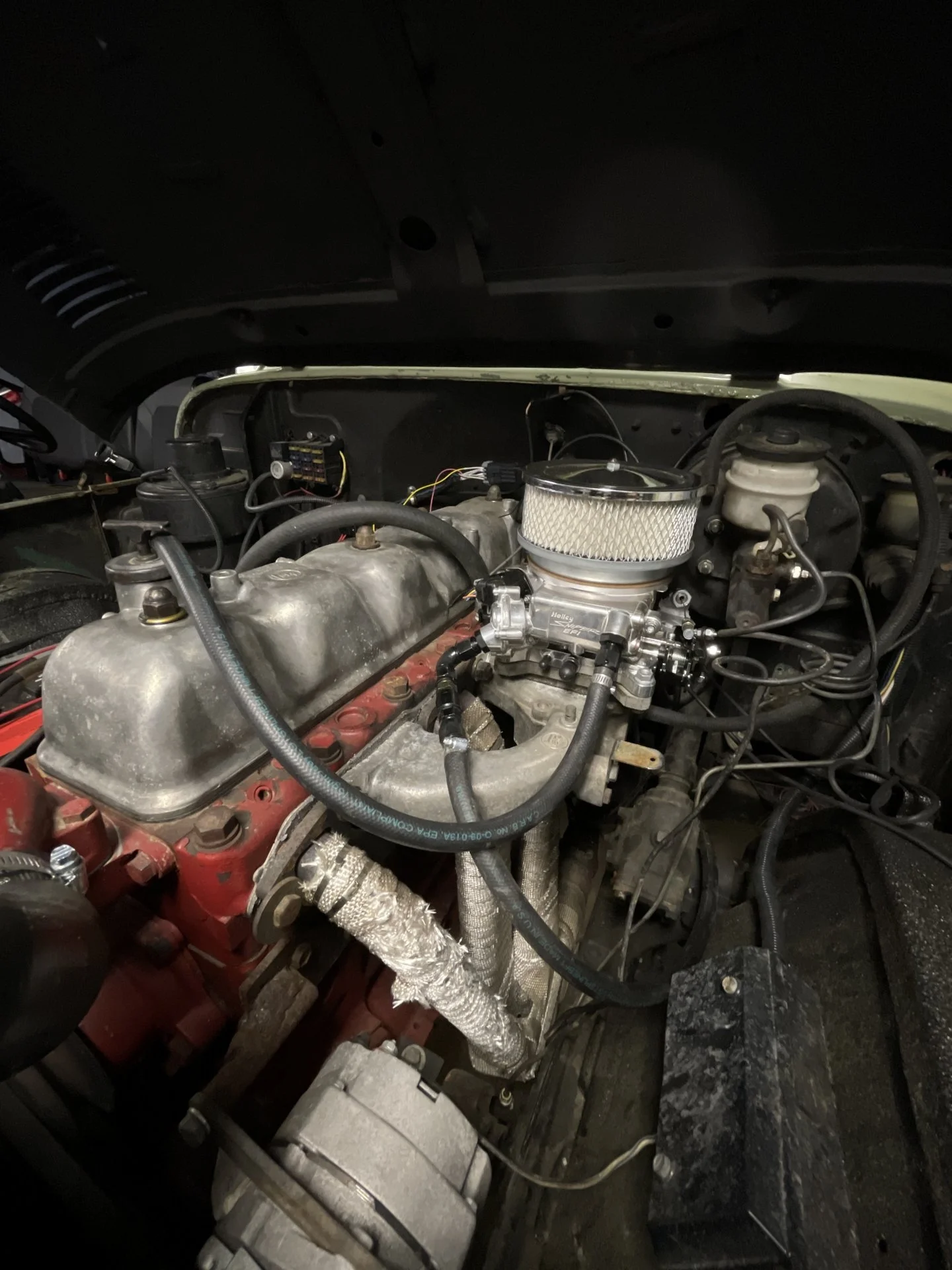

Does anyone know where/if the PCV valve connects to a Holley Sniper?
My engine is a 76 and I used the inlet on the carb base with the Sniper and routed the hose there
PCV should go into the side of the intake not the base of the sniper. You don’t want all that going into the base of the sniper if possible

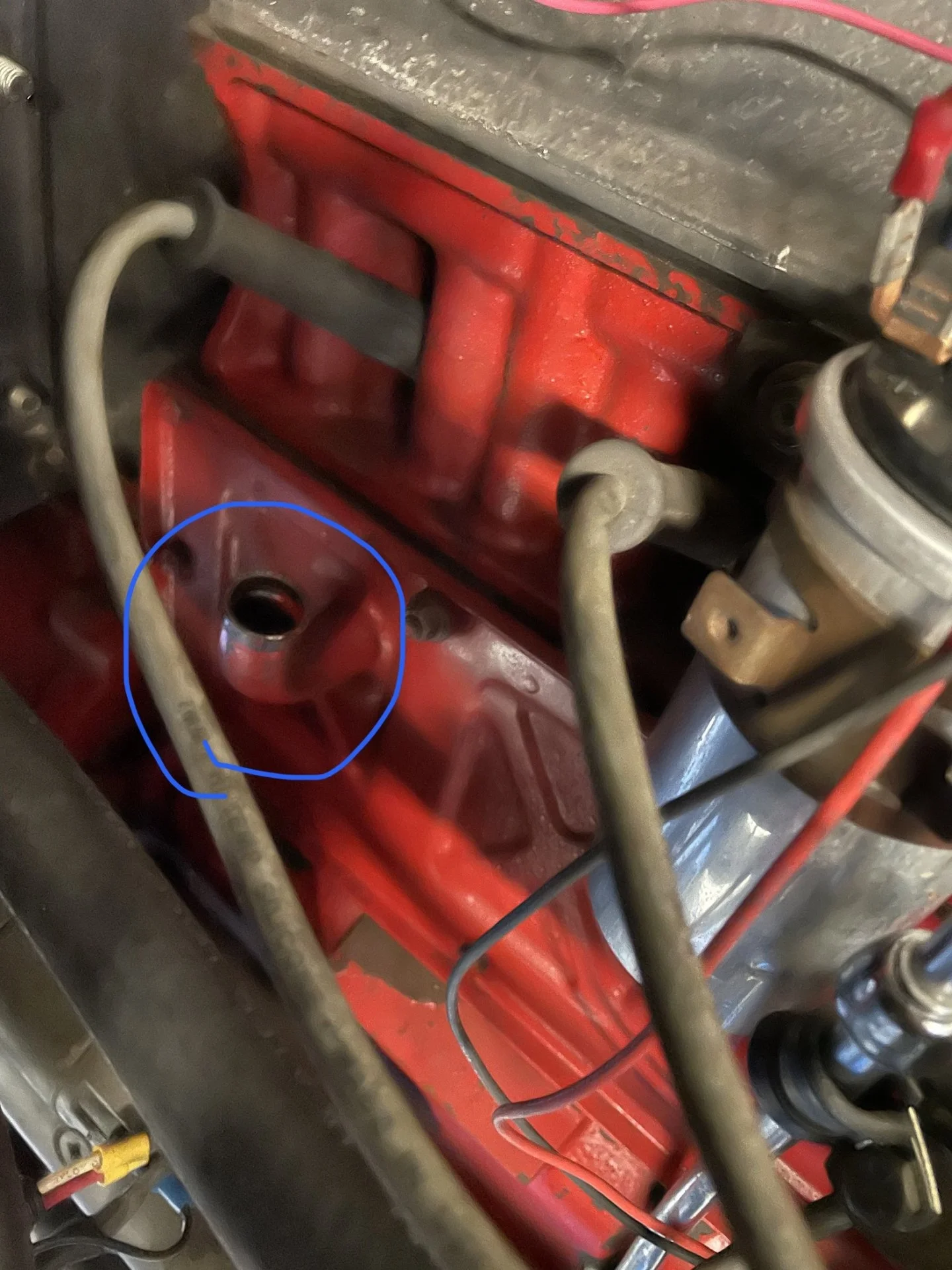

On the side of the block do we need to have a PCV valve and hose to pull vacuum on the crank case? Just wondering what plugs this hole.

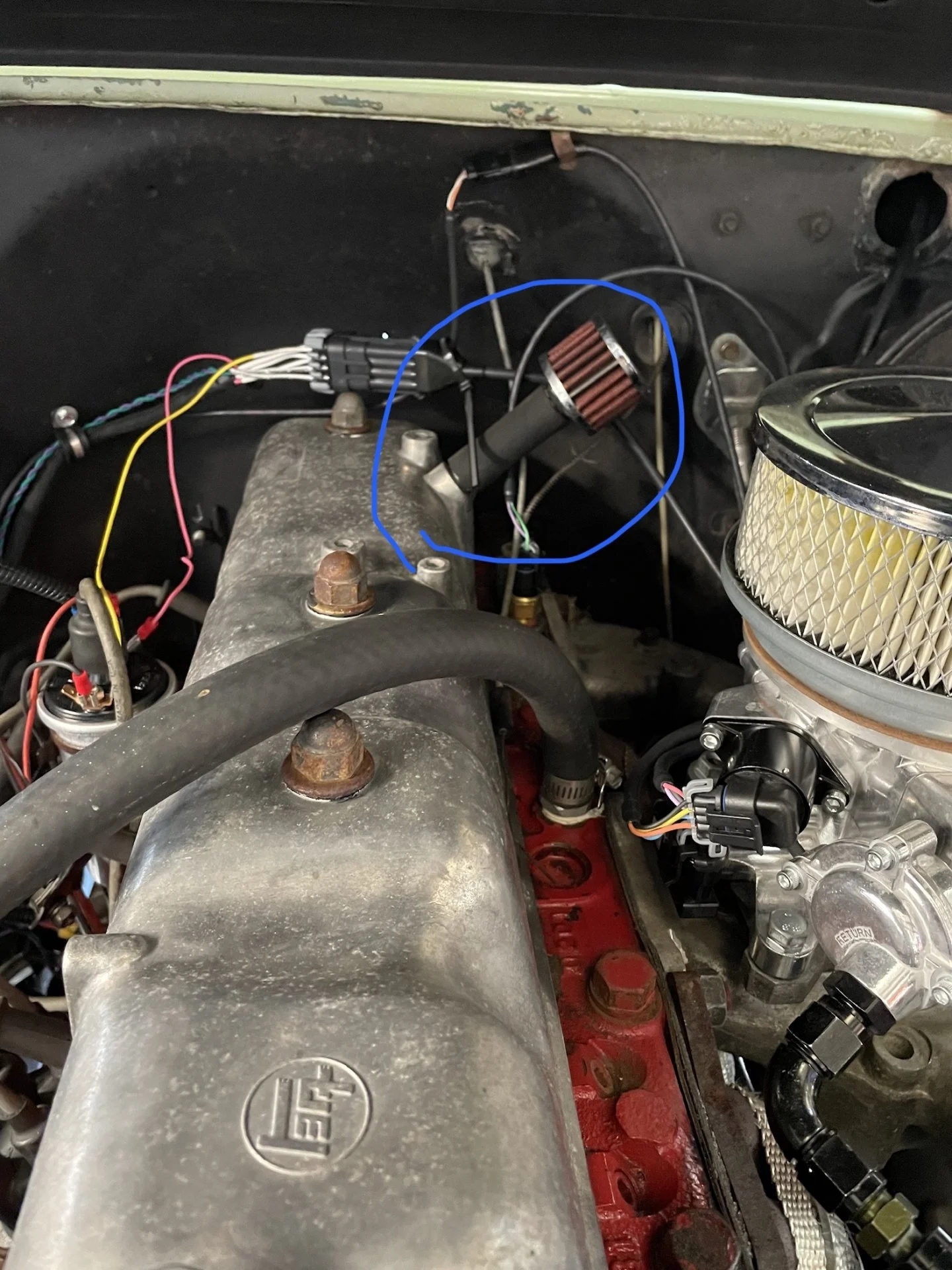

Also where I have this filter on the valve cover, does this need to connect anywhere for a vacuum?
The first pic. PCV valve. Run a hose around the firewall side of the motor into the center of the intake. There should be a provision there to put an elbow.
the valve cover just needs filtered air. That’s ugly but does the job
