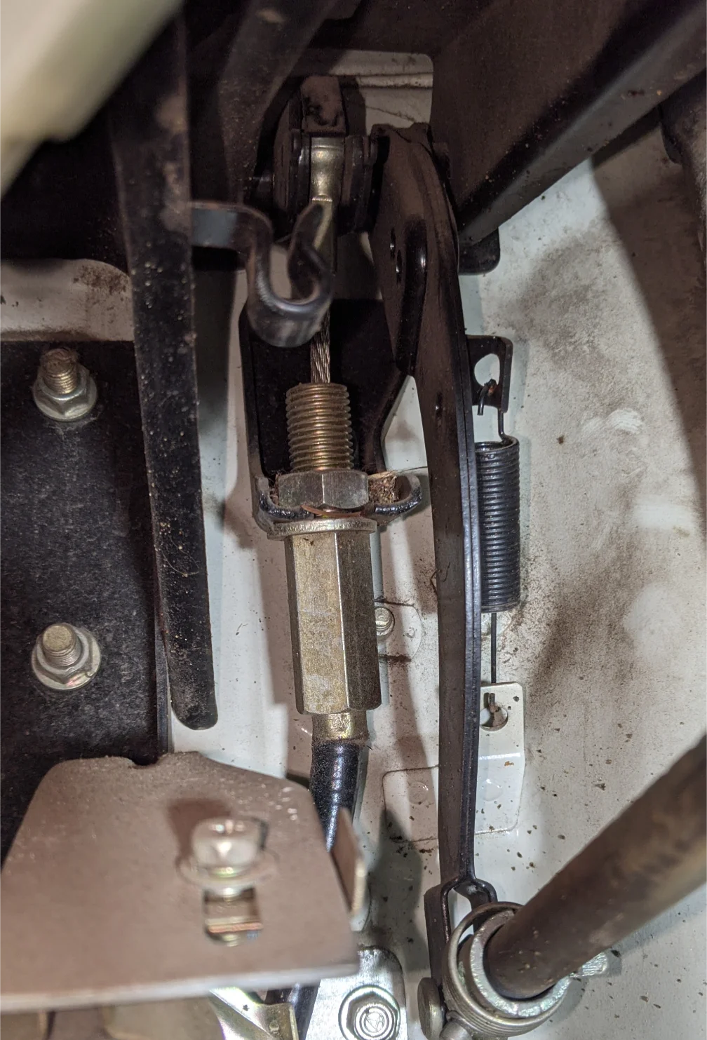

So, to tighten the hand brake lever at the firewall, do you turn the long nut to expose more male thread or less male thread??
Actually, turn the jam nut clockwise (loosening its clamping effect) then turn the large "nut" counterclockwise, to effectively length the sheath. Finally tighten the jam nut to lock the adjustment in place.
