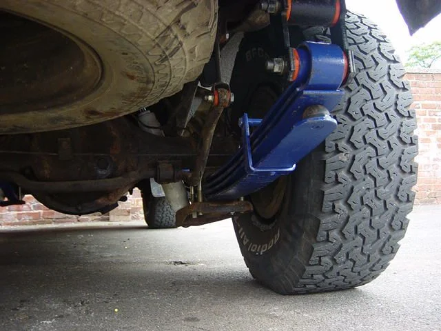

    Having considered OME, King Springs, Dobinsons, OEM and IronMan springs for my 60 ... I have found what I think may be the answer.
    All the above would cost me over $1500 since they are not available in the UK so I will have to pay heavy shipping costs and import duty.
    .. Then I started thinking about Parabolic springs. I used to have a set on a series 3 Land Rover I owned about 6 years ago. They were fantastic - almost as good as a coil sprung vehicle. I have found a company in Holland that manufactures Parabolic springs for all leaf sprung Land Cruisers. The cost is about $750. Maybe this has been covered before? Info is here:
    http://www.parabolicsuspension.com/toyota/lcruiser.htm
    It looks good. 50mm lift and improved ride and not too much $$. I should get them in about 10 days and will post photos and let you know my opinion once fitted. In the meantime, like to know if anyone has seen / tried them on a cruiser.

    Man, those things are flexy. With that much flex, tire size would really be limited in SUA. I wonder how well they would work in a SOA as far as axle wrap goes.

    yeah does anybody know about them for a SOA they look mad flexy...almost too flexy...but when i need to replace my stockers down the line those would nice to have...i just wonder if they were too flexy for a SOA....you would have to have some hella stiff shocks to control the weight of a 60

    ya the more pics i see and the more i think about it you'd prob. have to double up on the shocks..to swing those spring on a SOA setup...
