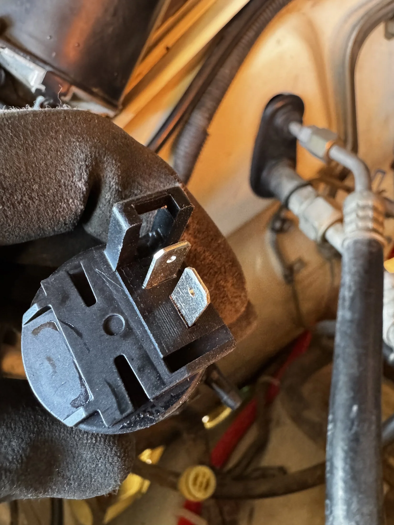

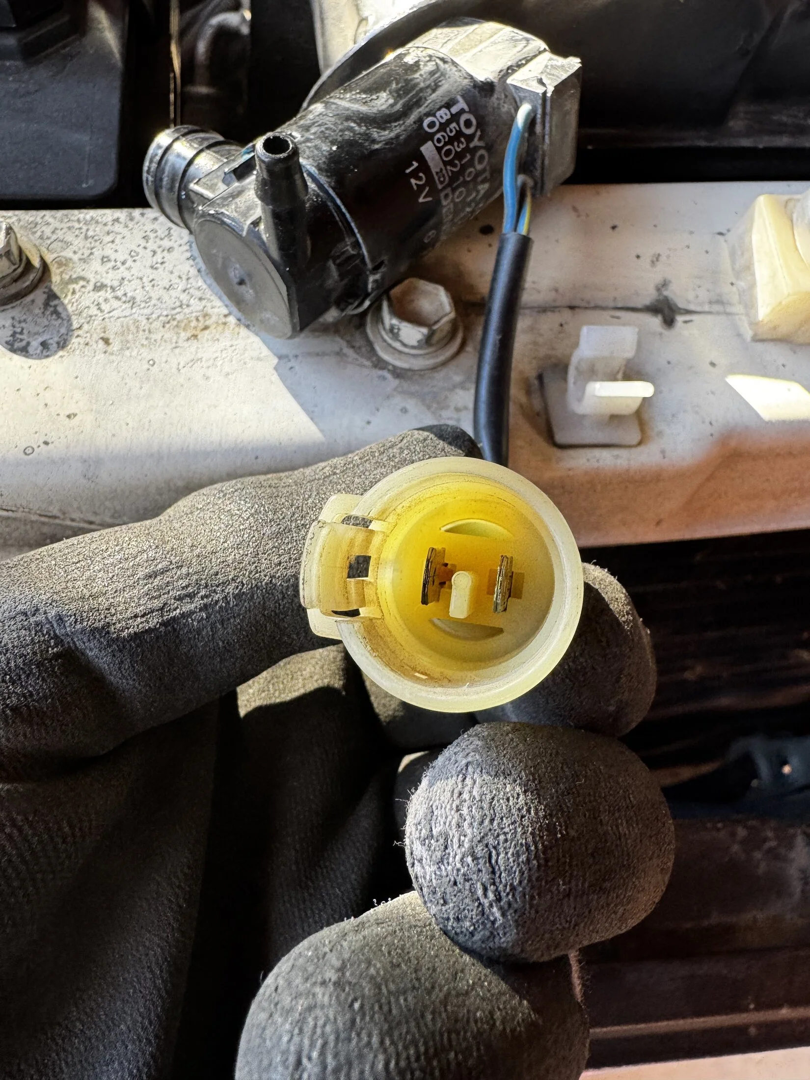

Hey, folks. I bought one of these nifty washer bottle pumps ("12V Windshield Washer Pump for Land Cruiser FJ60 FJ62 70 Series Pick-up 4Runner") from City Racer recently, but subsequently realized it's not plug-and-play with my existing wiring. I'm hoping y'all have some guidance for a rookie 60 restorer as to how I can make this work.
Pictured are existing/OEM connections and new aftermarket part.
Thanks!
If 12V+ is applied to one contact and 12V- to the other, the pump will run.
Cut off the plugs and use different ones.
I haven't looked, but are the old connector re pin-able? I probably wouldn't waste my time as the old connectors are brittle and as much as I love these trucks, it isn't about the plastic parts. I'm glad Cityracer has a replacement. The Mt. Dew mod bottle on hose clamps is just trashy 😄
