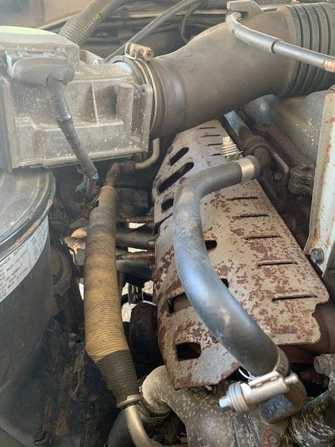

What’s the consensus on the pair valve? Keep it or delete? I have a ‘94 with a considerable vacuum leak that I traced down to (I believe) the pair valve at this point, my LC will not pass emissions and the idle is high but NM is not very particular with visual inspections so a delete is an option. I replaced all vacuum hoses with OEM and a VSV valve and unclogged all ports so I’m positive my leak isn’t under the intake. My O2 sensors test out fine so I’m pretty sure the code 25 resides within my reed valve.

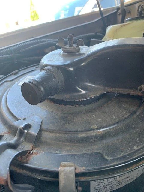

If it is just a vacuum leak you are chasing, then put a BB or the like inside the vacuum hose to the PAIR valve. No vacuum leak, and no obvious sign it's been tinkered with.

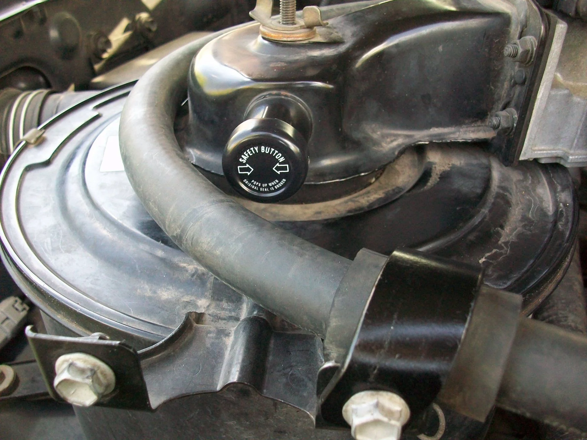

Removed mine a few months ago on my '94 with no changes in performance or codes thrown. Instead of plugging the airbox intake I searched for a cap that fit well and was made of metal. Taco Bell cap worked and best of all it was free. Just carefully flattened the inside thread tabs of this cap and used ultra black as a donut shaped sealant inside the cap after wiping brake cleaner on all the surfaces. Let cure 24 hours. Fits perfect, now has a working safety button....and adds 15 horsepower.

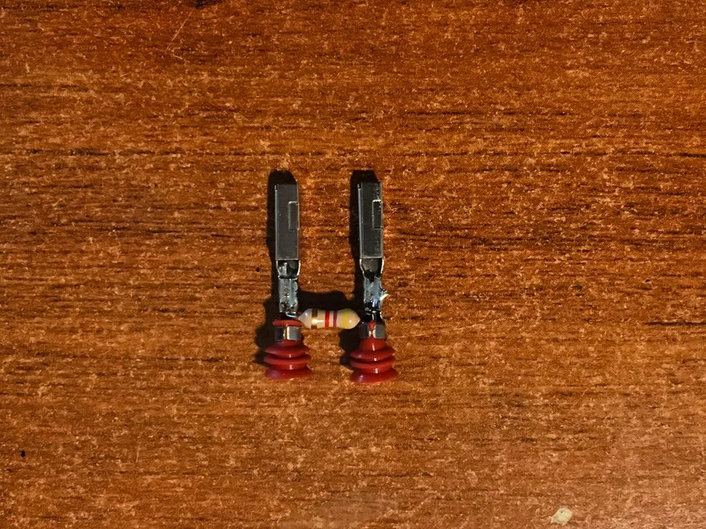

Toyota block off plates were NLA when I tried to get them, but several places sell O2 block off plates, just make sure they are for the correct two stud style. You can choose to block off the original O2 locations or the PAIR injection locations. I moved mine since I used a later style exhaust with one pre and one post cat location. You will not throw codes for PAIR or EGR in a 93 / 94 (non Cali emissions anyway), it's not that smart. You don't have an EGR temp sensor, and you already have the coveted factory EGR temp sensor bypass plug.
