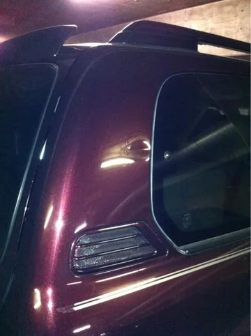

Freshly acquired '04 Hundy. Original owner had a slight run-in with a tree branch. There's no paint damage, but an obvious dent. Anybody know enough about paint less dent removal to to give me some advice in whether this would be worth pursuing. How hard is it to remove the interior panel to access the back side? Is it even possible to access the backside of the c-pillar?

I have had many dents pulled I would take it to a good PDR guy and let him go at it. It will take him some work but he could make it look a lot better. you might see it a little, but it just depends how stretched the metal might be. Might cost a 60 to 100 bucks

Dent is to big and to close to the window. Looks pretty deep too, paint will most likely crack. I use Dent Wizard all the time for my customers. Sorry it's the bodyshop for that one. Good news is it's on a small panel with curved body parts around it very little tint and blend needed.

I agree. From the pic it looks creased and stretched which will keep it from being a candidate for pdr.
That being said, I would definitely go see if a pdr shop can fix it. If somehow it can be fixed for $100 without paint then do it. If it is $400 and aftermarket paint, I would live with it.

Not having much experience with PDR but some with sheet metal I would say it looks tough as it's so close to the window frame which will have multiple creases. The interior is easily removed but I'm not sure if that area is single or double walled.
