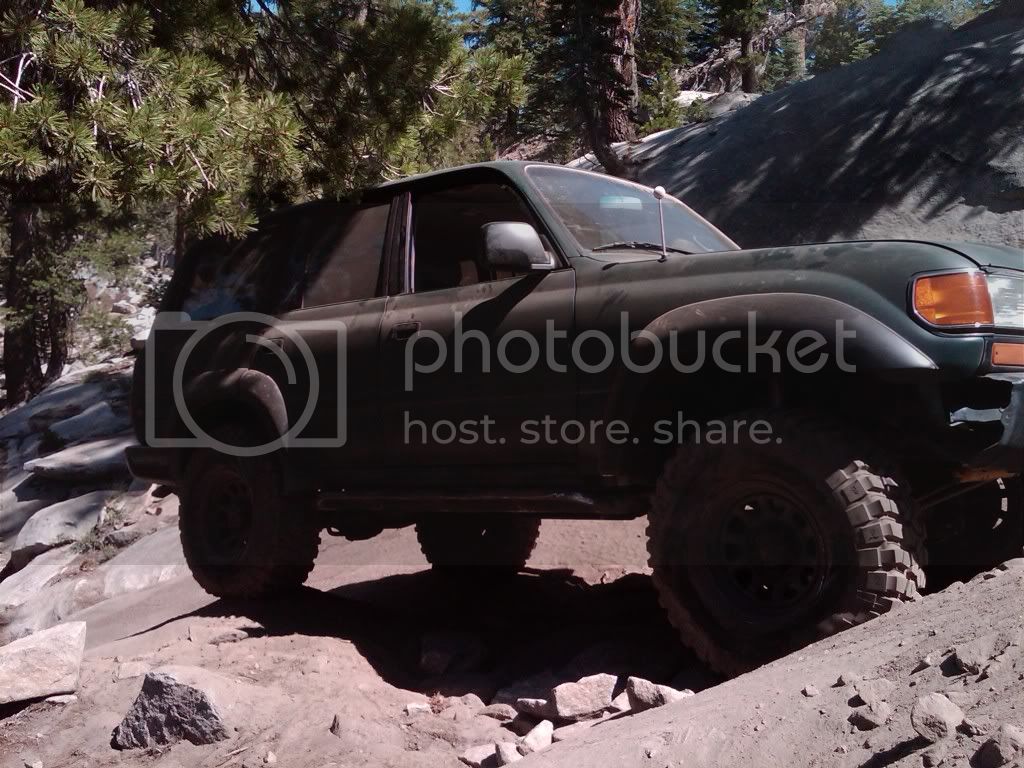

This is what mine is going to look like within this month (top pic taken today, bottom is what it will look like); spray paint on the sides, spray bed liner on the flares:
Im half way through my "canned" paint job. I have gotten really good with a rattle can. Paint looks so nice I wish I had spent more time making the body work look good from the bob. Probably line-x'ing the back half anyway. If not I may go back, sand it back down, and clean it up a bit and re-spray the back end. For $10 a panel I can afford it.

I like the tires, but can't really say that shows the paint any better than the avatar...
Can't find any other photos at the moment.
