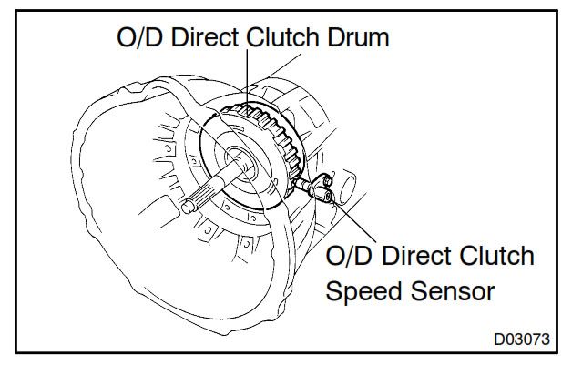

Thread seems vague on details...Which sensor is the culprit for the P0715 code?
From the FSM section on diagnostics:
DTC P0715 Input/Turbine Speed Sensor Circuit Malfunction (O/D Direct Clutch Speed Sensor)
It's in the transmission, location illustration below.
full
