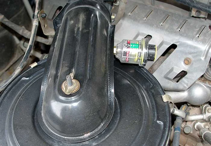

Put on one of these, Filter Minder® Graduated Position Air Filter Restriction Gauge - Threaded Mount Clean everything well, grease the seals, leave it alone till the gauge reads ~22-25, bet it will be years.
attachment.php

Why, aren't the diesel filters cyclonic, have a tuna can, hard to believe that are that much less efficient that the gas unit? I wheel in the dust often, mess with the filter after ~3yrs, if that. Most of the dirt gets into the motor from filter service. Fresh filters are least efficient, they become better the longer they run, until they become clogged enough to cost power.

I do see the sensor you fitted and think it is a great idea, there was one on a truck I used to drive, I also saw this was being used in the video, and as per my earlier post is fitted on the Australian 80, there was other good advice about blowing out or banging the filter, useful for those needing training in this area.
I will stick with my regular changes, anal or OTT matters not, for the couple of minutes it takes me I am happy to know it has been done.
