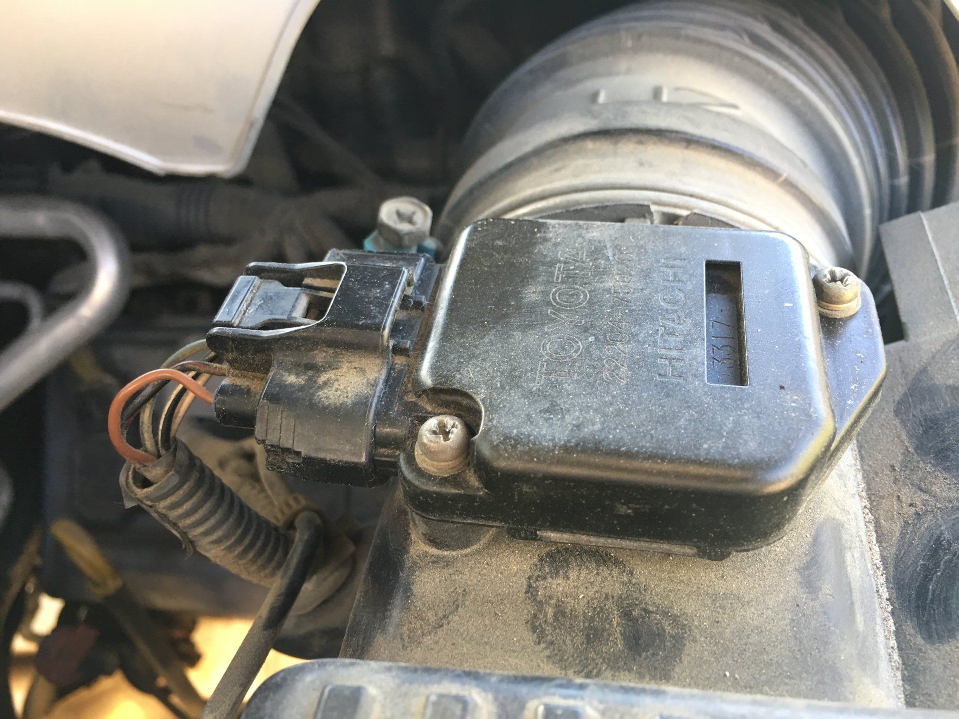

I’ll get the MAF sensor replaced this weekend.

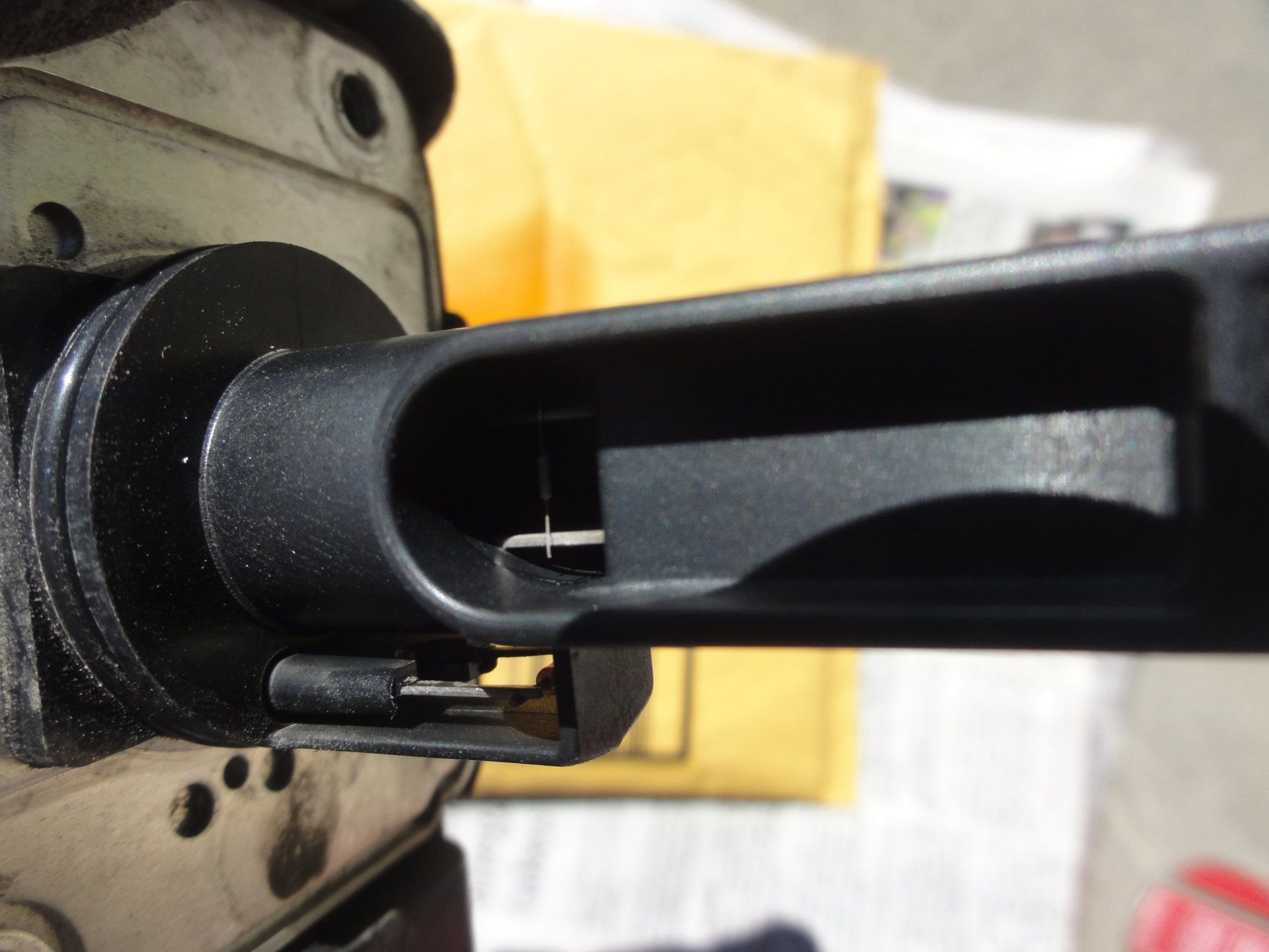

you should be able to clean your MAF sensor... that is an easy 1st step. this video is based on a FJ Cruiser's V6 but will give you the basics

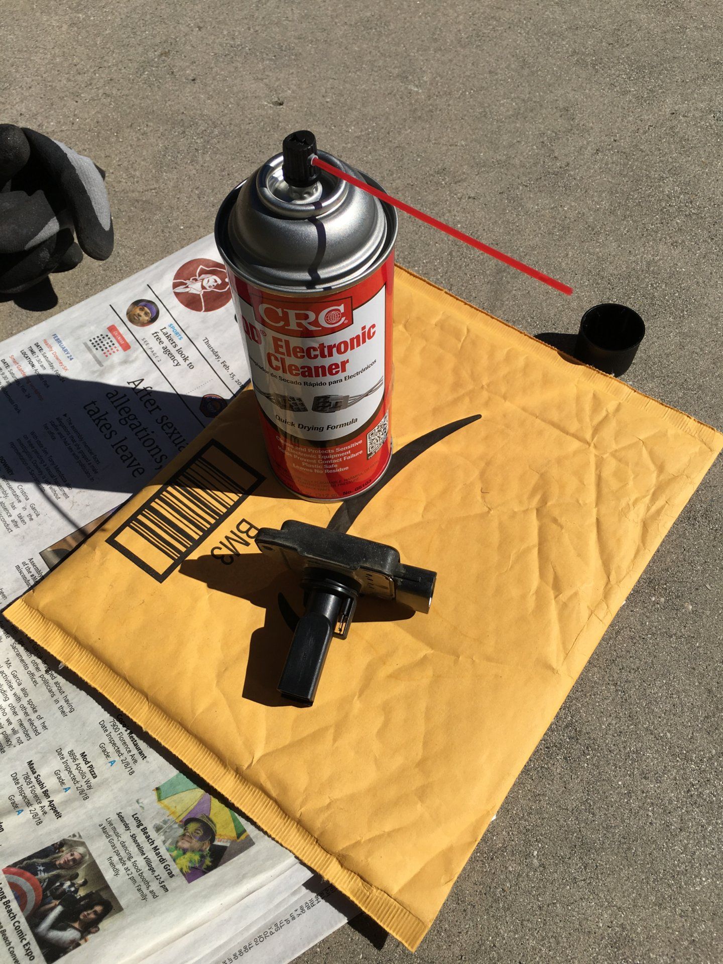

Awesome video. Seems easy enough to try to clean. You probably don’t even need to take the whole air unit out. Just disconnect and unscrew, clean with electrical cleaner, and reconnect. Hmmm maybe I’ll try that soon.
My GX470 seems to know when I’m going off-road and it throws the P0171 and P0174 as I’m driving to my off-road destination. It stays on the whole two days I’m in Anza-Borrego Borrego. I come home and the next morning the CEL is gone and it’s gone for two days.
Anyways, I cleaned the MAF sensor today. It took less than 10 minutes not including the 5 minute wait time to let the cleaner dry.
I’ll find out if this worked or not in a week or so.
So far, the MAF sensor cleaning is good. I took an offroad trip to the Mohave Desert and the codes did not come back. That was more than 200 miles including freeway and 4x4 on lo for two days. Let's hope the cleaning worked, but I need to wait a few more days.
