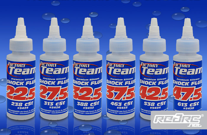

There is no question at this age the clutch needs new fluid; just do it. You can buy the silicone oil at a RC car hobby store.
This is the stuff I use. Anything between 5000 and 15000 will work. I recommend 10000. I opened my fan clutch after having this stuff in there for a few years and it was still in good shape, not burnt or anything.
