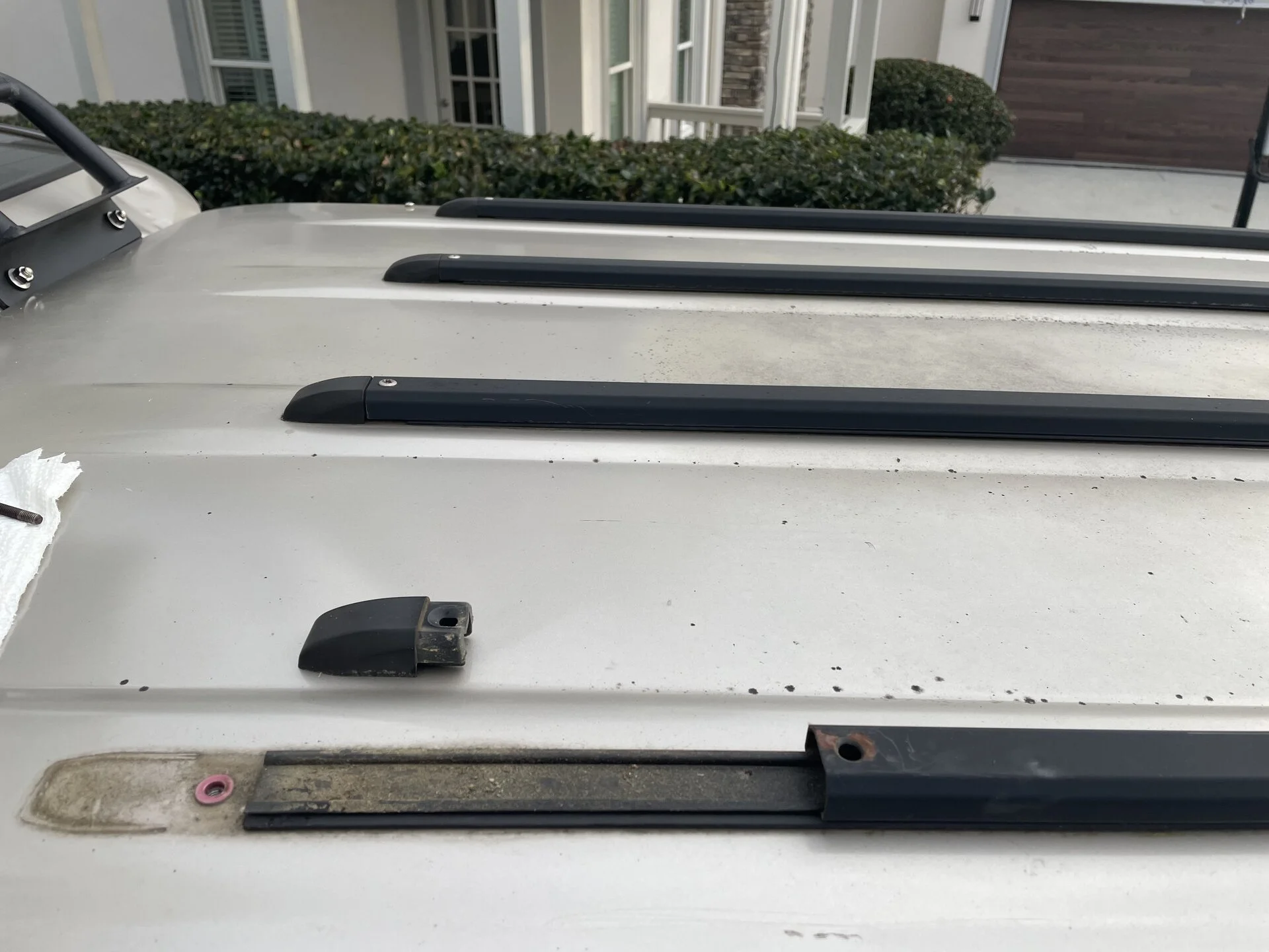

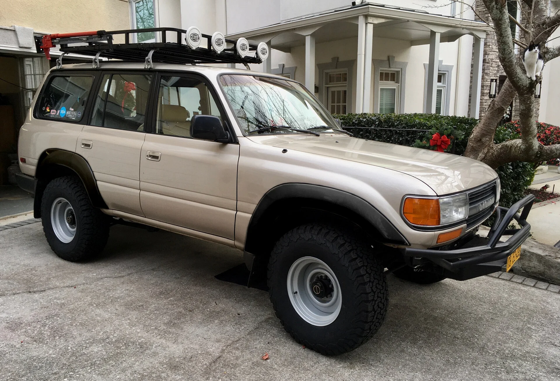

I designed and had fabricated the roof rack in the photo about 7 years ago for my ’92 80. At that time, I coated the finished rack with POR-15. It was starting to show some age and fading so I removed it a couple of weeks ago and had it stripped and powder coated which also matches the ladder much better now. I am not anticipating reinstalling the original luggage rack and would like to get rid of the 4 ribs/strips on the top and plug the holes. Here is my question… I took the end caps off of one of the strips and with a small rubber mallet was able to tap the cover forward about 8 inches. At that point I checked the adhesion of the part under the cover. I found no screws and it (the base part) is tightly boded to the top. Does anyone know if these base strips can be removed without damaging the top and paint? Worst case I guess I can live with leaving them on as they’re really not visible. I had no problems removing the original rack frame. Any input will be appreciated.
so the ribs slide on that rubber portion? I wanna pull mine off to paint. And have been wondering about that.
Yep. Light tapping with a rubber hammer (after removing the caps) will get the covers off but the base is bonded to the top somehow. That’s what I’m trying to figure out. I’d like to remove all of it.

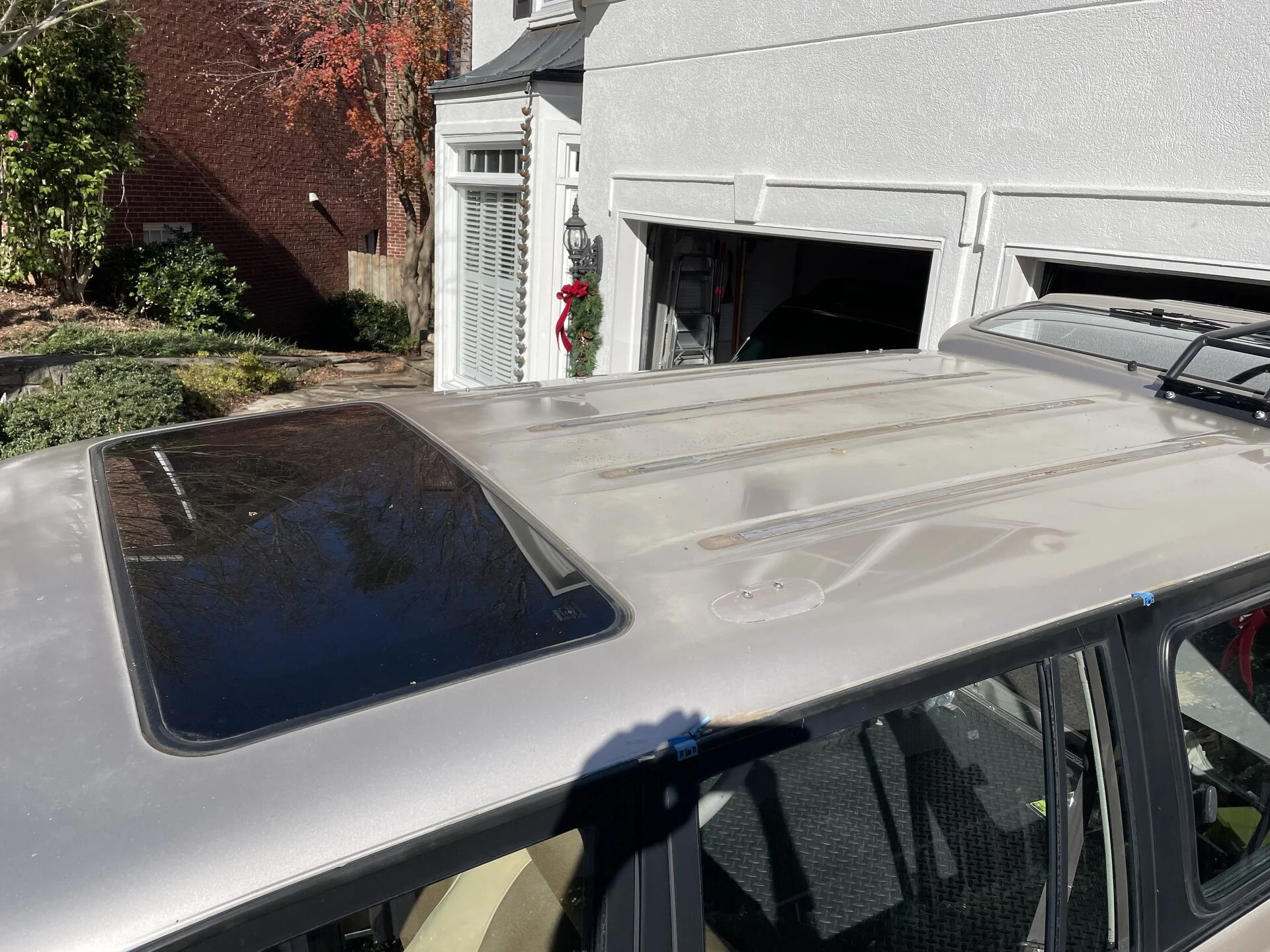

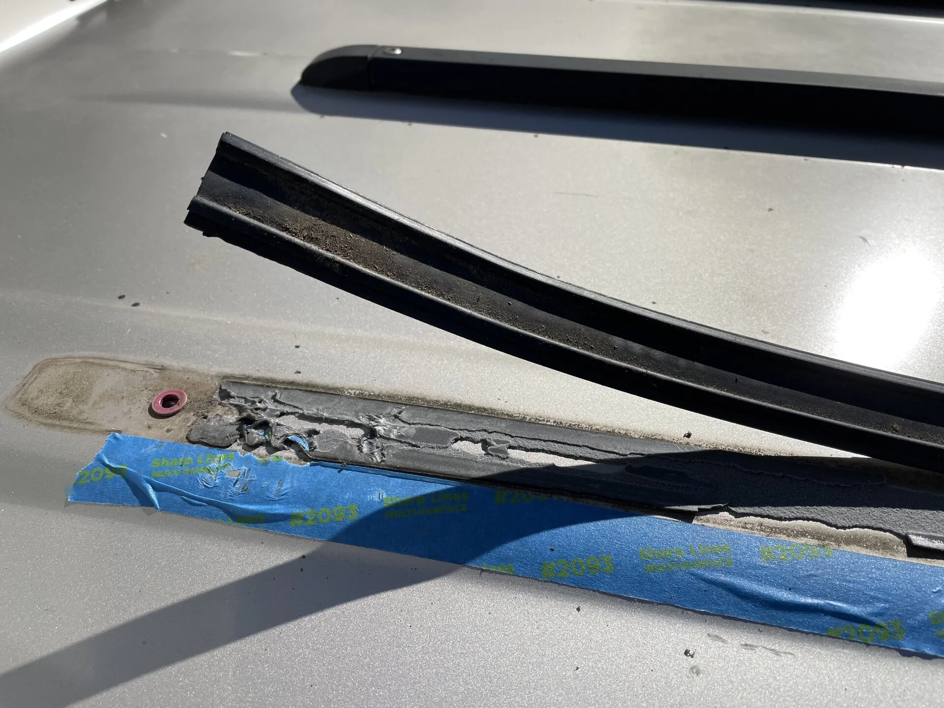

Parked the 80 in some direct sun this afternoon and warmed up the top and strips. Tapped the covers off, used a trim tool and paint scraper to lift one end of each. They peeled off and, as you said, left some tape residue but that will “erase” I’m sure. All 4 are off and all parts could be reused if need be. I’m planning to have the 80 painted early next year and this will be a great help to the painter I’m sure!

That adhesive is a pain in the dick. I have the pinstripe eraser but wanted to be less aggressive so I used steam to soften and peel the adhesive (much like you’d remove PPF)

Steam was good at softening it so I could peel it, but it took a long time. I would probably go for a product like 3M Adhesive Remover if I were to try it again.
If you want to get the stuff off quickly, just run the adhesive removal wheel at a decent RPM and don't stay in one place too long. The wheels work by generating heat through friction and then slinging off what has softened. As long as there isn't grit or something on the adhesive/area and you don't sit in one spot too long there is no risk to the paint with the wheel. The wheel itself will start to smoke before the paint is overheated.
There will be melted and then re-solidified goo left behind and while you can get all of that off with the wheel it's faster/easier to just wipe it off with denatured alcohol. If any of it doesn't come off quickly hit those spots with the wheel and then wipe again. Of course, just a quick wipe and don't keep the surfaces saturated in solvent long as they can start to soften the paint layers.
Other heat sources are just going to add more steps and make removal take longer because you are separating the heating and mechanical removal steps. The wheels are easy to use and to control the heat with. More speed and pressure equals more heat, etc. The metal under the paint will dissipate the heat pretty well so working these on metal surfaces is pretty forgiving.
