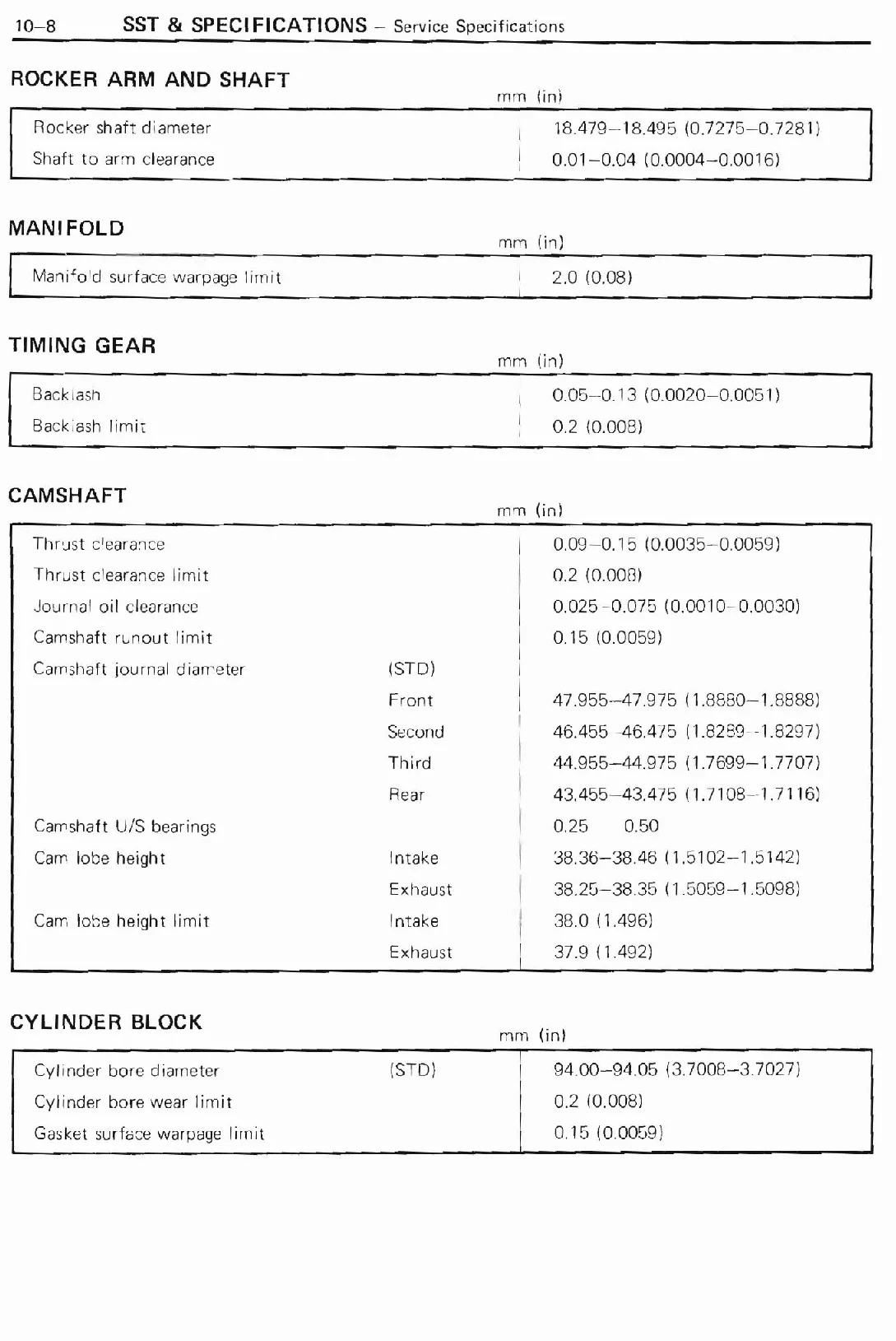

Hello Jürgen,
I understand your concern based upon the pictures of your camshaft.
This is a link to a later 2F engine factory service manual available here in the resources tab.
That manual is what you already have.
Try this link, Land Cruiser manuals, FSMs, and repair resources - https://heritagecruisers.com/pages/manuals
and you can see the camshaft specification table in the "1991 2F Engine Repair Manual (98126E)"
It lists the camshaft data on page 10-9.

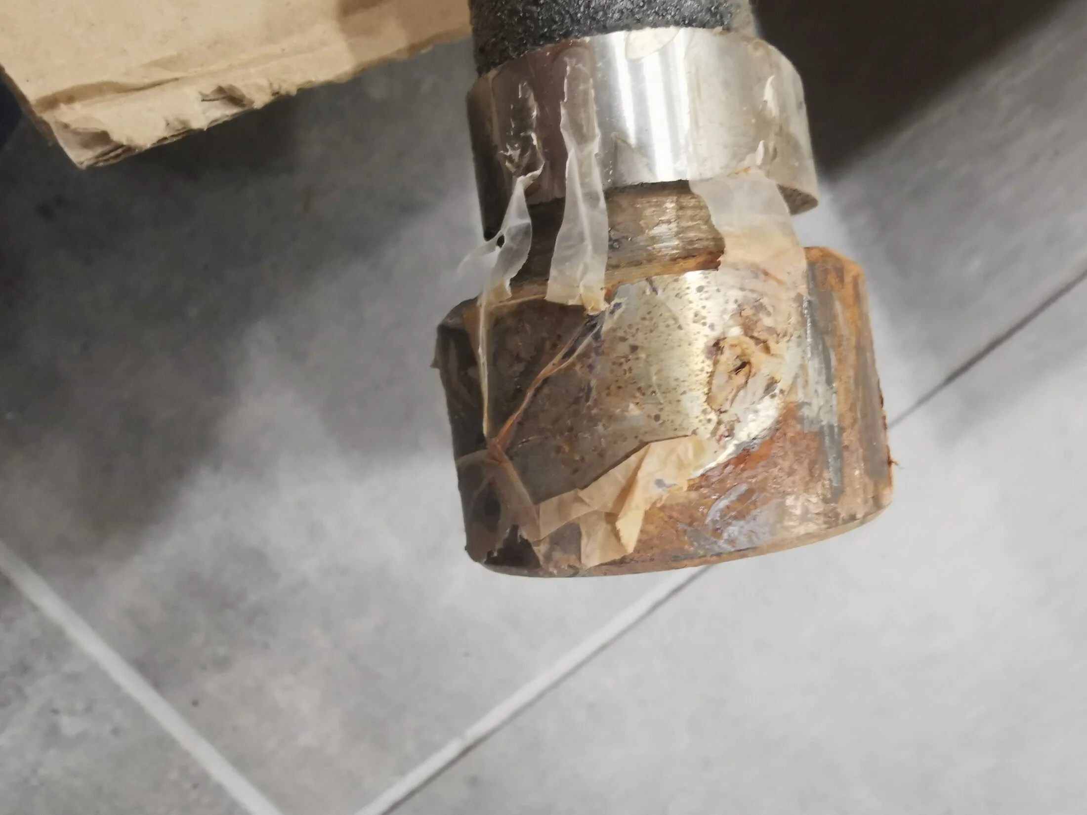

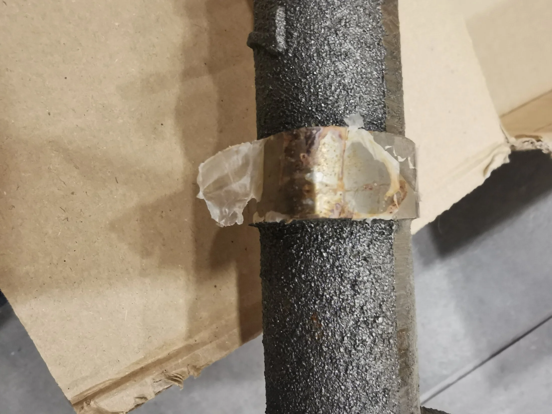

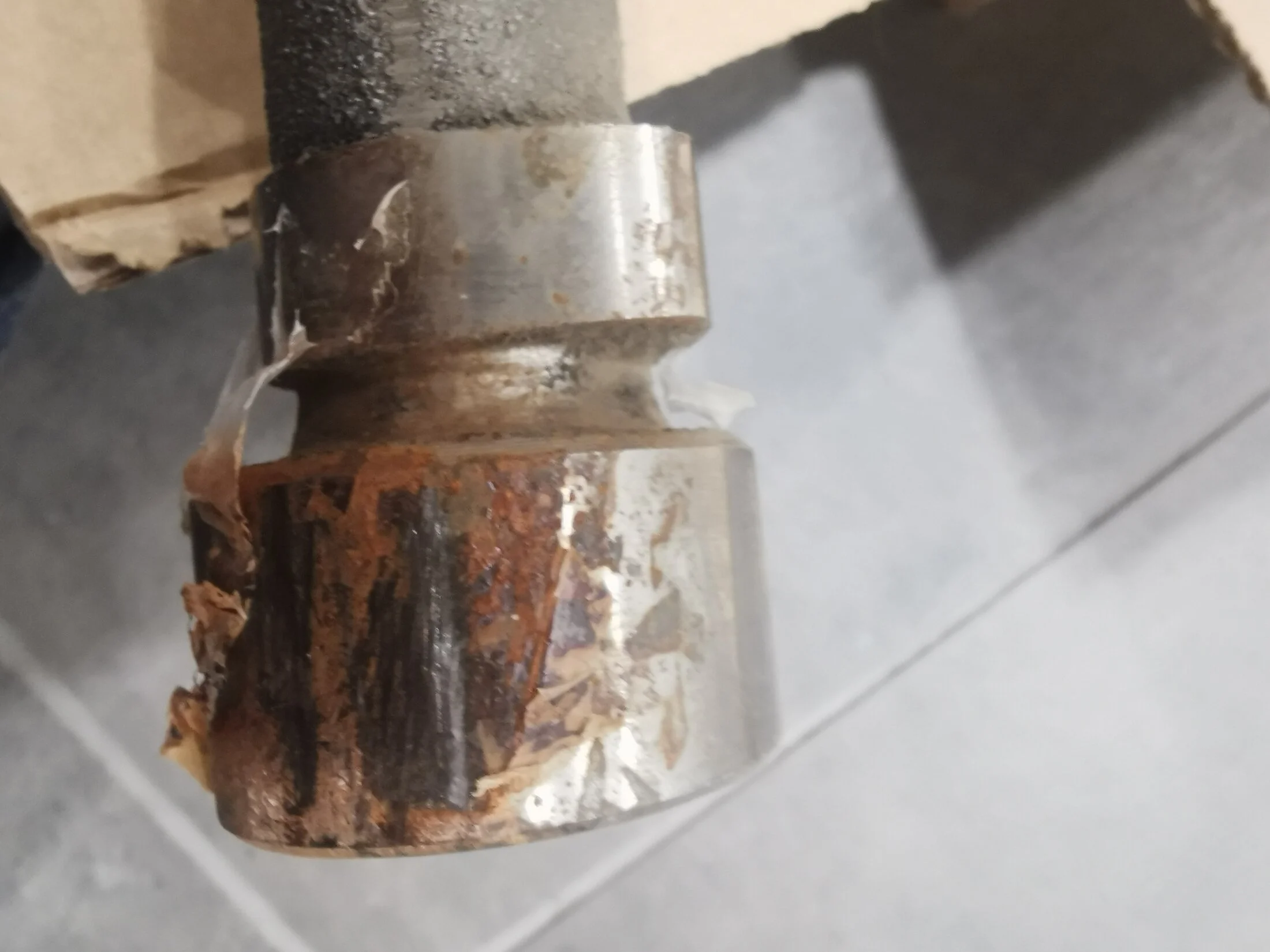

Soooo, I haven't written anything here for a long time, but now there's news, although not particularly good news.
I ordered or bought a brand new original camshaft for my 2F, the seller got it somewhere from Dubai or something.
A few days ago the camshaft arrived and I was very happy, unfortunately my joy only lasted until I unpacked the camshaft. I almost went crazy when I held the brand new camshaft in my hands.
Luckily, the seller understood that I definitely didn't want to keep the camshaft and immediately offered to take it back and transfer my money back, which he has already done.

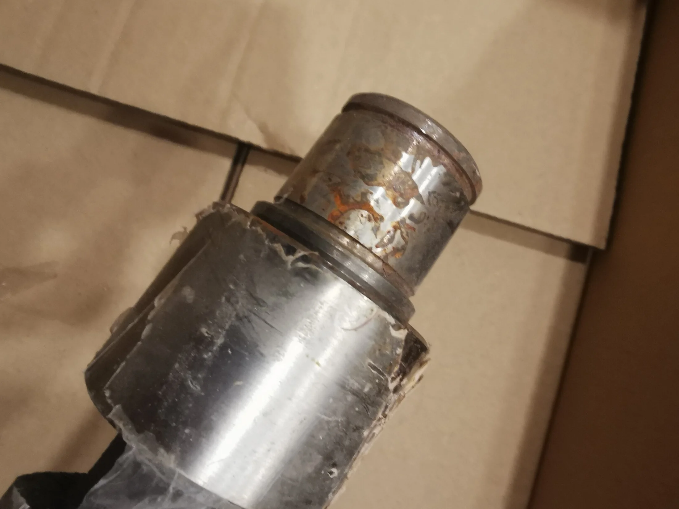

I'll show a few photos here so you'll definitely see immediately why I didn't want to keep this brand new camshaft.
A kind greeting from Germany,
Jürgen
Wow that's a lot of rust. How did they not notice that, would be fine for a candidate to re-grind but being sold as new. It is nice they gave you your money back too bad they wasted your time. Mail order is sadly often not without issues. I would try again as the motor is a brick without a cam shaft.
Sometimes dried grease looks like rust. I have bought ebay old bullet molds that looked like that but cleaned off with brake clean.
The dealer from Germany who got the camshaft from Dubai did not unpack and check the camshaft after it arrived, but sent it directly to me.
But luckily he takes her back.
And unfortunately it wasn't dried fat, but definitely rust, unfortunately.

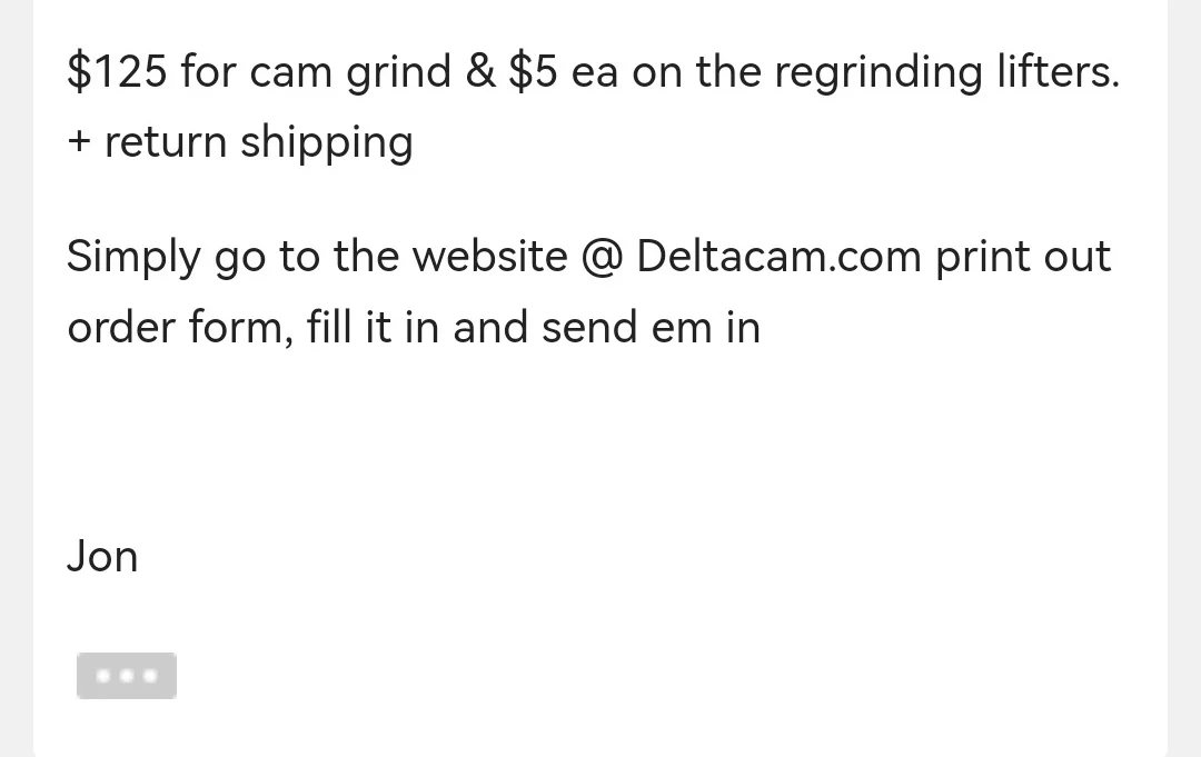

I'm going to send my old camshaft to Tacoma to DELTA CAM and have it reground into a KC859.
I wrote an email to Delta Cam and got a reply.
And I think it's a really great price that they quoted me...
I thinks that's a good price. I see shafts listed $300 up to $750 rv regrind with springs/lifters plus a $150 core charge and shipping. I hope it works out for you this time.
