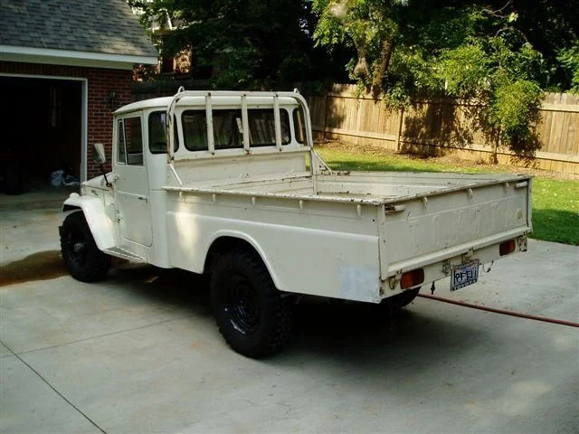

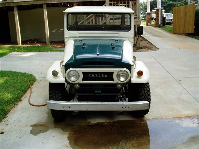

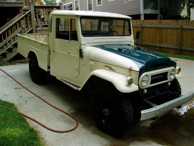

I finally got the time to get the 45 project going again. I pulled it out and drove to the store on Saturday, only to find the front right brake locking up on me. Oh well, haven't driven it in at least three years, got to expect most of the seals are giving up their life. So, after getting it out again, I'm energized about painting it soon. I've been reviewing old photos here and there and can't really come to any definite answers. What color are the mirrors and arms supposed to be? Turn signal and hood latch colors? Which is correct, clear or amber turns on the front? When the truck is painted white, are the top and bezel the same color or slightly more white? I thought the rims were originally black, but now I'm second guessing that.

Everything is body color except the bezel, it's white, although I've seen black ones. My turn signals are clear. And NO they are not faded, they are clear. Wheels should be grey.

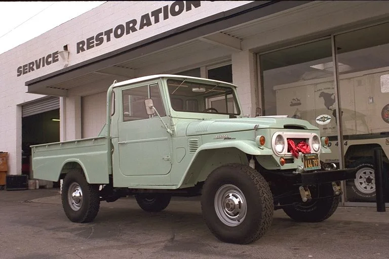

TLC's version
Amber lights all over, body colored mirrors and turns, but silver hooks.

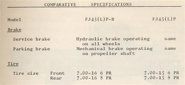

I agree the wheels on 60's LWB trucks are black. But they were also 16 inches in diameter!
from the '64 service bulletin:
parts books, show 16 and 15. all US sales lit(that I can recall) mentions 15
but i have seen the same thing as you.

So, maybe its possible that the 15 inch wheels were gray, and the 16s were black. Or do we know for sure? I definitely like black the best!
