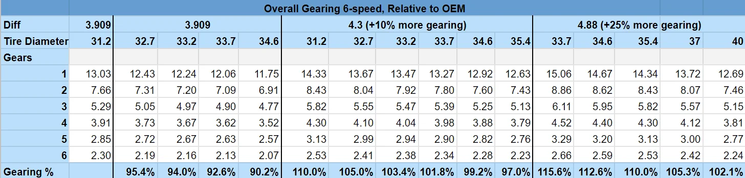

As much as gearing can help efficiency for a heavy rig, excess gearing has the potential to bring its own efficiency losses in the form of driveline drag and windage losses.
Here's a gearing reference for the 6-speed against various spec tire sizes and gearing options. More here- Definitive 200-series Gearing Reference - https://forum.ih8mud.com/threads/definitive-200-series-gearing-reference.1043543/#post-11503139
You can see that 4.3s are going to offer better gearing than stock for anything short of a 35" tires, and practically stock gearing for said 35" tire.
4.88s are almost a full gear step in the transmission. Good to 40" tires.
An unresolved integration of gearing is transmission tuning to be able to leverage gearing outside of stock parameters. Jeeps and Tacoma's have this. We don't unfortunately. We know when undergeared, the transmission doesn't shift well. The shift map is all over the place with transitions at load points outside of a well tuned system. The same is true with overgearing.
A symptom that @linuxgod might have discovered is torque converter lock-up for 4.88s. It's not clear if left in "D", if lockup is happening for 4 and 5th gears. Only 6? Which would be a pretty large impact to efficiency. Fortunately this can be worked around driving in sport as he discovered. Whereas my setup with 4.3s on 35s, which practically results in stock-like gearing, the torque converter is locking up as expected in 4,5, and 6th. I can say it performs with a factory tuned quality.
Practically speaking when towing, my rig is arguably one of the heaviest out there at 15k lbs combined. On 35s. Efficiency and performance are both priorities, especially when towing. For my use, 4.3s are still the right gears for me.
So maybe 4.88s, or maybe not, depending on your priorities. Now if 4.56s existed to @grinchy 's point...
