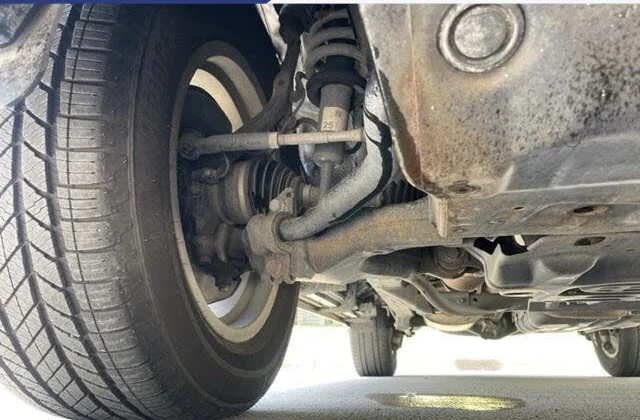

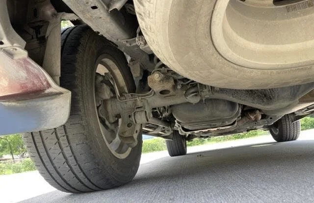

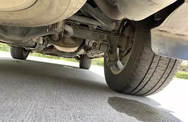

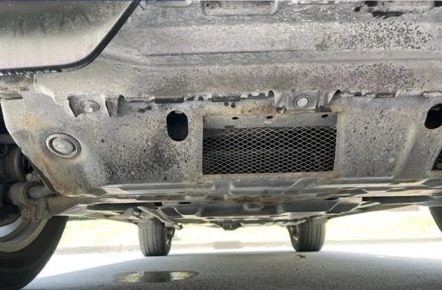

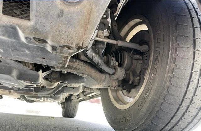

Also, there is what appears to just be surface rust on the undercarriage, and what could be the remnants of leaks to the left and right of the skid plate.
So my questions are how big a deal is it if the diff and transfer case services haven’t been done yet? If the engine timing reseal is the same problem that I have read others have had how concerned should I be if it wasn’t done? Also, what services were possibly declined that weren’t noted specifically on myLexus?
…and of course what are your thoughts on the undercarriage, as far as the rust and the possible leaks?

While the undercarriage looks, IMO great, I would be hesitant to pick up a high-mileage vehicle that only had 10K oil change intervals and may be running on the original differential and transfer case fluids. The 10K OCI's alone on a high-mileage vehicle would personally be enough for me to pass on it. Especially on a timing chain motor like a 1UR, there are simply a lot of components that require fresh/clean oil. 10K OCIs can easily result in the buildup of a lot of varnish and sludge inside the engine. Yes, I know this is the factory OCI, but the manual is also clear that it basically only applies for highway driving - any short trips, towing, dust, etc, requires a shorter OCI.
If the PO didn't bother to stay on top of the easy stuff like oil changes and gear oil changes (which are super-cheap and easy to complete), I'm also betting it's running the original transmission fluid (which is known to be problematic on the A760F for some 460s), and who knows what other kind of maintenance they deferred on. There are just a lot of questions/risks caused by a service history like that - the rig should be considered a dice roll on how what kind of skeletons it may or may not have hiding.
Toyotas may be reliable but they are susceptible to neglect just like any other vehicle.

I would pass too. The under carriage looks great but any truck that spent most of it's time in Texas will look good. Rednexus made some great points about OCIs and now that it might have the coolant valley leak, I'd pass even at an aggressive sale price.

Coolant valley leak and timing cover oil leak are two major repairs. That’s a poison pill for sure. Other stuff is speculative. Undercarriage is fine.
