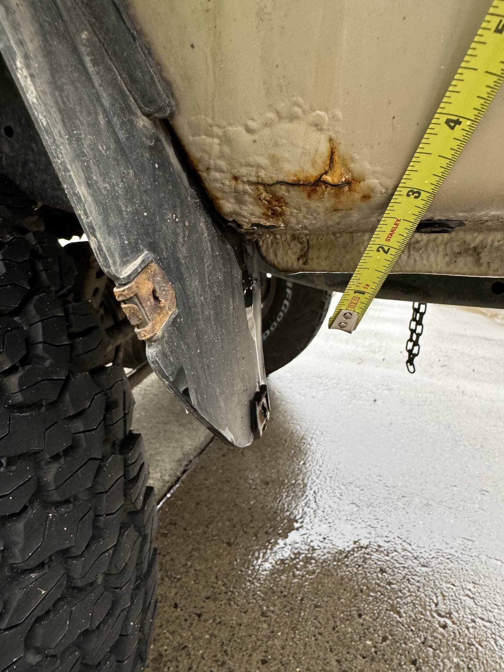

Below are the worst spots in my 450, might need a professional to address these babies
View attachment 3725124View attachment 3725125View attachment 3725127
