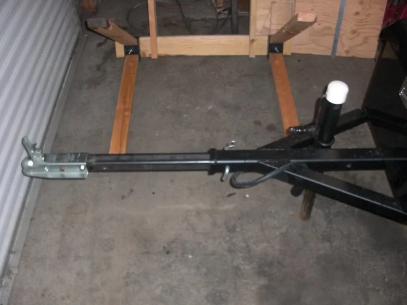

Any thoughts on types of trailer hitches?
I'm looking at possibly extending the length of the hitch and while I'm at it, I might as well look at different attachment types - it's an A frame style attachment.
Like this:
Right now it's just a 2" ball coupler. Those of you that use other coupling methods, your thoughts on them?
For reference, although this is technically an "off road" trailer - it's pretty big so it's unlikely to be on anything too extreme.

I've had a lot of trailers over the years, and by far, my favorite coupler has been a Bulldog:
Bulldog Heavy-Duty Square / Rectangular Tongue Mount Trailer Coupler, 7,000 lbs. - For Life Out Here
:beer: Ramon
That's a bummer. I just find it to be far more forgiving for opening and closing than the lever type. I have been told, and can see, that the mechanism is more robust / reliable as well. Just my .02

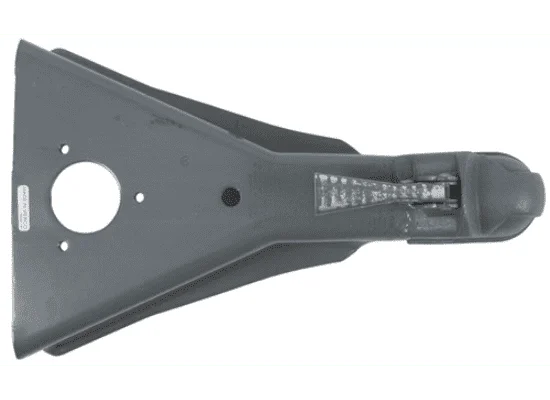

Thanks Ramon,
Looks like they make one in an A frame style with a 2" ball...
Bulldog Heavy-Duty Square / Rectangular Tongue Mount Trailer Coupler, 5,000 lbs. - For Life Out Here
Doesn't appear to add a lot of length to my hitch though....
James, if the goal is to have a longer tongue that may be a two step process .....
( I don't recommend using "hitch extenders" on the tow vehicle. The farther back the pivot point is from the rear axle the worse the trailer control)
