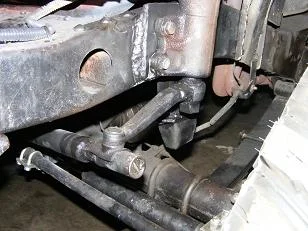

In my picture, that is a modified 40 pitman cut, flipped, and rewelded. It worked great. Now that I am SOA with 60 series axles, I am using a 60 series pitman.
Didn't you use a J7 relay rod (from the pitman arm to the right side tie rod)?
Dan
I did. J7 drag link end, J7 drag link, FJ40 driver's side TRE at the other end of the drag link. The only thing that needs to be overcome is the fact the the FJ40 driver's side TRE has a shorter stud length than the original drag link end that is intended to fit in the tie rod.
