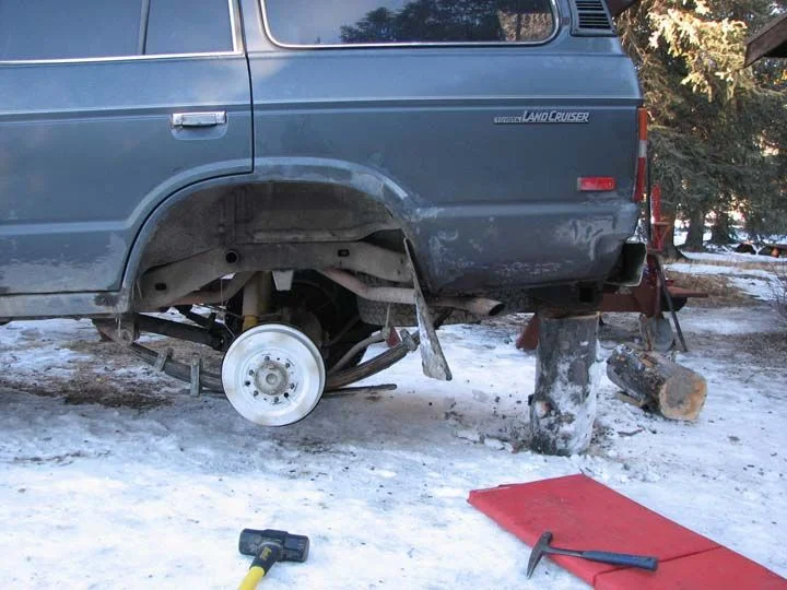

Out at River Shiver this past weekend, the 10 month old Dakar spring on my rear driverside failed at the shackle end. It was the first run of the weekend, and the failure had absolutely no coolness factor. No catching air, no drop off a rock ledge, no nothing, just riding a light trail. Didn't even realize that anything was wrong till I got out to see what was making a metallic clunk at the back of the rig (kind of like the OME pop on steroids).
So, I limped the truck back to camp, and left it to deal with in the daylight. Fortunately Lowenbrau was there, and just happened to have a pair of main and secondary leaves from a stock 60 springpack in his trailer (even though he was driving a 74 :hhmm:). I am happy to say that they work into the OME springpack reasonably well, and I was able to get back out on the trail with a bastardized suspension!:bounce: For those of you replacing your springs, this might be a good reason to hang on to your old springs if they are in good shape, and you have the space.
Anyway, I sent an e-mail off to ARB USA on Tuesday night, and it looks like they will be sending out a replacement leaf tomorrow (thanks Marc:cheers:) They've been great and getting this worked out was no hassle at all.
Looking forward to getting the proper leaf back in, as my truck leans into right turns a bit soft right now (although it does sit pretty close to level).
So all in all, three cheers are in order for Lowenbrau for saving my weekend by having some random (but perfect) scrap in his M101, and lending me some of the tools I didn't have with me :cheers:, and three cheers are in order for ARB for standing by their product and replacing something defective quickly and with no hassle :cheers:
One more pic, back out after the fix.

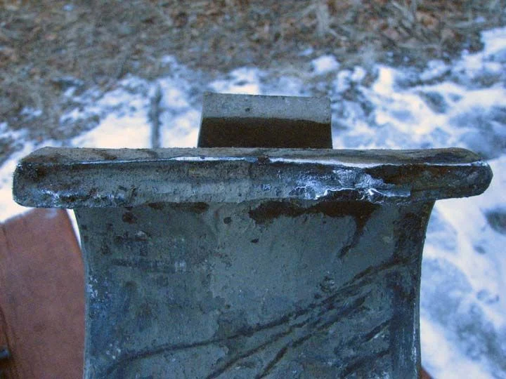

maybe a good idea to throw a weld or 2 on that hanger as well it looks a little torn up.
Yup, the springs are definitely harder than the steel of the hanger. The hanger got chewed up good, and the broken end of the spring hardly even smoothed over.

Thanks for checking, sounds like the stock length isn't far off, and I think I'll stick with them. I still think it was just a defect in that leaf, they really haven't been flogged, and certainly not on the day of the failure.
The photo below was taken the morning after the break, after I got the leaf out. I'm no metallurgist, but it doesn't look like a very fresh surface to me, I suspect it was brewing for a while. Most of the shined up stuff is where the break was riding against the shackle mount.
