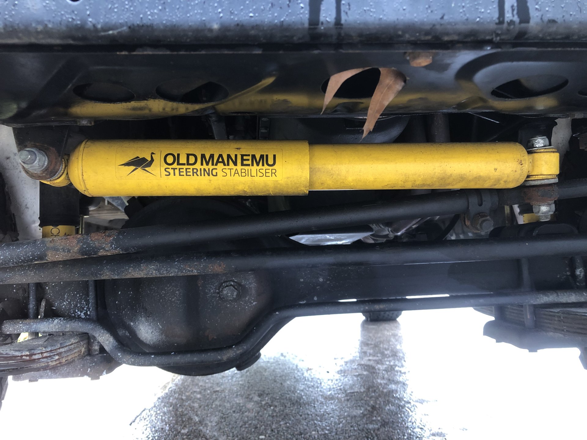

Here is mine installed. You may have the wrong unit or maybe you’re missing hardware? This is an 87 fj60 fwiw. Should be the same as the 62.
Here is mine installed. You may have the wrong unit or maybe you’re missing hardware? This is an 87 fj60 fwiw. Should be the same as the 62.View attachment 2918410View attachment 2918423

Any chance you have the pin in backwards somehow? Maybe spin it around where the tapered bit in your photo goes towards the damper bushing and not the TRE side like you have in your photo. I don't recall there being a tapered hole like that on the TRE side. If you look at @cps432's photo, the pin body should sit flat against the TRE. The tapered bit you have with the way that pin is arranged wouldn't allow that. Its been years since I did this on mine so I don't now recall the specifics, but it was literally the simplest thing I have done on my cruiser to date.

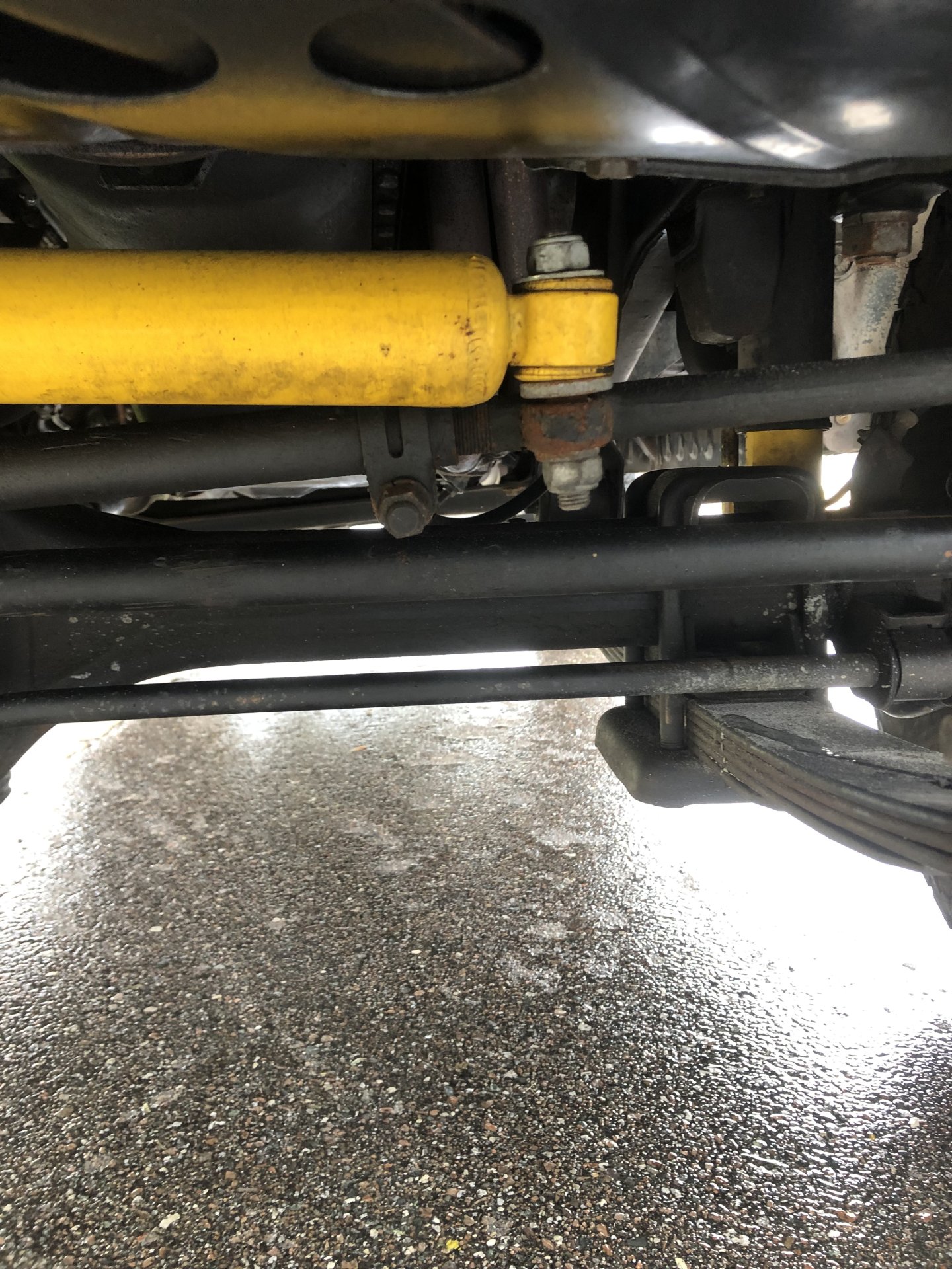

Sorry to hijack this a bit. Hoping for some insight.
I recently replaced all my FJ62 steering linkage with a kit from @cruiseroutfit, at the same time I finally installed my OME steering stabilizer that I've had in the box for two years from @cruiseroutfit
I noticed that the drag link interferes with the stabilizer if the passenger wheel is raised. It hits on the body of the shock and the back nut. Did I somehow mess this up?
With the wheels flat on the ground:
With the passenger wheel side jacked up about 6":
The driver side is also hitting the frame:
Detail of gap in the frame side pin. This is with the nut torqued down hard.
