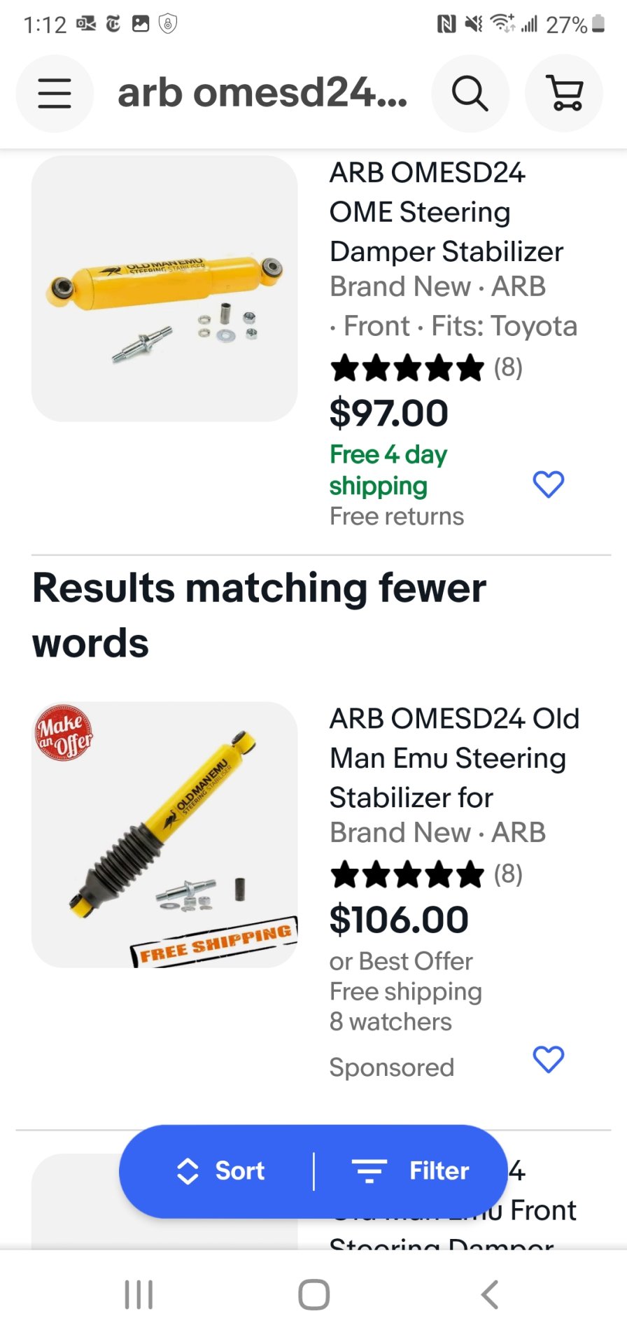

Stock photos show there are 2 different ones with the same part number

I just got my OMESD23 for my '82 FJ60 and it is about 3 inches too short. The photo shows the OME at full extension next to the stock stabilizer at the length it came out with wheels straight ahead.
I ordered from Summit.
I'm guessing the wrong part was in box, as the box is labeled correctly. It came with all the hardware, but there was no OME branding or lettering on it. Just yellow body.
SD23 is the 40/55 variant. Much shorter than the 6x variant.
Buy Cruiser parts from Cruiser shops :D
You need the SD24
Fwiw, OME dampers are marked, you can see it in your pic here:
You need the SD24
Thank you, lesson learned! Summit's website shows this for the 6x for my model year. Going to return it and order from Cruiser Outfitters.
