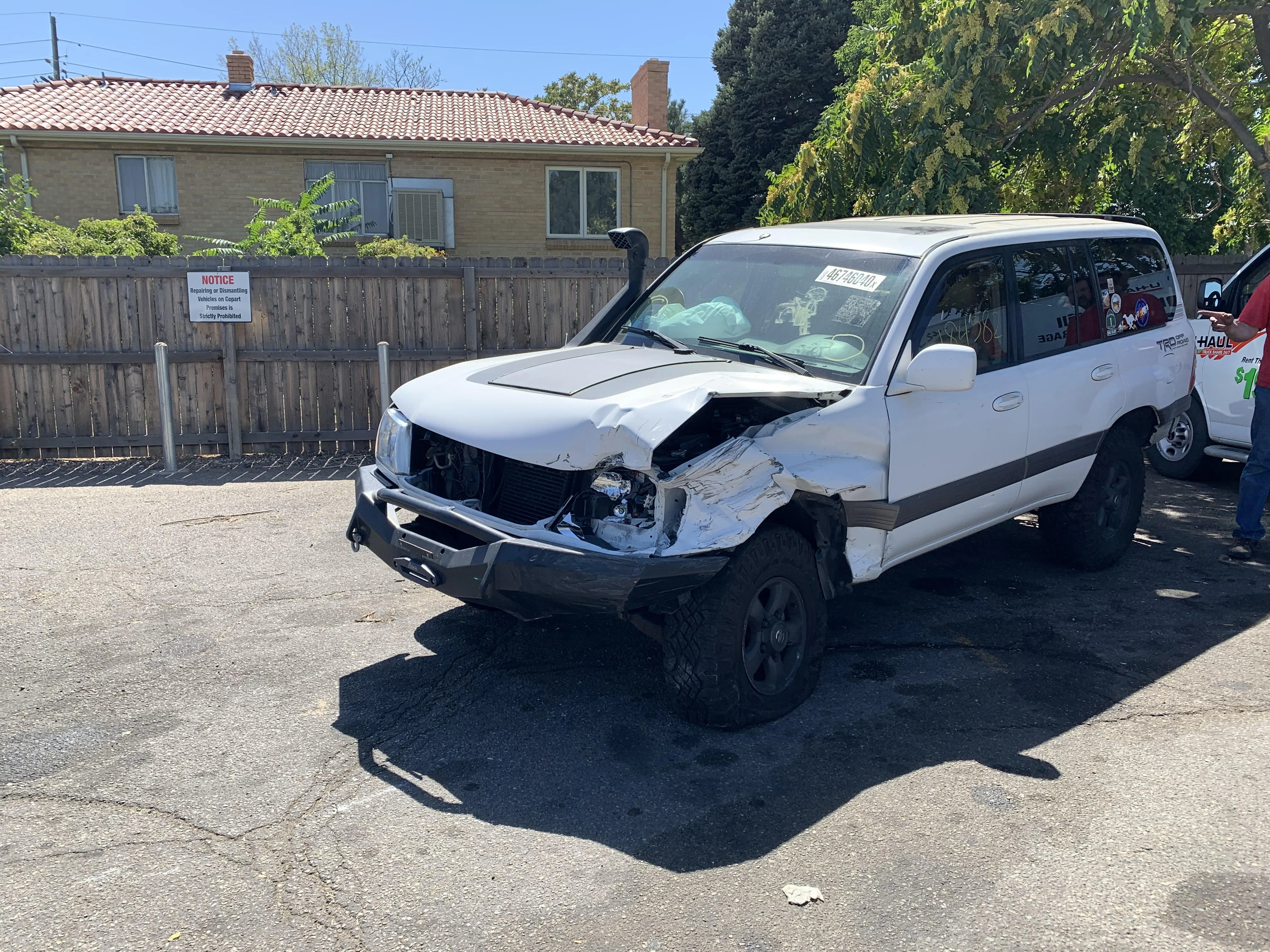

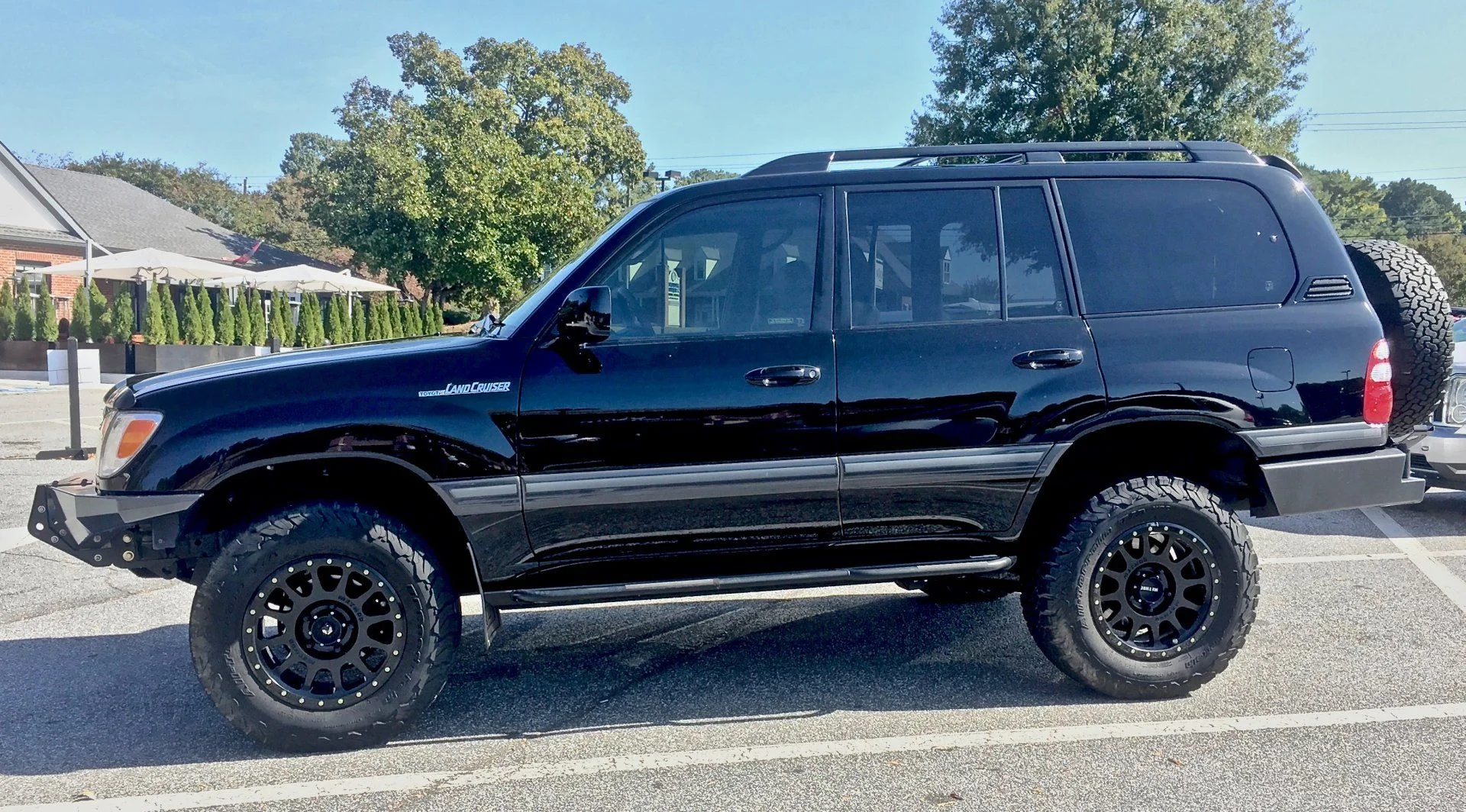

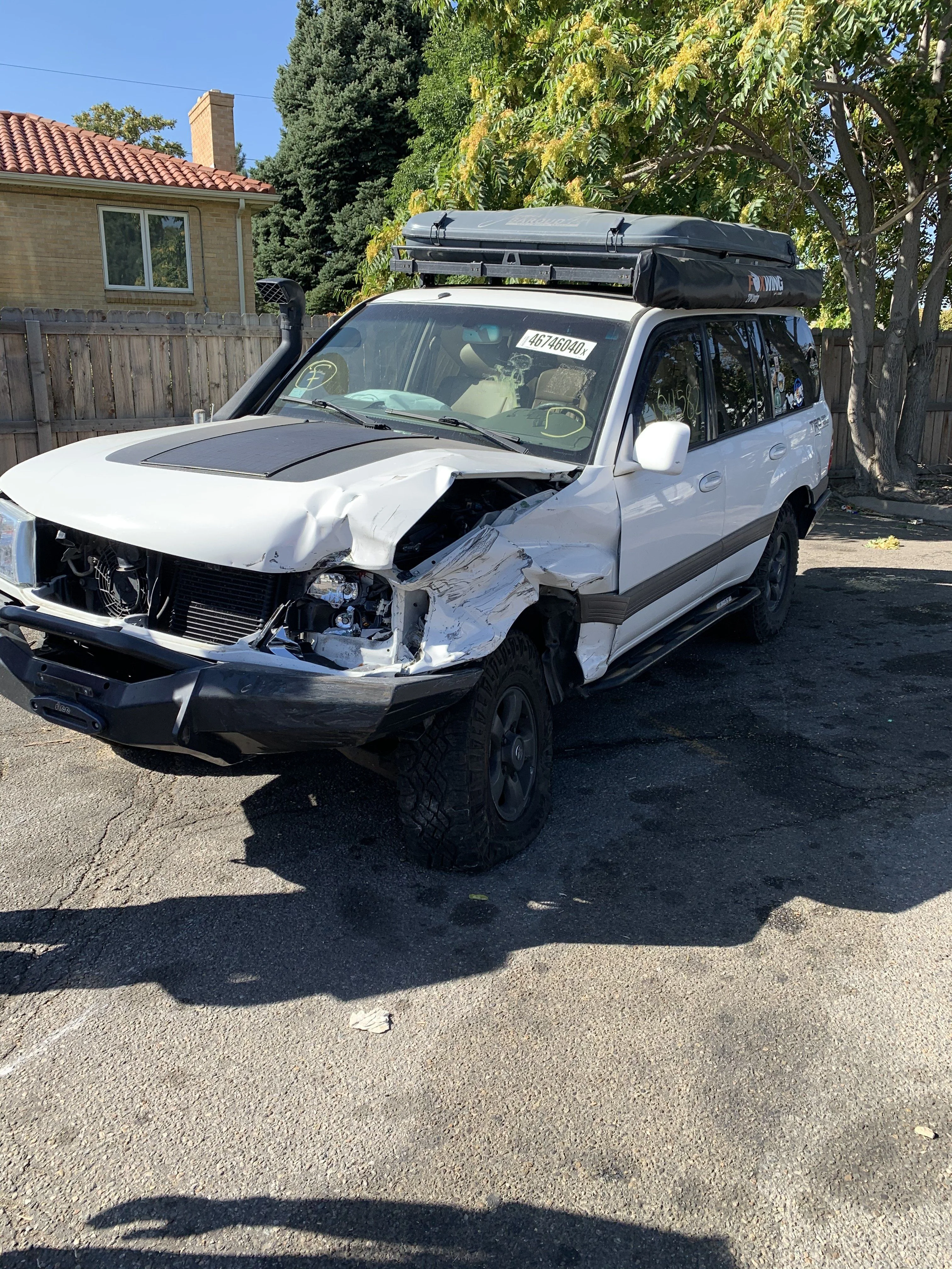

Throwing this out there..... not scientific at all, but just some pictures since my Cruiser is now dead. RIP
I had the 2864 springs on my fully loaded 100. Had sliders, front Slee bumper, rear Slee bumper, drawers, 2nd battery, Foxwing awning, roof rack, and RTT. Riding on 285/75/16 Duratracs.
Here is a picture of how it sat.
full
When my Cruiser got wrecked we pulled off: Roof rack, awning, RTT, sliders, rear bumper, and drawers.
Pics before and after we pulled everything.
full
full
